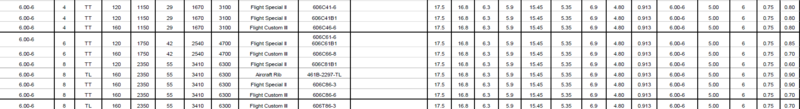

APenNameAndThatA Posted July 11, 2017 Posted July 11, 2017 Hi, I can't find any information about this anywhere. I am wondering what tyre pressure is best for operating on rough, sandy airstrips. For example, ones with some rocks rough ground and dirt, please. This relates to how much difference it makes if you have 8.00-6 tyres or 6.00-6 tyres. I am thinking of the A22LS Foxbat tricycle gear LSA, which has a MTOW of 600 kg. Those are the two tyre sizes. An A32 Vixen would become experimental if you added 8.00-8 tundra tyres. The Foxbat can do a lot to avoid using its nose wheel. It even has a tail wheel incase people over rotate. I am posting here because some of the same questions will arise about other airplanes. The Goodyear Databook_7_2016.pdf is where I am getting my info. It says that the C206 main gear can be 6.00-6 or 8.00-8 and that the main gear is 5.00-5. The nose gear of a C441 is 6.00-6! My thinking is that there are two main reasons to fit bigger tyres: a) larger rolling circumference, giving a smoother ride over rocks, and b) the opportunity to have a larger footprint/less PSI on soft ground. Also, possibly the bigger tyre will be able to cushion a larger bump better, and give slightly slightly better prop clearance. Based on my four wheel driving experience, 16 PSI is fine for soft sand, and usually allows a 4WD to move from standstill, applying drive force via the tyres. In a 4WD, if you have a (tubeless) tyre part company from a rim it is a nuisance, in an airplane it would be worse than that. The Goodyear 8.00-8 has a shoulder diameter of 17.04 inches and a shoulder width of 6.75 inches. The Goodyear 6.00-6 has a shoulder diameter of 15.45 inches and a shoulder width of 5.35 inches. Calculating with just the main gear, at maximum LSA weight, you have 300 kg per wheel, or 660 lb. 660 / 16 = 41.25 square inches for 600 kg at 16 PSI. 41.25 / 6.75 = 6.11. So, the contact patch on a 8 tyre, would be 6 inches long. 41.25 / 5.35 = 7.71. So, the contact patch on a 6 tyre would be 8 inches long. I think I can remember that... 1

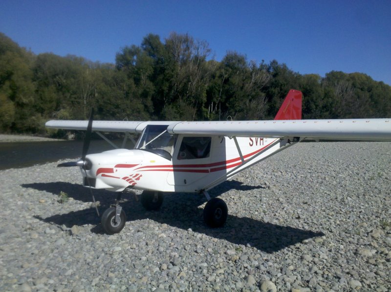

fallowdeer Posted July 12, 2017 Posted July 12, 2017 Aero Classic 21/800 on the mains and 600x6 Condor nosewheel. Run the mains at minimum pressure that they don't rotate on the rims. 3

APenNameAndThatA Posted July 12, 2017 Author Posted July 12, 2017 [ATTACH=full]51129[/ATTACH] Aero Classic 21/800 on the mains and 600x6 Condor nosewheel. Run the mains at minimum pressure that they don't rotate on the rims. Wow, Fallowdeer, that Savannah VG has a MTOW of ? about 550 kg. You were almost certainly lighter in the picture. The tyres have not deflected much at all.
Downunder Posted July 12, 2017 Posted July 12, 2017 Wow, Fallowdeer, that Savannah VG has a MTOW of ? about 550 kg. You were almost certainly lighter in the picture. The tyres have not deflected much at all. Without anyone in it and an unknown quantity of fuel, it would be 300 and something kilo's sitting there probably. As "force= pressure x area" you probably don't need the psi (pressure) in larger diameter tyres to some degree due to the larger internal tyre area. And as air is compressable, you get the spongy cushion on landing.
fallowdeer Posted July 12, 2017 Posted July 12, 2017 Hi John M Close, in the Ruamahanga near Papawai. Yep, 305kg plus another 30kg of fuel plus me equals about 420kg. Peter
