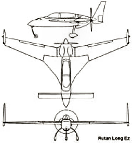

bexrbetter Posted July 13, 2017 Author Posted July 13, 2017 If you want a flying wing style, why not go the full flying wing a la Northrop N9M? Too hard to design and build, get flying right, CoG problems (although actually better as electric because no fuel weight change) and too radical looking even for radical people. I prefer a flying wing with "assist" for pitch control such as many canards are. Hmm actually with half the CoG problems gone with electric setup having a stable fuel load at all times, maybe a pusher Long EZ type craft could fit the bill .... 1
