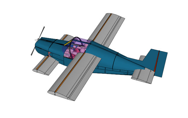

kasper Posted July 13, 2017 Posted July 13, 2017 [MAP][/MAP] Quote Well the biplane would be nice and would appeal to more people but an extra set of wings adds extra fairings ect whereas a flying wing style is a more practical for your purpose.Personally I think the stats would sell it even if it is 'unconventional' after all what is not to like about a few hours of electric flight. Just an extra silly idea that I was pondering, how hard would it be to have external hard points for a little internal combustion generator unit thingy. Obviously would need aerodynamic encasing but would have a small engine/generator with its own built in fuel tank, it could be run in flight or at remote strips that didn't have power supply. Yes it would be extra weight but it seems to me that this aircraft is already outside a 600kg limit so an extra 50kgs or so may give people an extra option and if it was a simple attach point it could easily be attached or removed as needed. If you have an electric aircraft then why not go for range extenders like aluminium catalysing direct electric ? Product But as he has already said optimised battery systems are not his core issue. My interest would be for flying wing. I know lots of people balk at the design challenges but with a fixed mass airframe regardless of energy state your main operational constraints are reduced. And pendulum stability can minimise some off point design load situations. And with the battery mass you can usefully use the battery mass

rgmwa Posted July 13, 2017 Posted July 13, 2017 Bex, surely you should simply pick the best tool for the job. If a lifting body works best for this technology then use that. What may come across as an unusual shape now may well be seen as mainstream for electric aircraft down the track. Something that looks like a space shuttle might even attract potential buyers of this technology. It's performance and utility that matters far more than shape in my view. rgmwa PS. It may also help keep you out of jail in 6 years time if you come up with something that doesn't look like a Cessna. 1 1
aro Posted July 13, 2017 Posted July 13, 2017 Induced drag is the cost of staying in the air, and induced drag is directly related to wingspan. A lifting body is high induced drag, so will always be at a disadvantage to longer span conventional designs when it comes to endurance. 2

bexrbetter Posted July 14, 2017 Author Posted July 14, 2017 Quote Induced drag is the cost of staying in the air, and induced drag is directly related to wingspan.A lifting body is high induced drag, so will always be at a disadvantage to longer span conventional designs when it comes to endurance. Does it trouble you that you are flying a far less than aerodynamically optimal high-wing with square edged fuse, flat floor, flat sides, flat screen plane with wing struts sticking out in the breeze everywhere creating high drag? How do you sleep at night, won't anybody think of the baby seals! And now for some actual facts from a hands on genuine expert in the field, please read page 19 onwards ... http://www.wainfan.com/pavreport.pdf 2

bexrbetter Posted July 14, 2017 Author Posted July 14, 2017 Quote I love that Griffon Lionheart. Mmm, yes, the more feeling I get from people about anything unusual, not real good, the more I am inclined to stick with something they find more acceptable, and I am geared up for "conventional" currently, as well as my current structure foundation makes a bi-wing or tandem wing craft convenient. I had previously been playing with tandem wings, but felt lack of acceptance first time out probably not a good idea. 1 1
