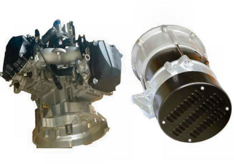

Mike Borgelt Posted September 6, 2017 Posted September 6, 2017 "All electric" aircraft are a complete crock. Hybrid maybe, but that involves some kind of hydrocarbon fuelled engine and an alternator plus at least one electric motor. Hybrid as VTOL makes more sense. Electric for vertical flight, less than one minute for takeoff and transition to wing borne flight, maybe two for landing and IC motor for cruise. Much less battery required. Airports can then be much smaller. The aircraft too as the wings are sized for cruise not for low stall speed and takeoff and landing. The landing gear is lighter too as it touches down vertically, gently, under automatic control. The guidance system for vertical mode (and cruise) would fit in a two inch cube for a quad redundant system. Batteries, motors and controllers to do this already exist. One electric motor/prop out case can be handled. As the electric motors are used only in vertical flight they are optimised for essentially static thrust only, hence fixed pitch. This thing wouldn't even be all that expensive. To avoid certification issues build as homebuilt kit. I cannot even think why anyone would build a certified aircraft of any kind unless they have the resources of Boeing or Airbus. 1 1

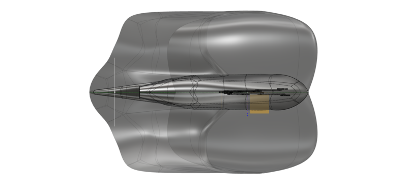

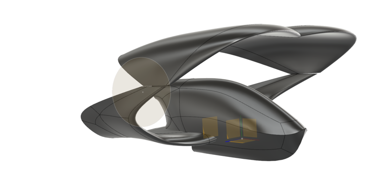

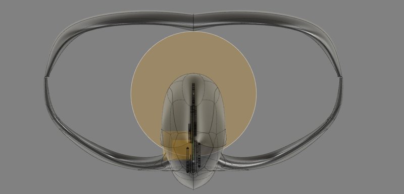

Guest drewrt Posted January 15, 2018 Posted January 15, 2018 I think that new planforms will eventually dominate the market. Irrational emotional attachment to the cruciform layout is what's held the industry where it's at, but the next generations are much more openminded. The cruciform layout makes sense for a bird, who's wing motion is their drive system, however localized air movement driven planes can make use of the induced flow to enhance lift. This was proven by the Custer Channel wing, and the technology was successfully stolen by Fairchild, in the design of the A-10 Warthog. Further, as the flying flapjack proved, very low aspect ratio wings, with 0 tip losses are possible, by using your air movers to counteract vortex induced tip losses. I've got some idea's around this. I think the facet plane is very inspiring, however what I think is that the drive for efficient flight pushes us toward larger propellors. In conventional layouts, prop swing is limited by landing gear height. This was the failure of the flying flapjack, enormous gear. In my joined wing design, I'm looking at having the whole upper wing pivot (not shown in the concept model here). These are just very raw concept models, I've done dozens to a hundred or so, looking for an optimal layout of upper and lower wing, control surfaces, etc. I'm hoping to start RC modelling some of my more promising models soon.
Old Koreelah Posted January 15, 2018 Posted January 15, 2018 I think that new planforms will eventually dominate the market. Irrational emotional attachment to the cruciform layout is what's held the industry where it's at, but the next generations are much more openminded... What a breath of fresh air, Drewrt! Us old flying farts are soooo conservative... New, super-strong materials and computerised control systems should make such revolutionary aircraft viable. I love your concept drawing, but I fear your design is too traditional... Who says pilots must sit upright? Why not prone like the Wrights, or even reclining like a Roman senator? ... the Custer Channel wing, and the technology was successfully stolen by Fairchild, in the design of the A-10 Warthog... My next aeroplane is likely to incorporate the Channel Wing concept, but I can't see it in the A10. Tell us more. 1

Guest drewrt Posted January 27, 2018 Posted January 27, 2018 What a breath of fresh air, Drewrt! Us old flying farts are soooo conservative...New, super-strong materials and computerised control systems should make such revolutionary aircraft viable. I love your concept drawing, but I fear your design is too traditional... Who says pilots must sit upright? Why not prone like the Wrights, or even reclining like a Roman senator? My next aeroplane is likely to incorporate the Channel Wing concept, but I can't see it in the A10. Tell us more. Custer sued the builder of A10 for this. Custers thesis was that lift was proportional to speed of flow over wing, having as a child been in a building whose roof lifted off and flew away largely intact, he recognized that inducing flow could also create lift. He took that to the next step, by wrapping the wing around the prop, creating a semi duct. In the A10, known amoung pilots for it's ability to "hang", the intakes are positioned so as to induce flow (by suction, same as Custer). His suit failed as I don't think he found any evidence that it was the intent of the designers to copy him, may have just been a happy accident.
