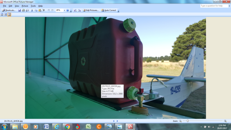

matt walsh Posted July 28, 2017 Posted July 28, 2017 Hi SD, I'm interested in your fuel transfer arrangement ie using an electric 12v pump mounted in your plane. I fly a Savannah which has high wings. I've contemplated various arrangements to replace standing on steps/ladder/chair filling wing tanks from 20l plastic containers. I could use 10 litre containers but these are normally not vented (other than through the spout) so slowish to discharge. I tried a rotary hand pump (Alco a brand approved for gasoline) and just OK and a bit cumbersome. I would like the easy of a electric pump so would appreciate your setup advice, thanks and cheers Matt Walsh, Penfield Victoria.
skippydiesel Posted July 28, 2017 Author Posted July 28, 2017 Hi SD, I'm interested in your fuel transfer arrangement ie using an electric 12v pump mounted in your plane. I fly a Savannah which has high wings. I've contemplated various arrangements to replace standing on steps/ladder/chair filling wing tanks from 20l plastic containers. I could use 10 litre containers but these are normally not vented (other than through the spout) so slowish to discharge. I tried a rotary hand pump (Alco a brand approved for gasoline) and just OK and a bit cumbersome.I would like the easy of a electric pump so would appreciate your setup advice, thanks and cheers Matt Walsh, Penfield Victoria. Hi Matt - This is going to be a very round about answer as I feel it is important that you have as much information as I can supply (others may have more) before you commit to an electric petrol transfer pump. I am sure you have already found out that quality petrol (note that I specified petrol) transfer pumps are very expensive and there is little choice out there. Diesel, kerosene transfer pumps are relatively common and can be purchased quite cheaply. The question(s) you have to ask is why? I can only speculate as to the answers: Petrol has a lower flash point than diesel/kero fuels. Electric motors are a good source of sparks Electric motors used to transfer low flash point fuels must be suitably shielded to prevent ignition/fire. High flash point fuels/liquids do not require the same degree of protection. Petrol is a "dry" fluid, compared with diesel/kero so special seals are required for petrol transfer pumps. Petrol tends to be more damaging to rubber & plastic type materials than diesel/kero so again special materials are required. So petrol transfer pumps are built to a higher standard and are consequently much more expensive. Now I figured that certain automotive sports must use quite high volume electric petrol transfer/boost pumps. 12 volt vane pumps are produced for the dragsters and other high powered petrol driven sports. These pumps do not deliver the volume of a dedicated petrol transfer pumps but are available at a fraction of the price of a proper pump. The best pumps are made by Uncle Sam but his close relative Grandpa Chin makes "knock off" copies . The copies are unlikely to deliver their claimed output but at about $60-100 who's complaining. You will find these pumps in variose sites on the internet. You will have to do your own plumbing & wiring. A vane pump should be self priming but its not a bad idea to install a small foot/non return valve. In case of hose or pump shedding, always use a filter funnel or similar. In my case I have added a ground wire & clip in an attempt to increase the safety magine and only fuel in a well vented area

matt walsh Posted July 29, 2017 Posted July 29, 2017 SkippyDiesel, thanks for an excellent advice and I agree with your comments. Re your comment "I use the hose to transfer fuel from "jerry" cans via an 12V electric pump into my aircraft" and that your aircraft (Atec Zephyr) has low wings, I assume lift height capability isn't an issue with your pump choice. Can you detail me your set up and pump type please, perhaps it will work for me. OneTrack, again excellent comments highlighting safety issues. My aim was to eliminate the lifting of containers onto overhead wing for refuelling my Savanah hence the pumping/ground transfer approach. I am happy to stand on safe/stable/earthed device and hold and direct the discharge hose, fitted with a cut off valve, into the tank thus addressing the possible overflow/spill issue. I checked the website included in your post and like most sites, the 12V DC pumps advertised are all for Diesel fuel only and not petrol. I could use 10 litre containers but haven't sourced any that discharge quickly. Most have only one orifice and incorporate a breather into the spout. Weightwise its ok but when filling 100+ litres that's 10 containers worth and 10 ladder movements. Courtesy of my plane's former owner, I have fashioned a set up for a 20 litre container to sit and discharge into the wing tank. Very simple set up and not fast filling but I can easily monitor and cease filling to avoid overflow. Its an improvement over holding and pouring a 20 litre container. And NO I do not refuel in the hanger, this was an image taken during construction!!! The other option maybe the Tanami brand compressed air system, see below. I'm unaware of its performance and would require changing to metal jerry containers. A 12V DC air pump for air supply could be positioned well away from fuelling operations.The Tanami devices cost about $80 from 4 WD accessory outlets ie ARRB. My thought was a fuel pump on ground, inlet hose into container, outlet hose to tank filler. I perused 12V fuel pumps and Facet brand appears suitable and is solid state. BUT only 12 inch dry lift so probably wont transfer enough ( I assume flow decreases as lift height increases??). To reduce lift height , I could position the container on a stand and pump from their. So any thoughts Team Rec Flyers? Thanks and appreciate the comments thus far, Matt Walsh 1

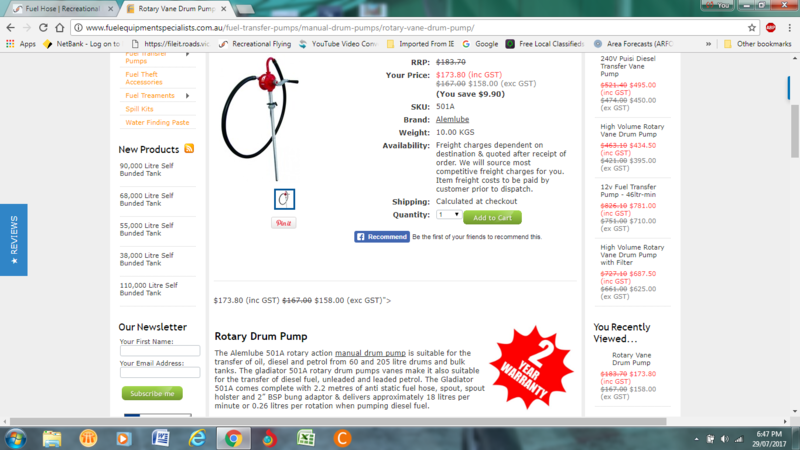

SSCBD Posted July 29, 2017 Posted July 29, 2017 Why aren't people using hand rotary fuel pumps for high wing aircraft? weight is about 2.5 kg keep it in back of aircraft. 1
matt walsh Posted July 29, 2017 Posted July 29, 2017 HI SSCBD, fair comment but my experience has been thats its awkward based on a set up of: container or ground or platform near height to wing tank rotary pump inserted into container and may not have a firm fit ie it just "sits" in the container filler hole. hose then is inerted into wing filler hole or into Mr Funnel and held some how ie with your hand, other hand then has to rotate pump handle have to lean over tank hole to watch for overfilling/ spillage. So yes a rotary hand pump is simple and electricity free, but requires coordination and fine movements!! Also the quality rotary pumps capable of transferring petrol, and not only diesel or kero, such as those from Alemlube, tend to be heavish and with thick hoses thus making it more cumbersome. AQlso not sure about the 2kg weight as quoted mass below is 10kg although this includes the drum tubes which you could delete and get fittings to reduce to a hose fitting. BUT I have just found another option from Alemlube, a very reputable and major company, on their website as below. I'll get a price this seems a worthwhile option. Quoted delivery rates up to 20 litres per min should be ok and definitely states device is suitable for petrol. This could be a winner!! Chemical Syphon Drum Pump w w w . a l e m l u b e . c o m . a u w w w . a l e m l u b e . c o . n z The Alemlube 230 chemical syphon drum pump operates with a simple manual up and down piston type action. Capable of delivering up to 20 litres per minute, the 230 is suitable for the transfer of petrol, diesel fuel, kerosene, thinners, toluene, nitric acid 35%, hydrochloric acid 35%, sulphuric acid 35%, acetic acid 35%, other mild chemicals and is also suitable for use with water. Manufactured from high and low density polyethylene with the pick up tube measuring 850mm in length, the 230 syphon drum pump is non-corrosive, non-toxic and extremely light weight at approximately 430g. The flexible delivery hose is 1.2 metres in length and an adjustment knob on the top of the pump can be used to stop the syphoning process. PRODUCT SPECIFICATIONS, FEATURES AND BENEFITS Manual piston type pumping action Delivery rates of up to 20 L/min Suction pick up tube length of 850mm 2” drum bung adaptor Flexible delivery hose length of 1.2m Non corrosive, non toxic polyethylene construction Extremely light weight at 730g Suitable liquids: petrol, diesel fuel, kersone, thinners, nitric acid, toluene, hydrochloric acid, sulphric acid acetic acid and water CAUTION Not to be used with any liquids over 35ºC Not to be used for high viscosity industril liquids (eg. lubricant, heavy oil) Not to be used with concentrated acid or corrosive liquids Keep the pump out of direct sunlight ORDERING INFORMATION 230 Chemical Syphon Drum Pump PRODUCT INFORMATION October 2015 NS 1
SSCBD Posted July 29, 2017 Posted July 29, 2017 HI SSCBD, fair comment but my experience has been thats its awkward based on a set up of: container or ground or platform near height to wing tank rotary pump inserted into container and may not have a firm fit ie it just "sits" in the container filler hole. hose then is inerted into wing filler hole or into Mr Funnel and held some how ie with your hand, other hand then has to rotate pump handle have to lean over tank hole to watch for overfilling/ spillage. So yes a rotary hand pump is simple and electricity free, but requires coordination and fine movements!! Matt, after 30 years of filling high wing aircraft in the bush you get a bit smart on doing things. Not being rude but lifting 20 litre drum up on a high wing where you need a ladder or box etc. it not pleasant or feasible either on remote strips or away trips. I have watched people fall over, hurt their backs trying to lift 20 litres or dropping drums and spilling fuel or the drum slides down the back and off the wing spilling fuel everywhere 1. So I have a rotary pump that pushes a half litre of fuel per 360 degree rotation. It weight 2.5 ish to 3 kg, never put it in a scale but around that weight, by the non scientific method of using the 3 litre milk hand weight comparison. 2. I have cut to length the excess filler tube and put a "SMALL METAL S HOOK" through the end of the hose that is then inserted into the wing filler hole and hooks INTO internal lip, so the hose it wont fall out and its fit and forget while refueling. 3. I have cut the bottom end tube off and slipped a (petrol proof) rubber tube to fit 20 litre drum in length. This takes the excess metal tube bulk and weight out of the pump also. 4. I have two free hands now just to hold the pump in the drum and wind away. - so easy. 5. As I know how much fuel I need after dipping the tanks BEFORE fueling I know how much I need and can count the turns if needed - so no overflow or spillage. Mark - Don't take this a being rude, - but it works so well and is so simple why would I change the system. The little - S- hook on the filler end of the hose is the true answer to holding the tube filling over wing aircraft HANDS FREE and wont fall out. 1

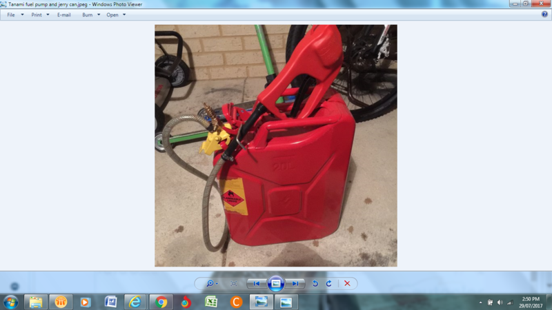

WayneL Posted July 29, 2017 Posted July 29, 2017 I use a Tanami "pump" with a cheap $20 electric air compressor. You can get the Tanami to suit the plastic 20 litre containers as well as the metal. I fitted a gas ball valve in the filler hose from the Tanami pump. Wayne

matt walsh Posted July 29, 2017 Posted July 29, 2017 Dear Onetrack,SSCBD and Wayne, Thanks for your respective inputs and suggestions. I like each system and reckon each will have their relative attractions and suppoprters OneTrack, I wont argue with 30+ years in the scrub and will have a crack at setting my rotary pump up like yours, like the hook on discharge pipe. I assume you filter the fuel that goes into the container you insert pump to?? ie decant from one container into final container through a Mr Funnel?? SSCBD, But I am attracted to this simple compact 12vDC pump set up. Do you have any experience in these or knowledge of pilots using them?? Wayne, I am aware that Tanami has model for fitting plastic containers, Do you get a OK seal onto the container?? Also do you let the 12v air compressor (ie a small car type one??) just run and it turns off when enough pressure or do you have to frequently pressurizer the container?? Thanks heaps for your collective wisdom comments and suggestions. I really appreciate this input and your time in sharing, Cheers Matt

WayneL Posted July 29, 2017 Posted July 29, 2017 I plug my air compressor into a 12v socket on my aircraft and leave it running while filling the top tank using the stop cock to control the fuel flow. Never really have the stop cock turned off and the compressor on long enough for the over pressure valve on the Tanami to blow off. I use the metal containers, don't have any sealing issues and don't think the plastic ones would either. My top tank is only 15 litres and takes about 2 minutes to fill. Before this system I was using 3 X 5 litre containers into the funnel, always seemed to spill some, now I don't spill any, very controllable. Wayne
