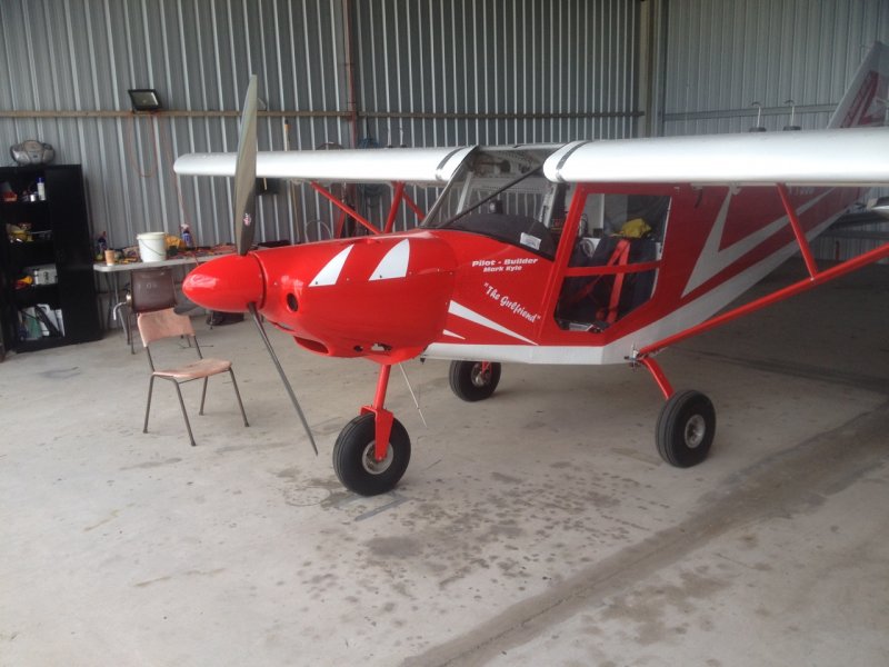

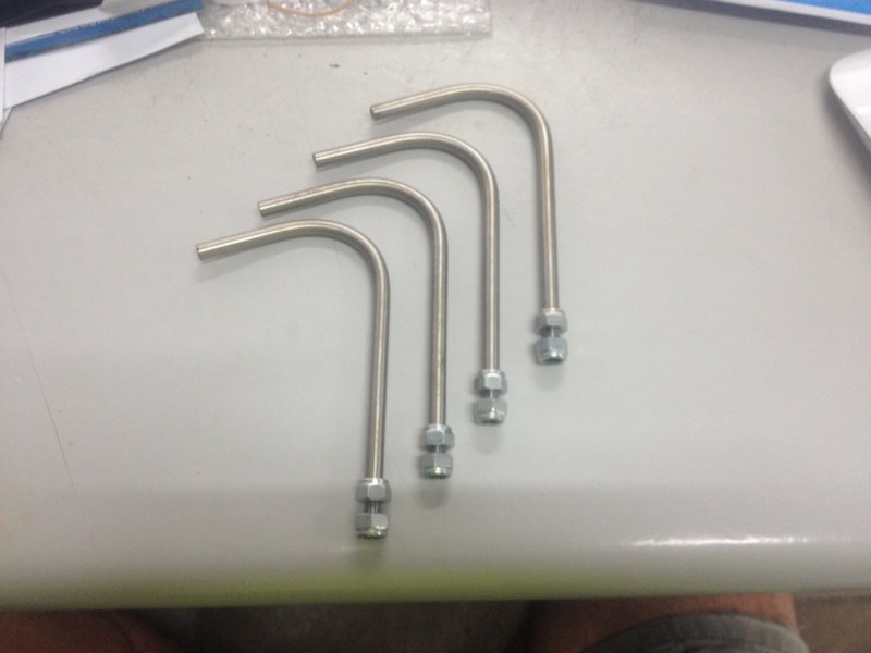

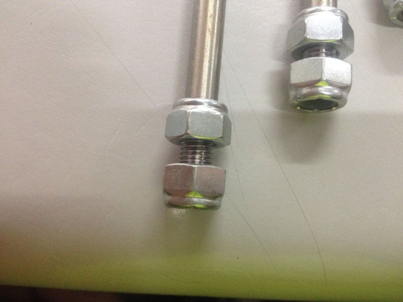

Kyle Communications Posted August 4, 2017 Posted August 4, 2017 Hi Matt yes Roger is a good friend of mine and his hangar is 2 doors up from mine. I know your aircraft very well. Roger has just come back from Oshkosh as well. The fuel issue was caused by what you have now. The plastic tube that comes out from the top of the fuel cap and goes through the wing and is cut so the airflow goes into that small tube. A insect got into one of the tubes and caused a vacuum on that tank causing it not to drain so I had a full tank but couldnt use it. I noticed it reasonably early as I can control all 4 tanks on my plane individually so was able to make the right decisions. I landed at Watts Bridge and blew out the tube and voila the tank was usable again. So flew the rest of the way back to Ycab. A lot of Sav guys have made the mod I did. You get rid of the small tube and the fitting in the top of the cap. I then got thin stainless tube 6mm bent them to the shape in a tube bender and threaded the outside and got 2 nylock nuts and fitted them like in the pictures attached. Just drilled out the holes in the tank caps. never had even any issue at all since. The last pic you can see them on the wing. That was after repainting my cowl. My sump system is a little different as well. The 2 inputs at the top I have one and it takes all the fuel from my 4 way fuel manifold that I control all tanks from individually the other inlet at the top goes direct up to the top of my right hand inner tank where I have the sight gauge so I can never get a vapour lock there which is also others have a few issues with. I did this when I first built her though as I knew it was a problem with the std system ICP used The S that I am rebuilding at the moment I will do the same to.

matt walsh Posted August 8, 2017 Author Posted August 8, 2017 Hi Mark, What a small world with you being close and knowing Roger. Your member address says Burpengary so I didn't realize you were at Caboolture with Roger. I've read your informative and helpful posts over the years and have ended up a Savvy owner and a plane that you observed regular. Say Hi to Roger when you see him next and that Savvy is performing well and much loved. Thanks for the photos of the fuel vent modification. After my blockage episode, I have been fitting my fuel cap breathers to prevent any unwanted critters entry when plane is stationary. The caps are only removed right before take off. The caps are clear plastic tube with a in line motorcycle fuel filter so the tank can breath but nothing passing the filter.

Kyle Communications Posted August 9, 2017 Posted August 9, 2017 Hi Matt On mine you roll up wire gauze or insect screen mesh and just push it into the tubes..this stops the bugs getting in when stored in the hangar or when flying but lets the airflow in. Yes I will tell Roger when I see him next. Would have been friday but off to Goondiwindi this weekend to see some model RC jets flying. They are taking over the airport for 3 days for a RC jet flyin so I am going to catchup with some mates who still fly them and I am driving another out who has flown up from Adelaide for the weekend and a guy from Victoria has bought his model in his trailer for him. It will be a big weekend..lots of jets :).. so will see Roger the following weekend
