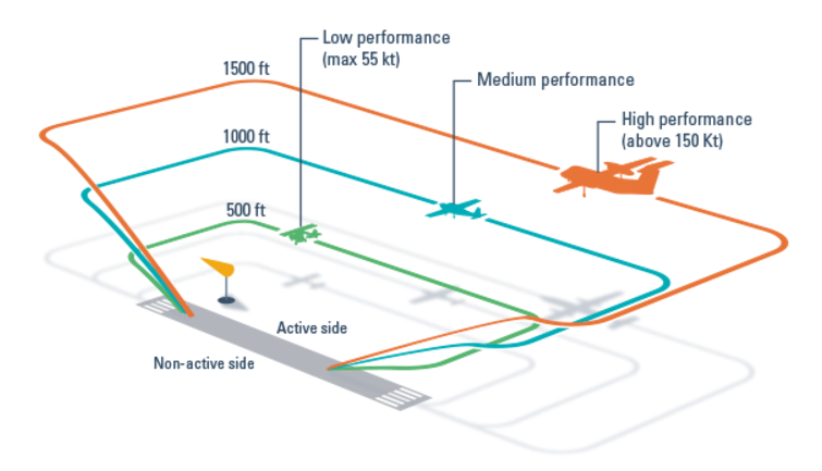

M61A1 Posted August 20, 2017 Posted August 20, 2017 Well if you were hanging your aircraft on the prop in front of a faster aircraft, I'd recommend some more training.You shouldn't be in that situation anyway: [ATTACH=full]51647[/ATTACH] It's exactly what YOU suggested though....I'm suggesting that it's not a good idea.

facthunter Posted August 20, 2017 Posted August 20, 2017 Funny how in that Diagram/ schematic showing the 3 height possibilities they show the final approach angles wrong for what it would be in reality. The 500 ft Circuit type of aircraft would most likely have the steepest final approach and the 1500" feeder turboprop or jets would have 3 degrees. 10 NM 3,000 feet AGL profile, and the "normal" GA types quite a variation in between. These large circuits really should be looked into. You could be forgiven for thinking they are departing the circuit . There's hardly a situation I can think of where it would be necessary to make them so big..Extending your downwind leg is the most effective way of losing time, but don't overdo it, as everyone behind you is affected. Speed variations with some aircraft are not so effective. ie a Thruster which climbs cruises and descends at much the same speed. I recall an Auster I was flying into Mascot in the 60's and a DC6b wasn't far behind that had me worried. I didn't want to send him round and the tower had slotted me in a bit tight. There would easy be a 60+knots speed difference once we were both on final. Nev
