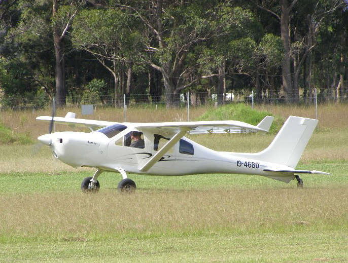

billwoodmason Posted August 18, 2017 Posted August 18, 2017 There used to be one hangared at Lethbridge Airpark, it may well be the one in the Avalon photo above. The Grey Mongrel refers to the owner. A search of Raa registrations would find him.
peterg Posted August 18, 2017 Posted August 18, 2017 Hi Flyers,Does anyone have any first hand experience or knowledge for converting a 2 seat Jabiru from tri-gear to a taildragger. Thanks in advance, RE Hello If you PM me I can put you in touch with the owner of the "Mongrel" which is based at Lethbridge and there was another at West Sale which has recently been sold - owner was/is a L2 and I can put you in touch with him as well. Regards 1

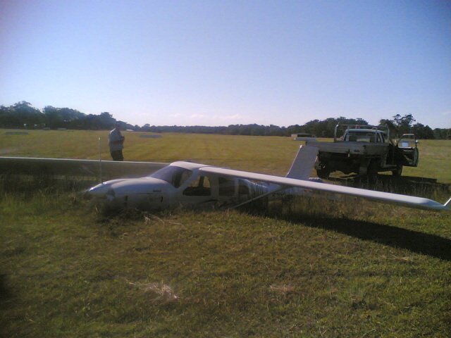

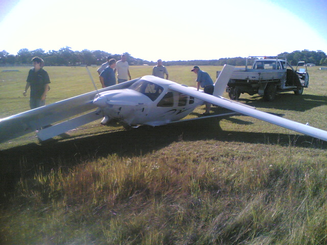

Old Koreelah Posted August 23, 2017 Posted August 23, 2017 Much as I love taildraggers, Oscar has a point about the role of the undercarriage in protecting your backside from violently meeting the ground (and in an emergency landing, that could include rocks, stumps and other nasties hidden in the grass). The Jab, like most little planes, has precious little between your posterior and the bottom of the aircraft. I've had a gear leg fail when landing a Jab and it was a non-event because there was a nose wheel to help the other mainwheel keep the prop and my butte off the ground. 1
Bruce Tuncks Posted August 23, 2017 Posted August 23, 2017 Glad all was ok Old K. What caused the main leg failure? We have had a bolt let go but that was wheeling it out the hangar, and now those bolts have been upsized.
facthunter Posted August 23, 2017 Posted August 23, 2017 Nosewheels are weak relatively. When they are gone you have no hope whatever of stopping the front of the plane digging in, as the mains are so far back, then you usually invert. Nev
red750 Posted August 24, 2017 Posted August 24, 2017 Nev, the plane in the photos is a taildragger - see tailwheel in last photo.
Old Koreelah Posted August 24, 2017 Posted August 24, 2017 Glad all was ok Old K.What caused the main leg failure? We have had a bolt let go but that was wheeling it out the hangar, and now those bolts have been upsized. Bruce it was on an old school aircraft that had done heaps of work. The inner bolt of the RH u/c leg broke as I touched down on a bumpy patch of grass. The other two bolts held, but as the leg folded up the right wingtip hit the ground and slid a few metres. The left main and nose wheel described a nice arc to the right and we came to a gently stop at a bit of an angle. No drama. After a long walk to get some tools and and new bolt I put the seat cushion and the wingtip on my head while the bolt was replaced. About ten minutes work. Superficial damage to the wingtip gelcoat only. Just love fibreglass aeroplanes, and the Jab in particular! 1
