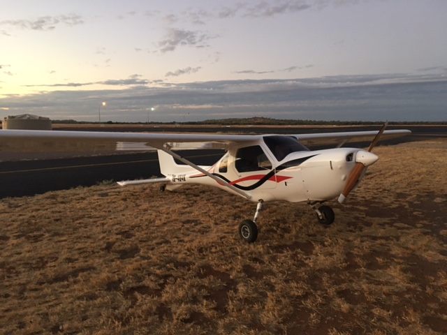

giantkingsquid Posted August 29, 2017 Posted August 29, 2017 A colleague of mine owns this Jabiru at YCCY. I have been up with him and flown it a little, it's a nice handling machine in the air, but after 150 odd hours in it he still doesn't like landing it: tail loop happy apparently. 1 1 1
