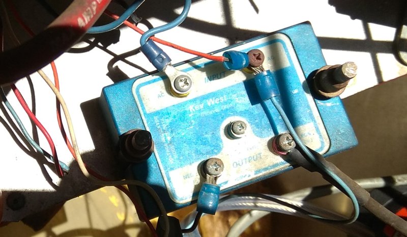

fly_tornado Posted October 2, 2017 Posted October 2, 2017 going through my wiring on one of my tornadoes and noticed that old mate has mounted the regulator with clecos and of course, my cleco pliers didn't fit
