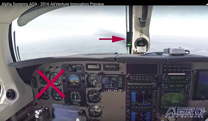

Garfly Posted October 16, 2017 Posted October 16, 2017 Or ... as Alpha Systems would have us believe: 2

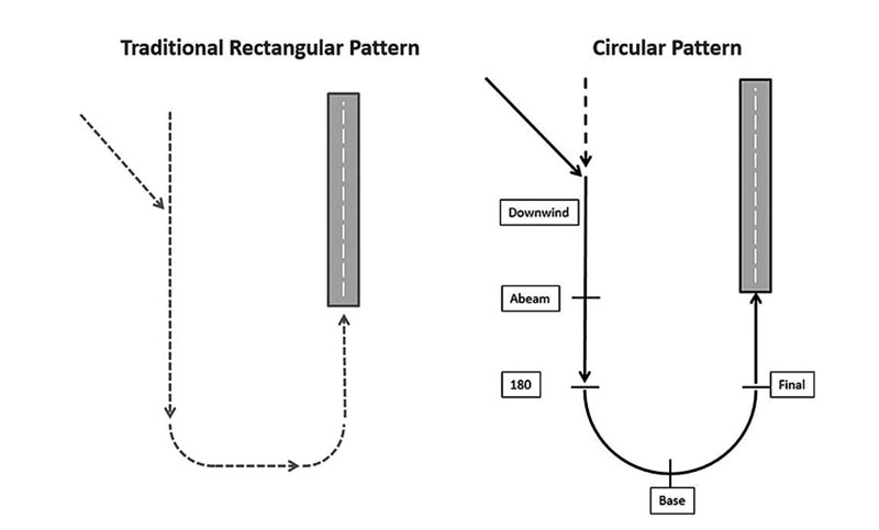

Mike Borgelt Posted October 18, 2017 Posted October 18, 2017 The late Maurie Bradney of Waikerie gliding fame used to reckon every 3 seconds to look at the ASI in circuit. Seems about right. There is interest in the USA in flying the 180 degree circuit from downwind to final. A FAA/University of North Dakota project and the latest EAA Sport Aviation has an interesting article about actual measurements of bank angle G load airspeed during the square circuit and the 180 degree circuit. I've been trying the 180 degree circuit and it seems much easier. No large bank angles, seems very sedate. Aim is to prevent the turning base/final stall spins.Military uses it. 2
Friarpuk Posted October 21, 2017 Posted October 21, 2017 Hi I've never heard of the 180 degree circuit. Pardon my ignorance, what is it? When learnng to fly or in an unfamiliar type, glancing at the ASI without becoming fixated on it is healthy. But when you know your plane glancing and feeling go hand in hand. When I learnt to fly and still do on gusty days, is to come over the fence much faster than on calm sedate days. When it's really rough even foregoing the final stage (full) flap. That's what I was taught and seems to work best for me.
Garfly Posted October 21, 2017 Posted October 21, 2017 Hi Heath, I think it refers to what's otherwise called the Circular Approach - also the "navy approach", apparently, in the US. It's pros and cons for everyday GA flying are discussed near the beginning of this article: Searching for a miracle cure to loss of control accidents | Air Facts Journal And also near the end of this one: Arriving at the VFR sweet spot - without colliding or spinning in | Air Facts Journal

derekliston Posted October 21, 2017 Posted October 21, 2017 I've always had a preference for the 'circular approach' what I've always thought of as a 'fighter approach' because if you watch the old spitfires and hurricanes, that is pretty much what they do and I think a lot of Pitts biplanes and similar seem to do the same, but I have upset a few (more than a few!) instructors during check rides and biennials because of that.
kasper Posted October 21, 2017 Posted October 21, 2017 Quote I've always had a preference for the 'circular approach' what I've always thought of as a 'fighter approach' because if you watch the old spitfires and hurricanes, that is pretty much what they do and I think a lot of Pitts biplanes and similar seem to do the same, but I have upset a few (more than a few!) instructors during check rides and biennials because of that. And if your engine and nose obscure entirely the forward view out the aircraft when the speed is reduced to circuit speed then I would agree that the circular turning approach is appropriate. However if you can see over the nose the separate square turns of base and final accomodate crosswinds and landing at different/unfamiliar airfields a bit more easily in my experience especially as a weekend flyer where my practice of flying skills is not daily. 1
