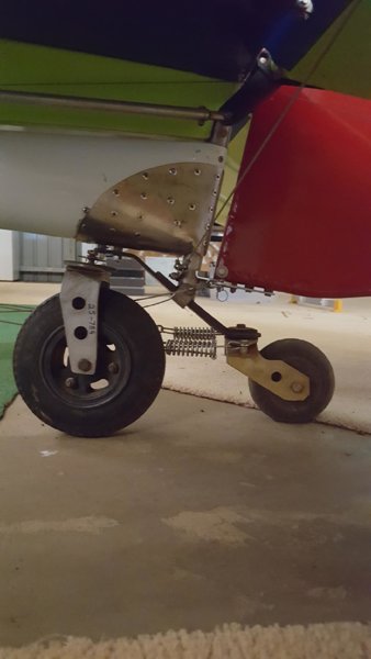

merc Posted November 7, 2017 Posted November 7, 2017 Hi Greg, congrats on your new Drifter, what was the setup with tailwheel/skid? Nothing wrong with the small solid tailwheel, I changed mine from pneumatic to a smaller solid one on the advice of the Drifter guru's. The factory did the same with the later S.B. model Tony 1 1

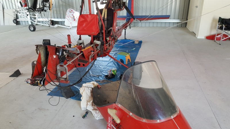

Gregory Posted November 11, 2017 Author Posted November 11, 2017 Hi BP, going good thanks , just in the process of giving her a good check over from head to toe
Kiwi Posted November 11, 2017 Posted November 11, 2017 hey Greg, how's the red rocket going. and merc - can you let me know the reasoning behind changing the bigger pneumatic wheel to the smaller solid one?cheers BP The pneumatic tailwheel can put excessive side loading on the boom/ rudder post. Most Drifters that have them usually have reinforcement "gloves" fitted. I find the smaller tailwheel allows you to fly the drifter more like a true taildrager, you have more angle of attack sitting on the ground so you can get off shorter and also land shorter. I should also mention that I have 800 x 6 main wheels. Kiwi. 1
boleropilot Posted November 11, 2017 Posted November 11, 2017 Hey thanks for the info Kiwi, nice to hear from you - how's the little lamb going??? Did you always have the 800x6 wheels? They don't look like the ones you used to have on 404 when she was at Boonah... just wondering, what take-off method do you use - just let it fly off, or lift the tailwheel and then rotate? btw, did you see that post about the guys from Victoria doing a run to Airlie Beach and back in June '18? I asked them if I could tag along for the Queensland legs, haven't heard back from them yet... Greg, m8 - holy cow - that's what you call a "good check over" - the inspection going all good so far? You've got a Drifter Legend watching this thread with K1W1 on board, what he doesn't know about Drifters ain't worth knowing - he even knows how to crash 'em !!!!! BP

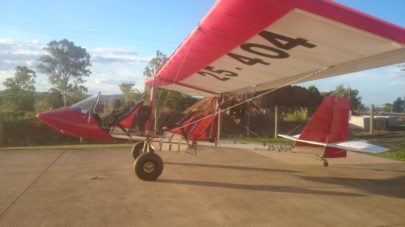

Kiwi Posted November 11, 2017 Posted November 11, 2017 he even knows how to crash 'em !!!!!BP Hi crop duster Dave, Haven't crashed a Drifter...... yet. For soft field (or to see how short I can get off the ground) I use full back stick, then once airborne hold it in ground effect. 404 used to have 600 x 6 mains Andrew

Kiwi Posted November 12, 2017 Posted November 12, 2017 Hi Greg, This is from Merc, he is having trouble posting photos........ Pneumatic wheel uses same spring, tail sits 6 inches higher. Small wheel trails behind pivot point, big wheel is underneath. Notice reinforcing boot on boom.

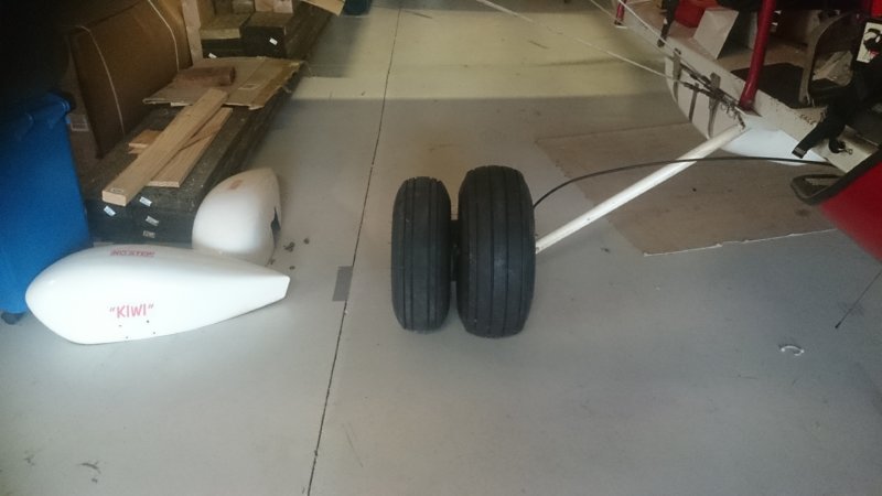

Kiwi Posted November 12, 2017 Posted November 12, 2017 And from me.. Yes the 800 x 6 are on the standard rims, if you are going to get them, make sure you order tubes as well. The downside is you can't fit the spats on, and your brakes won't work as well. With the 600 x 6's you can still make the spats fit ok. 600x6 on left 800x6 on the right. 1

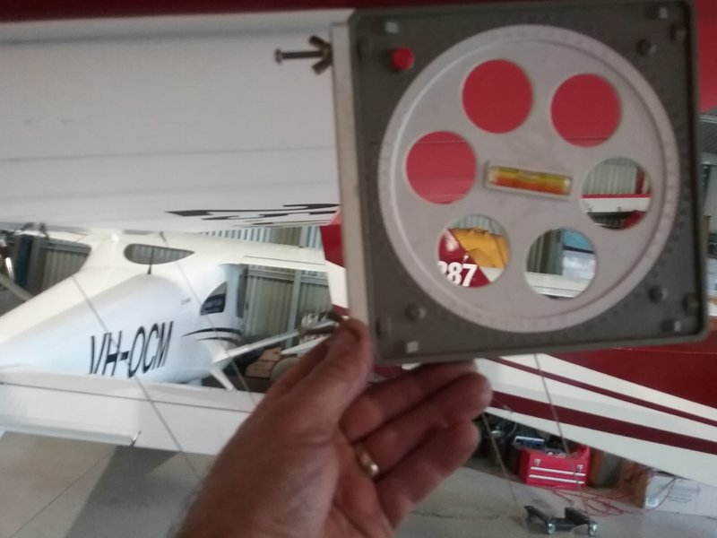

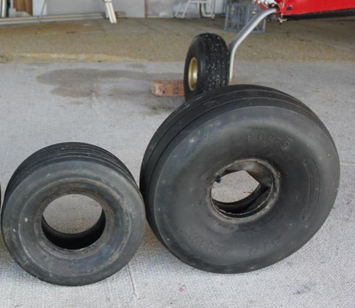

Kiwi Posted November 13, 2017 Posted November 13, 2017 How much of an improvement in short field take off and landings do you get out of the 8 x 6 mains and small tw? I've been considering doing it as well, as mine sits almost flat. fully loaded it won't fly at that AoA until I hit at least 55 kts. Most of my flying is one up nowadays, I originally had 15x6.00x6's and changed to the 600x6's a few years ago and noticed a difference on the first flight. I changed to the 800x6 as I was paddock landing quite often and thought it would help (it did). I haven't measured my take off run but I am definitely taking off shorter. Here is the 800x6 next to a 15x6.00x6 Also, I measured the wing angle this afternoon and it is at about 12 degrees. Andrew 1
Gregory Posted November 13, 2017 Author Posted November 13, 2017 Wow ! Kiwi , thats a big tyre compared with the original , i love it . May i ask where i could order these and what to ask for when ordering ? Cheers Greg.
Kiwi Posted November 13, 2017 Posted November 13, 2017 Wow ! Kiwi , thats a big tyre compared with the original , i love it . May i ask where i could order these and what to ask for when ordering ?Cheers Greg. I got mine second hand, most aviation supply stores should be able to help you out or try Superior Air Parts but you just need to ask for 800x6 tires and tubes. The non aviation ones are only 2ply, the aviation ones are 6ply (from memory) . As for weight and balance, you only have to worry about the weight as they are pretty much on the C of G. I will probably put the 600x6's and spats back on over summer to stop the wheels throwing water and mud under the wings and through the prop. Andrew
