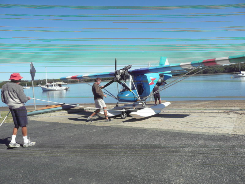

houndog Posted October 29, 2017 Posted October 29, 2017 Cec Lea (Designer) built a Kestrel with folding wings (Swing Wing variant of the Kestrel) but only one was ever made. There was a small time saving when rigging the thing, but it was a bit more cumbersome and heavier when moving it in and out of the trailer at the strip, and when doing maintenance at home. Photos of my Trailerable Kestrel at Woody Point in June 2
Hargraves Posted October 29, 2017 Posted October 29, 2017 What a wonderfull flying machine sir. Did that variant have the 503 in it and what was the preformance like on floats
howe Posted October 29, 2017 Posted October 29, 2017 Greetings from Brisbane. New Float Plane Video........ more info here Hargraves
houndog Posted October 29, 2017 Posted October 29, 2017 What a wonderfull flying machine sir. Did that variant have the 503 in it and what was the preformance like on floats Hi There Hargreaves, Yes pretty much all Kestrels have the 503. The floats are simply a mid density polystyrene block, shaped then glassed with woven cloth and epoxy resin. The main advantage of this design is if they spring a leak they won’t fill up with water and sink. It’s a well tried and proven method dating back to the early 1970’s when Cec was the first who designed and made Ultralight floats using this method. Thanks for posting the link for the float performance video Howe. Rob
