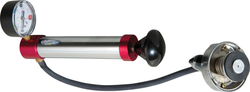

4) If you can find out what the tank cap pressure rating is, see if you can get someone with a cooling system pressure tester. It's a little gadget that clamps on in place of the tank cap and has a pump handle to pressurise the system. Pressurise the system to the cap rating and hold it there and see whether the pressure leaks down. If it does, you have a coolant leak somewhere.

Thanks for all your advice, I borrowed a radiator pressure testing outfit from a mate but none of the caps were small enough to fit the Rotax header tank so I figured I could pump some pressure back down the bleed off hose which should open the non return valve in the cap and end up in the system which hopefully might show up any leaks unsure whether this is the right way to go about it
