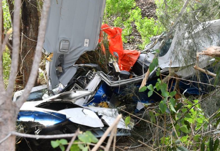

onetrack Posted November 1, 2017 Author Posted November 1, 2017 The ATSB investigation has been opened. The victims names have been released - Grant Burley, 51 and his fiancee, Suzanne Rohleder, 50. Investigation: AO-2017-105 - Collision with terrain involving Cessna 310R, VH-JMW, 40 km SSW of Port Macquarie, NSW, on 28 October 2017 I find it hard to believe this apparently, "highly experienced and extensively qualified pilot" could make such a simple and stupid mistake, as hitting a windsock. His company profile describes him as "a passionate pilot holding multi engine, fixed-wing, and rotorcraft licenses, and has ferried many aircraft, and crossed all major oceans, often solo in single engine aircraft." Grant Burley | Burley White & Co His aircraft charter operation reflects his passion, with this 1980 310R recently totally rebuilt on a major basis (obviously with cost no object), and with Burley claiming it was now the fastest and best equipped 310R in Australia. Welcome to BurlAir; Fast, Quiet, Comfortable It will be interesting to see what the ATSB find. The fact there was only a "small fuel spillage" (according to SES responders), and no post-crash fire, may be a possible hint to the cause of the crash. Even though they were nearly at their destination, there still should have been a modest quantity of fuel aboard. I don't think I've seen too many twin-engine aircraft crashes where there wasn't a fuel-fed fire on impact. To compare a similar disaster - Tony Mangan's 310 crash at Mildura in Nov 2015, generated a fuel-fed fire, and he was on final approach to his destination airport, the same as Grant Burley. Perhaps of the greatest concern is that the ATSB investigators were totally unable to pinpoint a cause for Tony Mangans crash. Investigation: AO-2015-129 - Collision with terrain involving Cessna 310, VH-BWZ, near Mildura Airport, Victoria on 6 November 2015 1

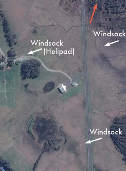

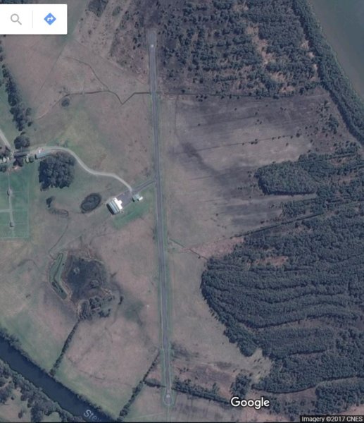

turboplanner Posted November 1, 2017 Posted November 1, 2017 The crash is reported 400 north of the airfield in the left photo near Johns River. South of the clubrooms, close to the strip is a white dot, which could be the wind sock. In the second photo, this strip is down at the bottom left corner of the photo and the Port MacQuarie airport can be seen at the top right corner of the photo. To have hit that windsock (if that's what it is, could indicate pilot incapacitation, or maybe the partner trying to get it on the strip (pure speculation I know).

pylon500 Posted November 2, 2017 Posted November 2, 2017 Have heard now from different sources regarding a windsock being at the crash site. There is a lot of bushland around the airstrip, and although I think I remember there being fences around the strip, there may well have been an animal problem on the strip. Scenario; On approach pilot see animals, initiates go'round, pulls to right of strip to observe animal movement and inadvertently hits windsock? Totally speculation. 1

Thruster88 Posted January 29, 2020 Posted January 29, 2020 https://www.atsb.gov.au/publications/investigation_reports/2017/aair/ao-2017-105/ The final report. Out of fuel followed by loss of control due aerodynamic stall. Always fly the aircraft regardless of what is happening. 1 1 1
