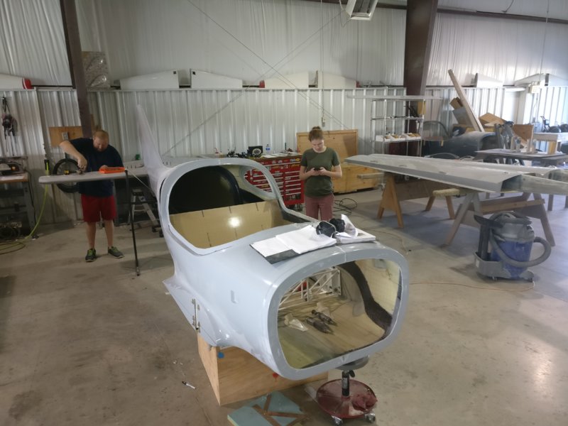

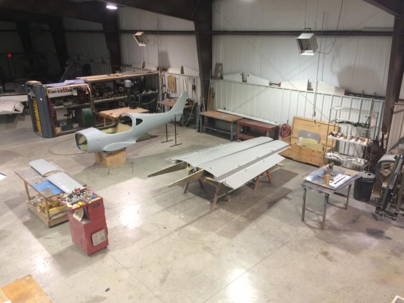

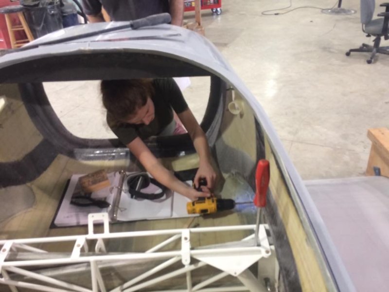

Here are some photos from Arions Facebook page from Day 1 of our build. I missed Day 1 but will be raring to go at 8am tomorrow morning.
  • Winner 1

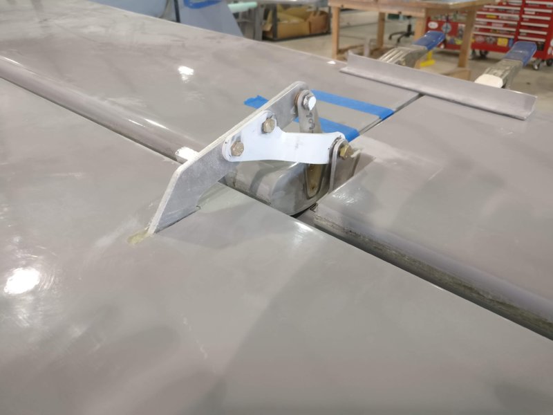

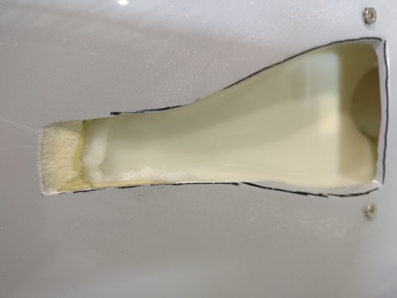

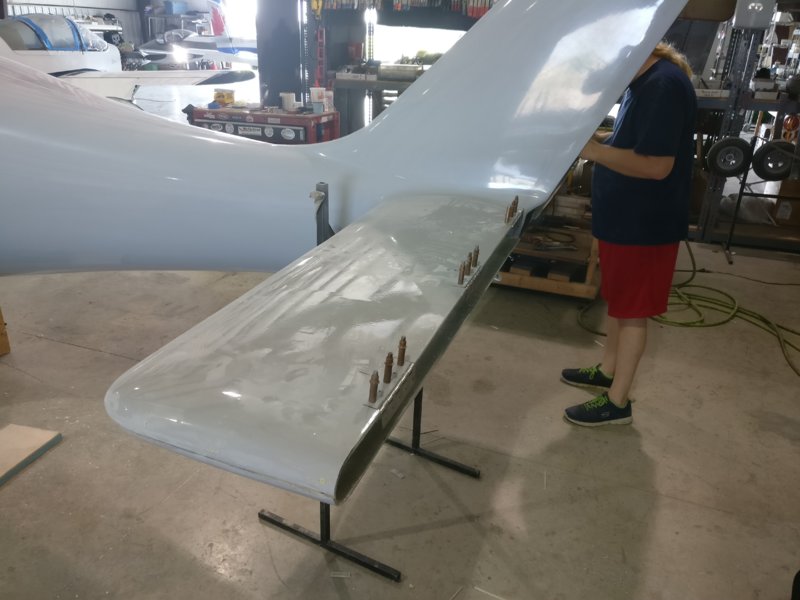

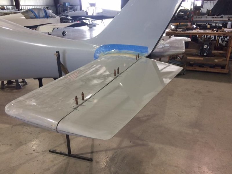

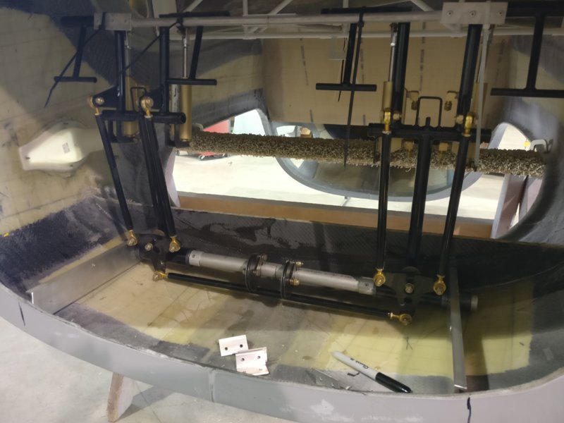

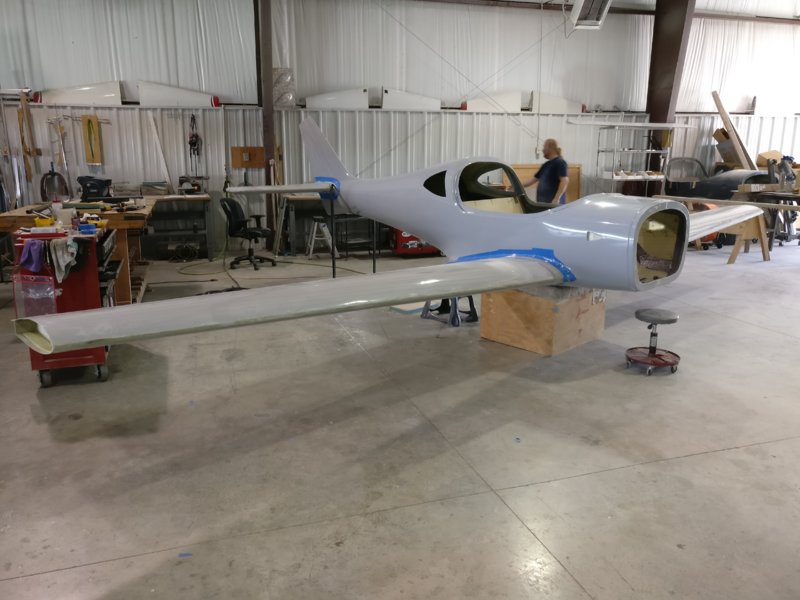

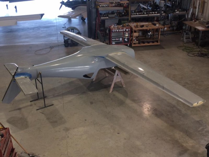

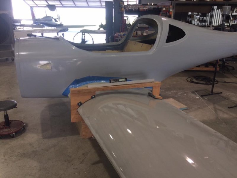

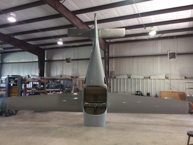

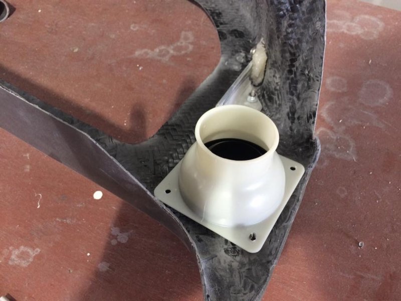

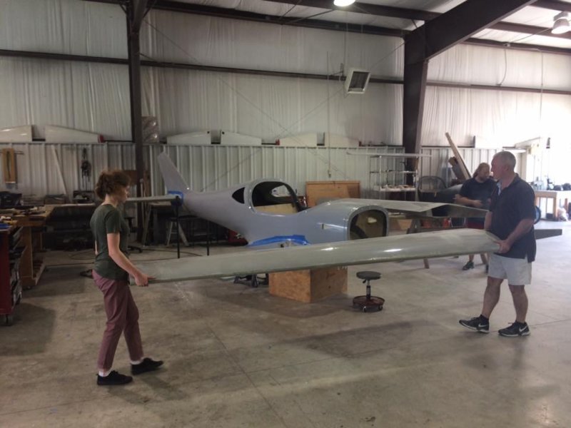

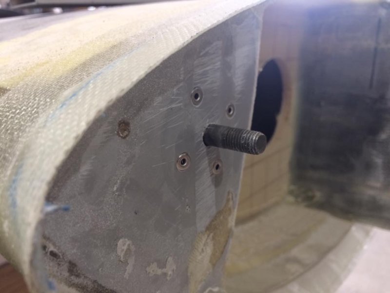

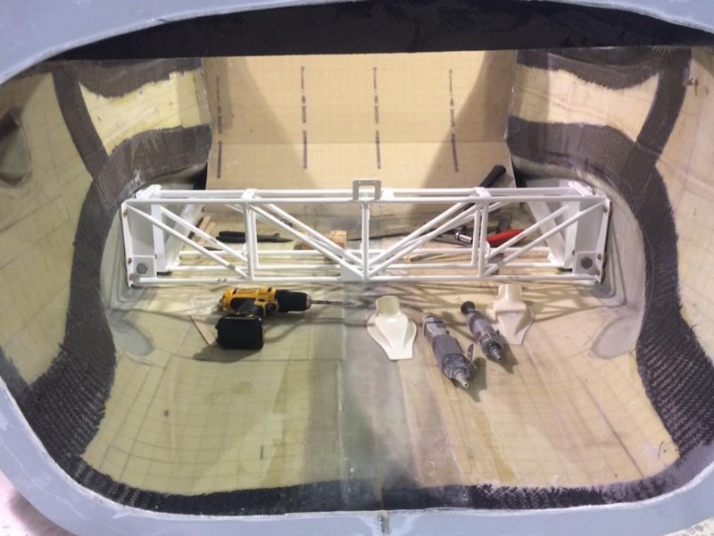

Anyway, moving on to Day 2 of the builder assist program, we installed the tailplane, mounted the hinges on the tailplane surfaces, completed the mounting of the chromolly frame that support the wing spar stubs, prepared 2 x NACA ducts, glassed the tailplane and wing root fairings, mounted the main wings including setting the angle of incidence, setting the correct sweep and ensured all was square. At the end of the day, we flipped the aircraft over in order to work on it upside down tomorrow.
Photos as follows:
  • Like 3
  • Winner 1

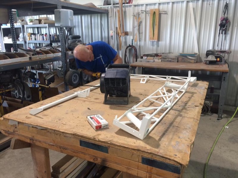

And a few more photos
  • Like 8
  • Winner 1

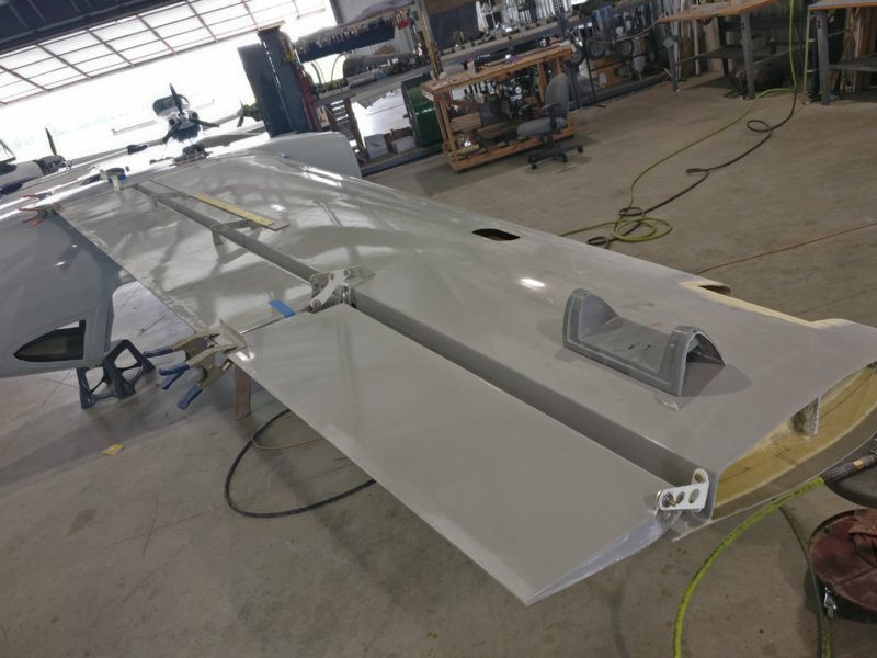

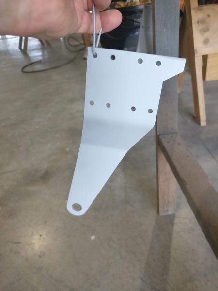

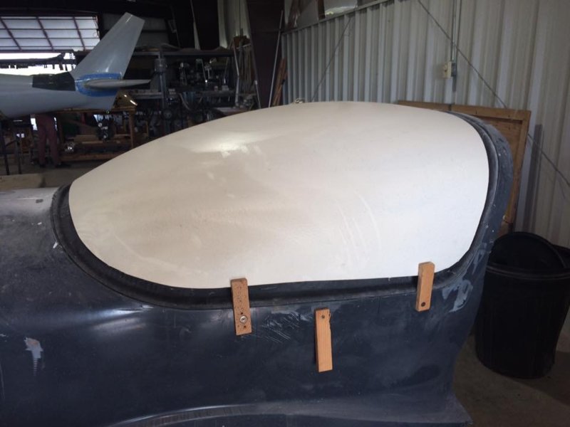

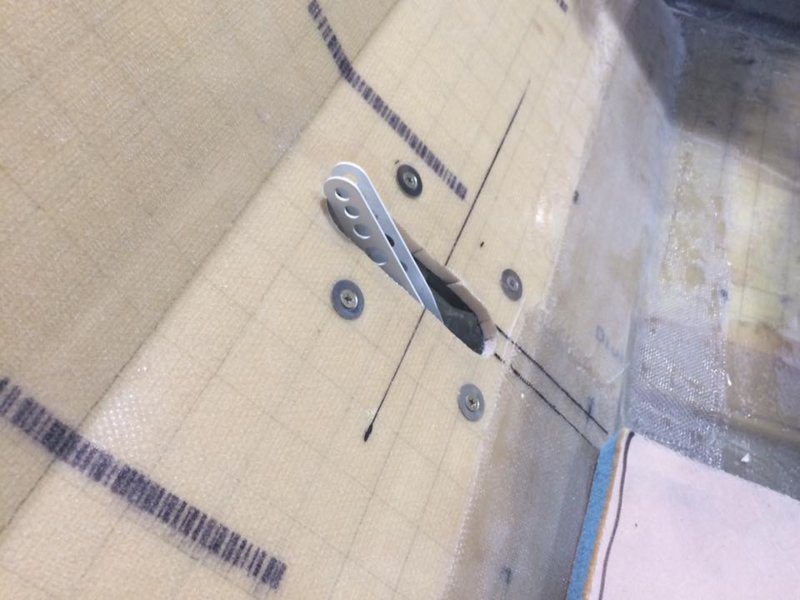

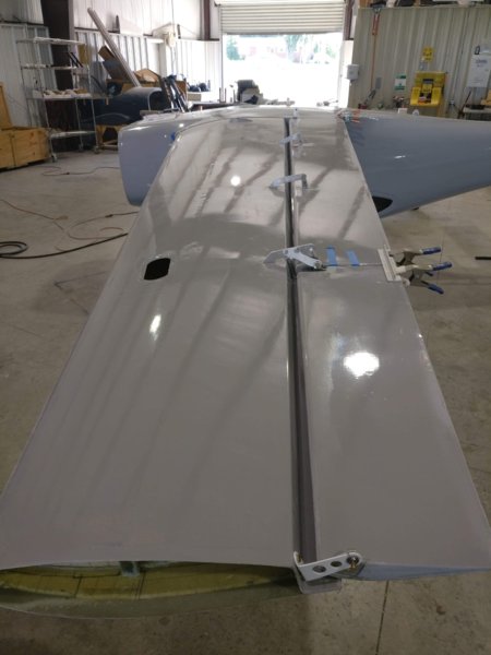

Day 3 of the build. Flaps and ailerons were installed; aileron bellcrank inspection covers fabricated and installed; landing gear fittings attached; nose gear brackets primed:
  • Like 3
  • Winner 1

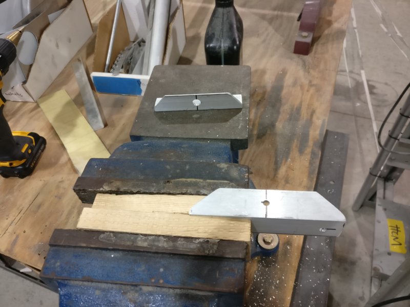

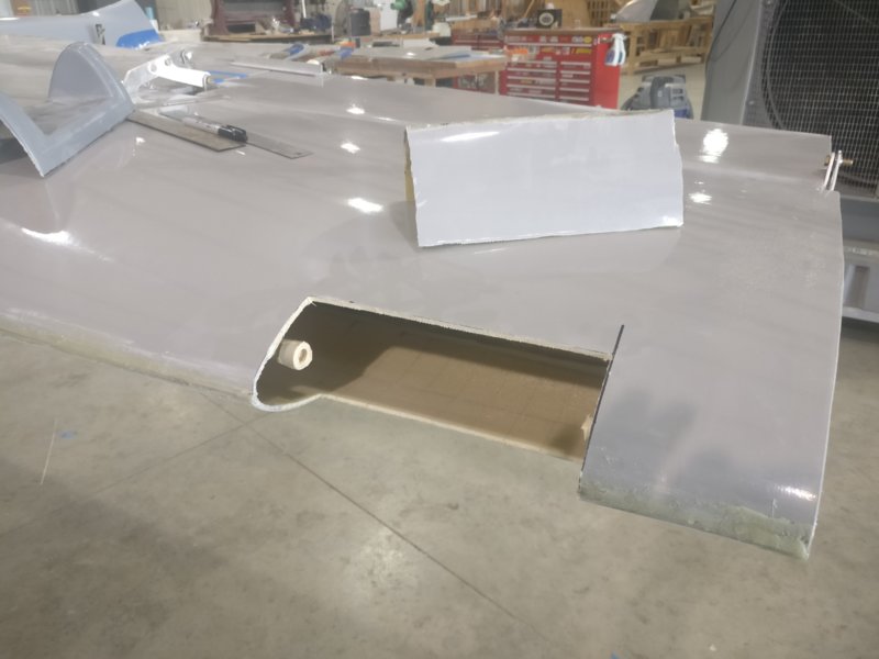

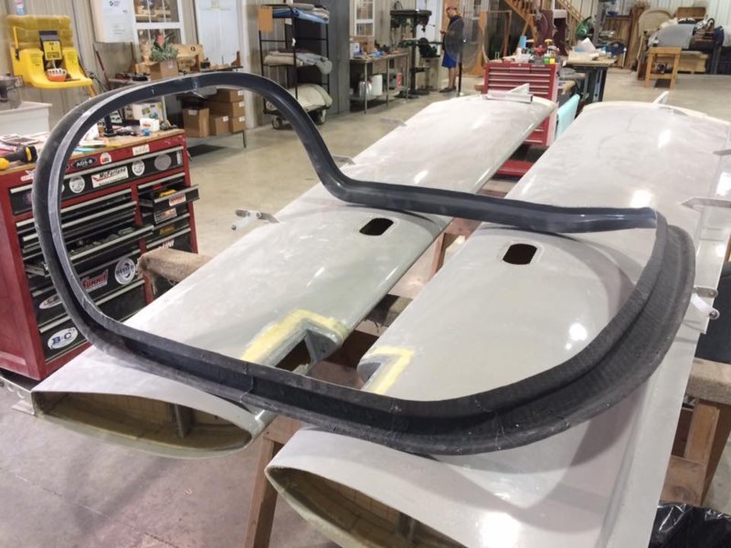

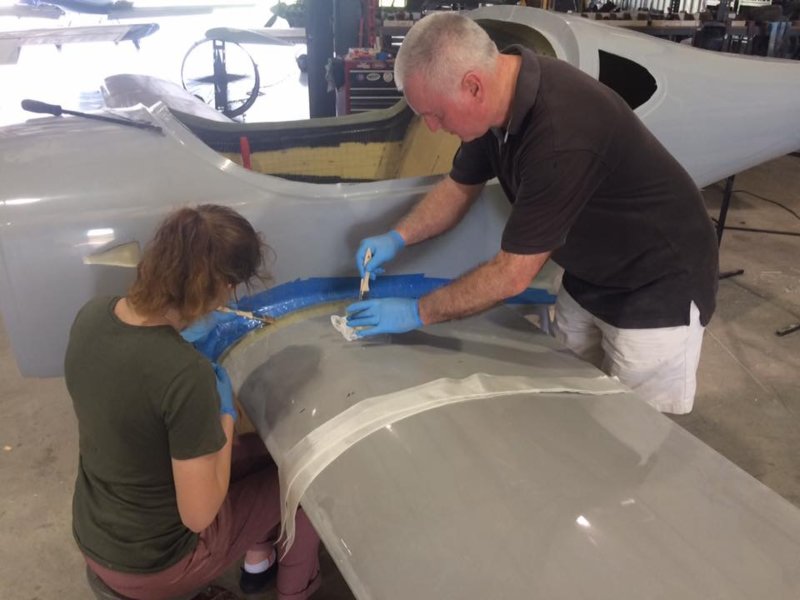

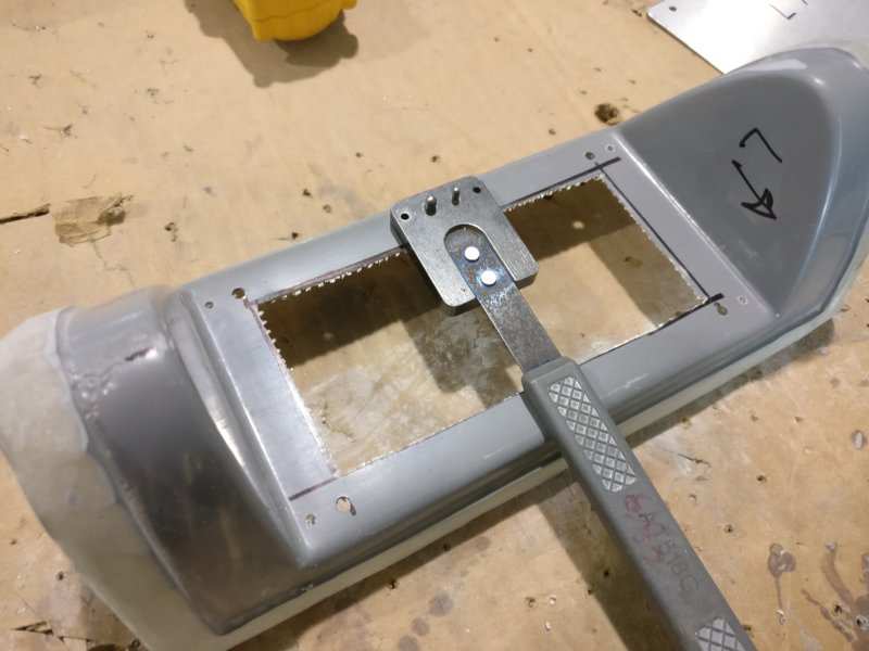

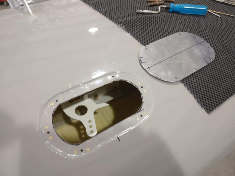

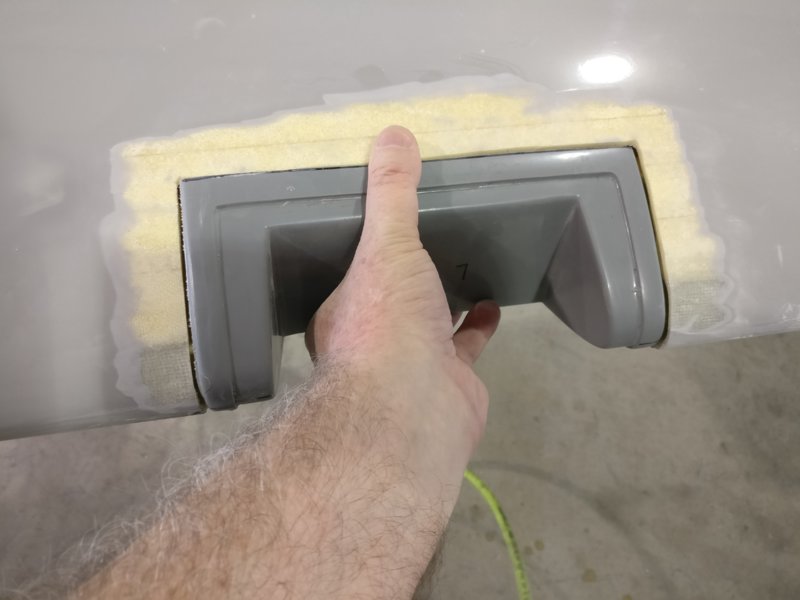

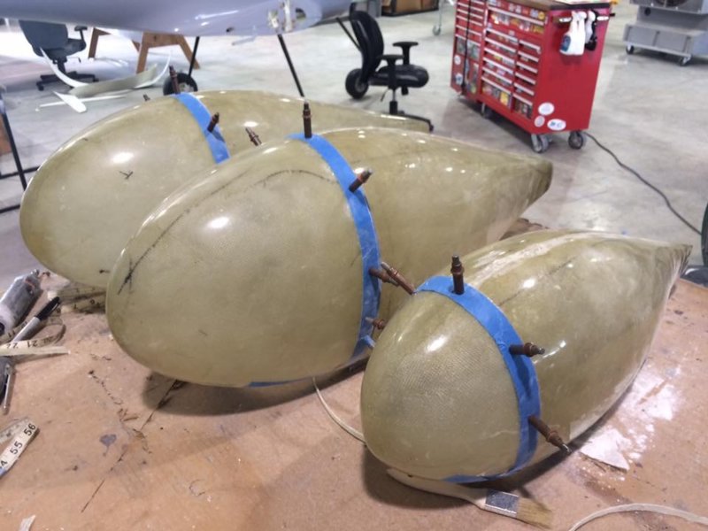

Day 4 of the build is now completed. Tasks undertaken included cutting leading edge for landing lights, preparing landing light inserts, installing inserts; fabrication and installation of horizontal stab inspection panels; final installation of NACA ducts in forward fuselage for air vents; final mounting of left wing flaps and aileron; glassing of wing/tailplane root fairings and installation of main gear legs into fuselage mounts.
It is a full on day starting at 8am and winding up at 5pm. The pace is steady and the guidance and support of Arion owner, Nick Otterback is excellent. He is an absolute pleasure to work with and really knows how to put his aircraft together.
Photos as follows:
  • Like 4

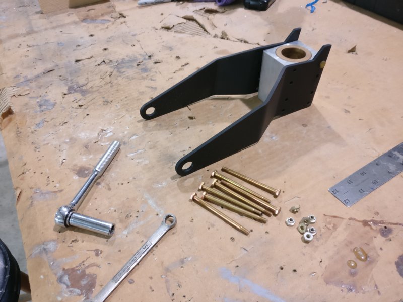

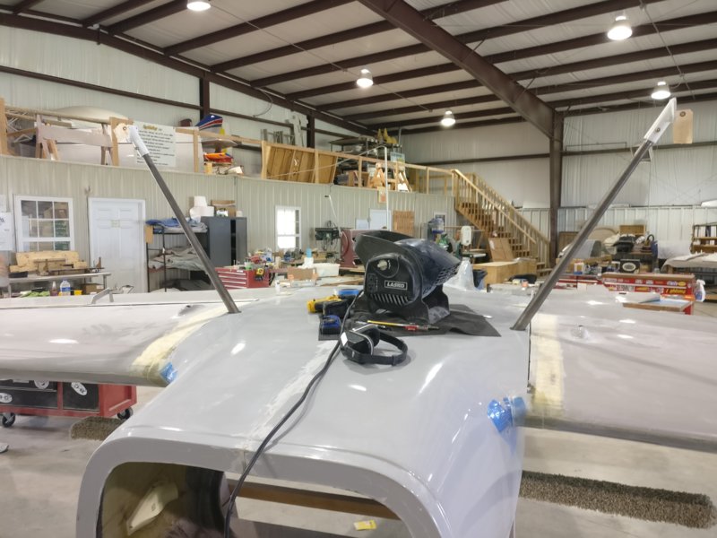

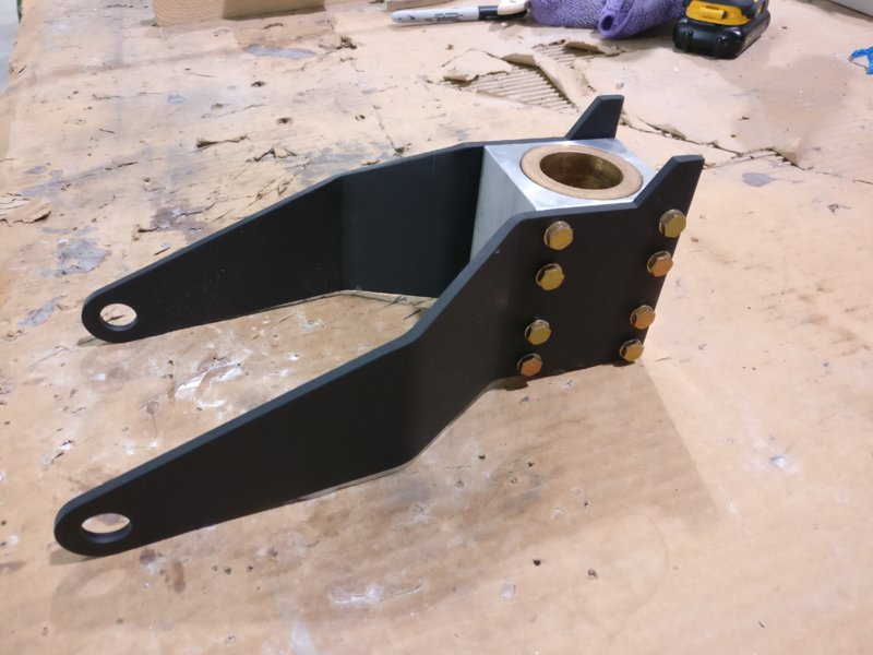

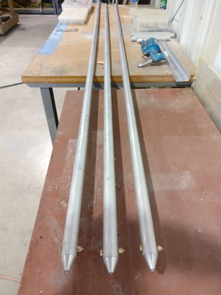

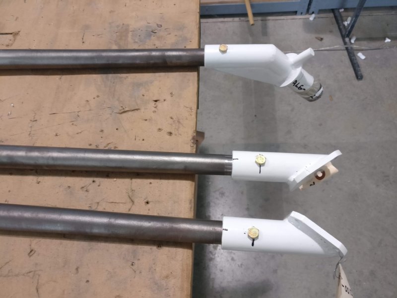

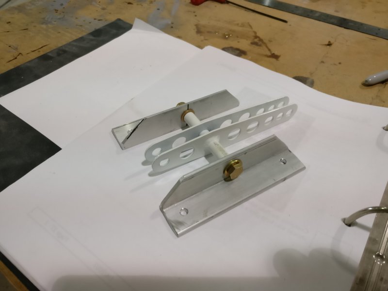

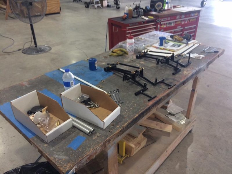

Day 5 and the first week of the build is finished. Today, we mounted the rudder pedals; fabricated the aileron and elevator pushrods; fabricated a number of brackets; assembled the wheels and assembled the nose gear fork.
Photos as follows:
  • Like 5

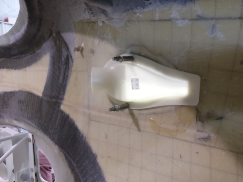

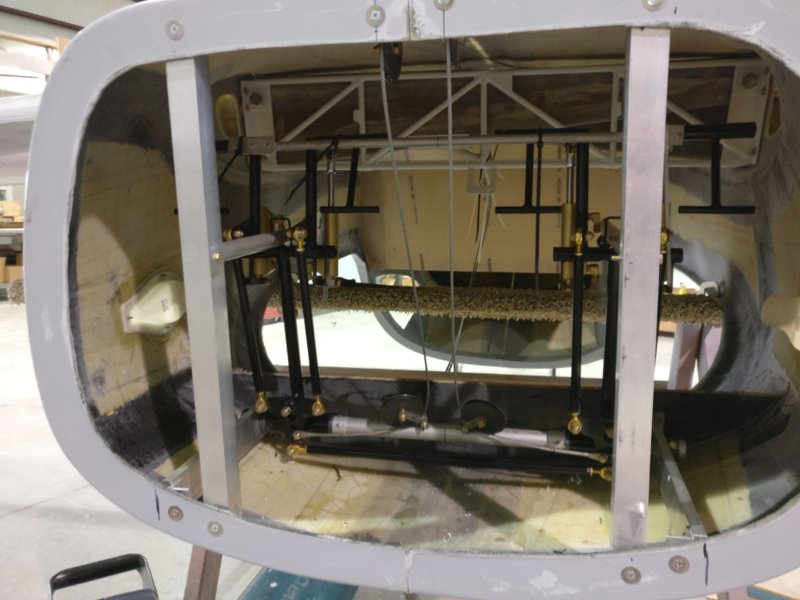

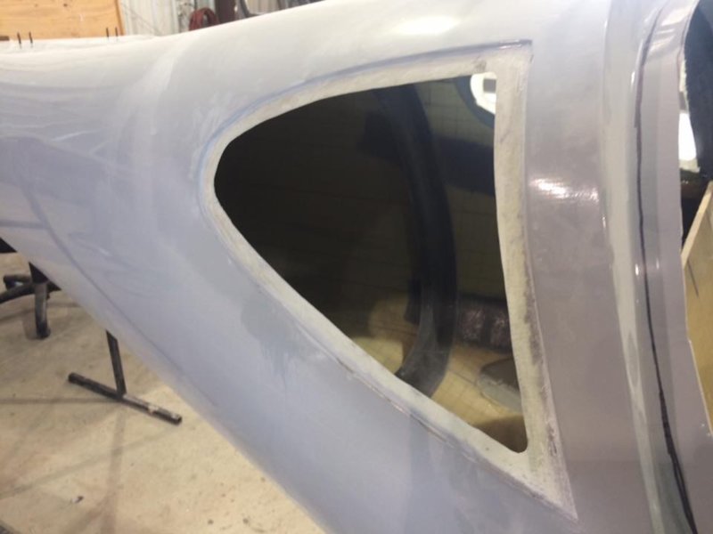

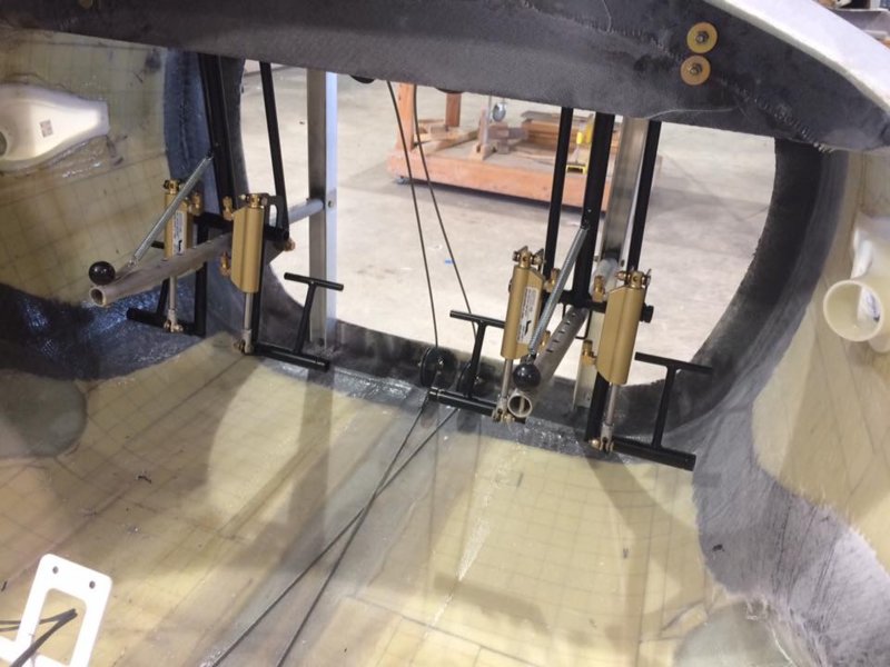

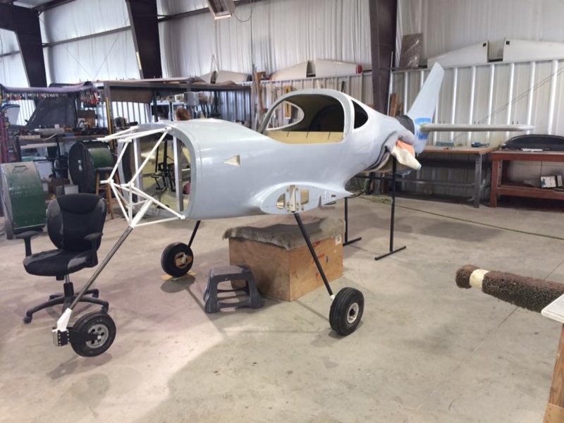

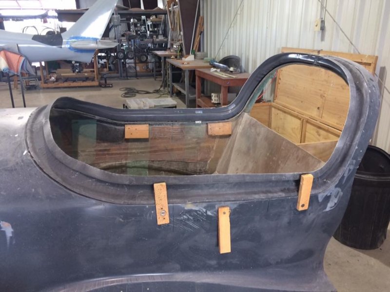

Anyway, on to Day 1 and 2 of Week 2 of the build.

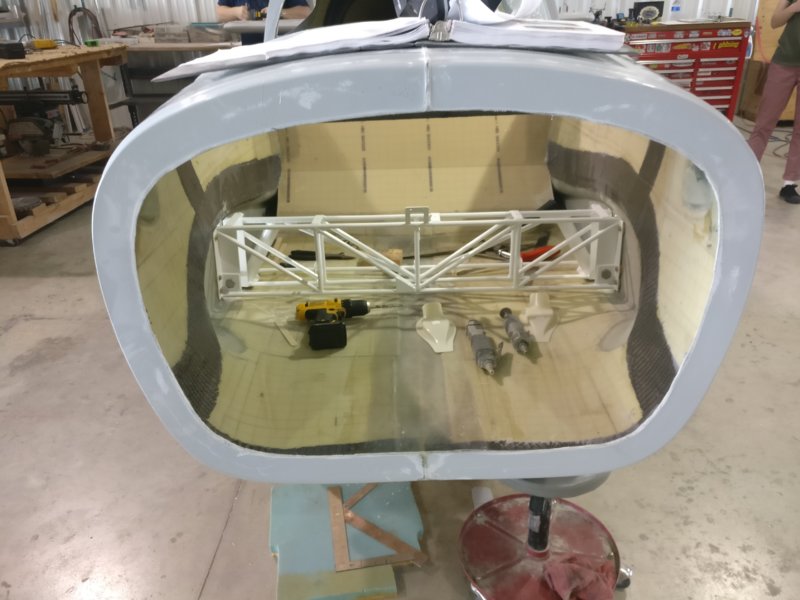

The aircraft is now back up the right way. A temporary engine mount has been fitted to allow it to sit on its gear and complete the gear leg fairings and wheel pants. Flight control systems are being fabricated and installed; control surfaces are being installed; the canopy and widows are being assembled/installed and a myriad of small jobs are being done.
Photos as follows:
