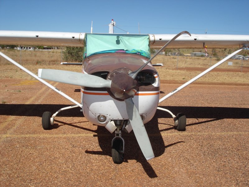

kaz3g Posted November 22, 2017 Posted November 22, 2017 Quote indeed. A relative has a 210 which he picked up cheap because the previous owner had forgotten to lower the gear....my relative's father, now deceased, flew rocket-firing typhoons extensively and to great tank-busting effect in WW2, and when he was offered a ride in the 210 said 'I never fly with amateurs". I was in the tower at Alice talking to the Controllers some years ago when a C182RG called for clearance to depart to Tennant Creek. As he was departing, I noticed the gear on one side was hanging down part way and told the Controller. He said: It always does that but he will get it up eventually. I was in Tennant a few days later and, as soon as I saw the Cessna sitting there I knew the pilot had got the gear up. He just hadn't managed to get it down again! 1 1

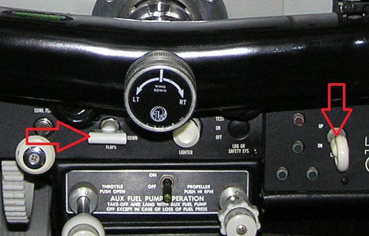

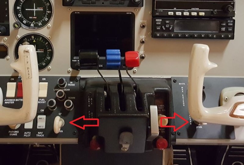

red750 Posted November 23, 2017 Posted November 23, 2017 Quote ing. (Beech put the two switches near each other).. If y On earlier model 33 (Debonair) and model 35 Bonanzas, the switches were 6-8 inches apart and distinctively shaped. The flap switch was flat, and the undercarriage switch was shaped like a wheel, so they had a distinctive feel. In later models, eg model 36, the gear switch was moved closer to the flap switch, but retained its wheel shape. On the Sierra, the switches were reversed, but on opposite sides of the throttle/mixture controls.
facthunter Posted November 23, 2017 Posted November 23, 2017 I'd like to see the gear switch guarded so it's a more deliberate action to retract. It's just too easy to lift it and it's a little thing. Big stuff has an unlock lever before it will move. It's a BIG problem (expensive) if you get it wrong and it's embarrassing. Nev 1
red750 Posted November 23, 2017 Posted November 23, 2017 As I said, it's over 40 years since I flew the Bonanza, so I may be mistaken, but I have a feeling you actually have to pull the "wheel" out a little in order to move it, not just flick it. 3
facthunter Posted November 23, 2017 Posted November 23, 2017 It's too easily done is my point . People under stress or just rushing things bypass subtle feed back like what a little wheel feels like . It should be latched so it won't unlock while the weight is on the wheels.Nev
