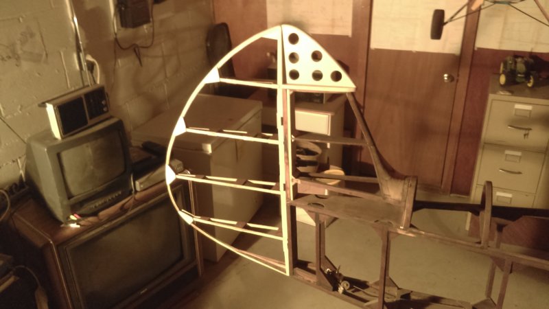

Hello all. I'm in the cold windy state of North Dakota USA and I'm building a Taylor-monoplane and sure could use some photos of the tail group to help me in my build. I have a well built Fuselage but the fella who built it glued in the vertical Stab and the prints show it to be removable. I'm having trouble seeing what the builder had in mind to get the mounting straps through the opening or was his intentions to mount the straps last? If anyone has some input it sure would be helpful. Pictures and response can be sent to me at [email protected] Thanks Don.

I'm near Grand Forks in the north east area. The plans definitely show the fin removable. the plans show that the mounting straps are on the inside of the longerons. tho many pictures of T-mono show the straps on the outside. This is why I'm asking around and hope a UK builder can give me some pointers.

my stab is dowelled to the fuse at the front & bolted to the rudder post with a cut out over the elevator. It also needs to be removable 'cause the horizontal stab in mine is one piece.

Hi Don,my stab is dowelled to the fuse at the front & bolted to the rudder post with a cut out over the elevator. It also needs to be removable 'cause the horizontal stab in mine is one piece.

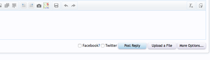

I will Roger. I'm just finishing my ribs for the Elevator and Horz. Stab and rudder. Doing the shaping of the Spars and getting hinges off my retired KR-2 cleaned up for mounting. I have some pictures posted on the HomeBuiltAirplane forum. I have a cowling for a Soneria that I hope to make fit the T-mono. I haven't figured out how to post pictures yet on this forum but will check into it.On the HBA forum I can go to my pictures on the PC and download to the site and I'am sure its the same way here but I only get asked for the image URL and mine are JPEG I guess I need to use a photo bucket?? Love your plane. Don

Down at the bottom there is an option that says "upload a file"...I know it is confusing...I think it took me years to find it...you expect it to be up the top with the rest of the functions...use that to upload a file directly to the post...It gives you a choice between uploading as a thumbnail or fullsize. I recommend that later.

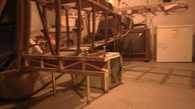

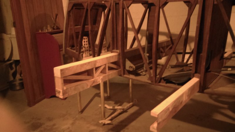

Hello fella's. I did get the KR-2 root spars cut down to fit and opened one side to put in bridge bracing. Probably just added weight but more strength the better I guess.312382076_SPAR2.jpg.a15ce2eece359be4fba1c157fa43fa84.jpg Gives me a chance to put new ply on one side.strong.gif.435354f0cb42658a3b249f79587768c0.gif

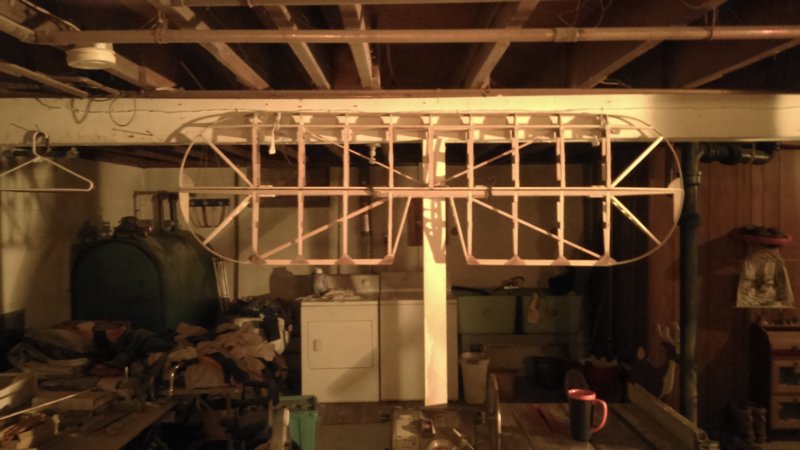

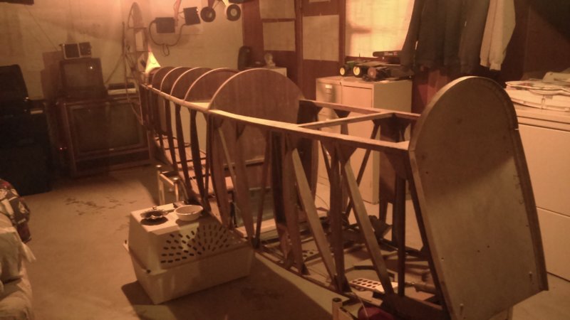

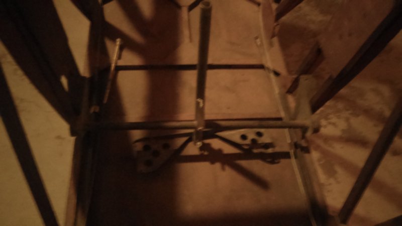

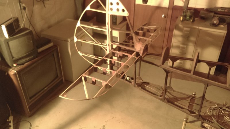

I have been working on the rudder cables and elevator here is some pictures of the pulleys I have built in. one picture is of the KR-2 hinges mounted to the rudder and also a picture on the elevator cable layout under seat. Its all a work in progress. more later1915050852_rudderhinges1.jpg.5e1ae73a40921577870857baf7a9ecaa.jpg

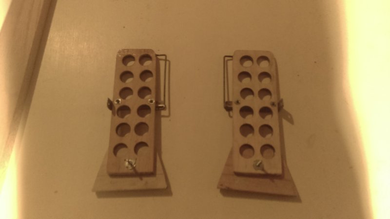

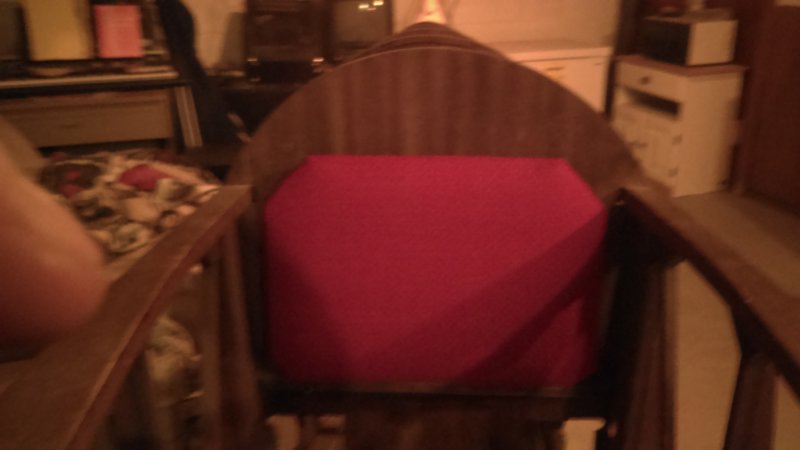

Padded my seat back rest and made seat base cushion. a little every day and you builders will be flying. I guess I'll add some red in my paint design.066_naughty.gif.8c83f7b3daf0fd08c85257855f6af534.gif85943385_seatbase.jpg.29902b851d72aa6e370566462f730912.jpg.

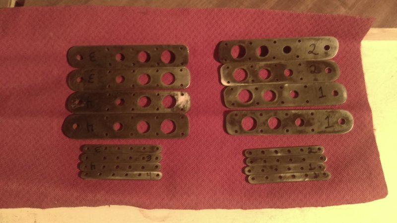

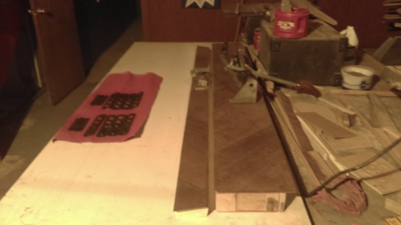

I cleaned up some WAF I had off my KR-2 looking for flaws and mainly just to get a good look at the metal and they seem to be fine. I also cut the Mahogany ply to plate the root spars for I can get the spars onto the drill press and get the control stick mounted and WAF along with the front seat mounting brackets. 122228005_waf1.jpg.fdd5881e3b7de4edd3e8840eedcd1e15.jpg
