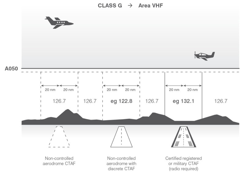

Yenn Posted December 7, 2017 Posted December 7, 2017 CASA have produced their notice of proposed rule making for multicom frequencies. They are proposing Multicom for up to but not including 5000'. Plus increasing the size oc CTAFs to 20 nm. Their reasoning is that that is what 80% of respondents to their survey wanted. It looks to me that CASA are listening to us all, but in this case I don't think it is the best decision. I know I will be in the minority with that statement and admit that I was against their original requirement to use area frequency for airstrips, not on the charts I have used area frequency as required and found that it seems to work well and in my opinion it is safer. 2 5

pgpete Posted December 7, 2017 Posted December 7, 2017 I agree with the Multicom frequency but not the increasing CTAFs to 20NM - there are many hang gliding, paragliding and microlighting operations happening just outside CTAFs with no airband radio. - do you really want this traffic on the multicom frequency? 2
frank marriott Posted December 7, 2017 Posted December 7, 2017 with no airband radio I guess without a radio they would not be on the frequency anyway. 3 1
Downunder Posted December 7, 2017 Posted December 7, 2017 All ctaf's require radio? An expansion from 10 to 20 miles means those previously flying without one, outside the 10 mile limit, may now need to purchase and use one..... 1

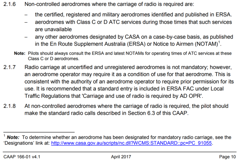

SDQDI Posted December 7, 2017 Posted December 7, 2017 Since when do all ctaf's require radio? News to me. 4
Happyflyer Posted December 7, 2017 Posted December 7, 2017 All ctaf's require radio?An expansion from 10 to 20 miles means those previously flying without one, outside the 10 mile limit, may now need to purchase and use one..... Only certified, registered and military aerodromes need a radio, not every CTAF. As far as I know if you don't need to now you won't need one when this is in. 3

Kiwi Posted December 7, 2017 Posted December 7, 2017 Only certified, registered and military aerodromes need a radio, not every CTAF. As far as I know if you don't need to now you won't need one when this is in. What concerns me is increasing the certified (and non certified) CTAF's to 20nm, there are a lot of airfields within 20nm of Toowoomba, and if you MUST have a radio to operate in Toowoomba CTAF, then do all aircraft within 20nm have to carry a radio. ie: Helidon, Wyreema, Cambooya etc..... 1
Downunder Posted December 7, 2017 Posted December 7, 2017 Only certified, registered and military aerodromes need a radio, not every CTAF. As far as I know if you don't need to now you won't need one when this is in. Yes, and no....
cscotthendry Posted December 7, 2017 Posted December 7, 2017 All ctaf's require radio?An expansion from 10 to 20 miles means those previously flying without one, outside the 10 mile limit, may now need to purchase and use one..... Or conversely, the ruling will keep non radio traffic at least 20nm away from CTAF airfields, keeping that swarm of paras that pgpete posted well out of harm's way. On the other hand, 126.7 is already so congested (particularly here in SE Qld) that at times all there is, is a constant squeal on the radio as someone on the ground at Tyagarah keys up their mic at the same time someone at Gympie is announcing turning base etc. The person on the ground at Tyagarah can't hear the person at Gympie, but if I'm in the air over Kilcoy, my radio just about blows my headset off with the transmission collision. And it's not just an occasional occurrence on 126.7. 2

Downunder Posted December 8, 2017 Posted December 8, 2017 Maybe more CTAF freqs would be the answer for heavy traffic areas rather then pushing unnecessary traffic onto area. At a CASA safety meeting last week, the CASA rep said more frequencies will be opened up on a "case by case" basis. They are aware the CTAF expansion (distance and altitude) won't be perfect in all circumstances and will deal with problems as they arise. Anyone seeing a conflict or potential conflict/problem should contact their state rep I guess. Aviation Safety Advisors (ASA) | Civil Aviation Safety Authority Maybe the earlier, the better....
SDQDI Posted December 8, 2017 Posted December 8, 2017 Increasing CTAF distance from 10-20nm while not a perfect solution I think that in itself will help reduce some of the congestion. For example in our local area there are a couple of strips that we have used where we will now be able to use our ctaf rather than area (or 126.7) However I don't really like the idea of taking more sky away from those not equipped with a radio around cert strips, I guess it would be too complicated to amend rules so that radio was only required in the inner 10nm of those strips?
Downunder Posted December 8, 2017 Posted December 8, 2017 Increasing CTAF distance from 10-20nm while not a perfect solution I think that in itself will help reduce some of the congestion. For example in our local area there are a couple of strips that we have used where we will now be able to use our ctaf rather than area (or 126.7)However I don't really like the idea of taking more sky away from those not equipped with a radio around cert strips, I guess it would be too complicated to amend rules so that radio was only required in the inner 10nm of those strips? I think alot of the push for 20NM comes from faster aircraft, IFR, and rpt getting on the CTAF earlier and giving more warning. Something fast "inbound on descent" can be in the circuit frighteningly quick.... 2
