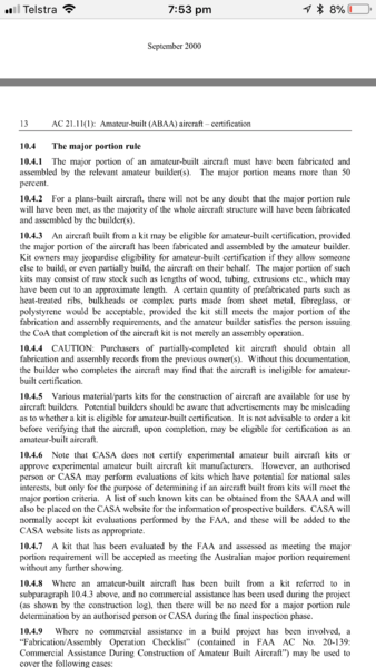

crazy diamond Posted December 26, 2017 Author Posted December 26, 2017 So according to the current owner there are at best incomplete or bare to non existent build logs available, so based on that my guess is it’s pretty much pointless as CASA wouldn’t approve it. No idea of the glues etc used along the way so just a big old can of worms...

Markproa Posted December 26, 2017 Posted December 26, 2017 I'm not sure how it all works but I rang the SAAA technical officer recently and was told I can start building my plane without informing anyone. There are no longer any stage inspections so who's to know who built what? Maybe call SAAA and ask to speak to him, I think his name is Norm. Nice helpful fellow.
