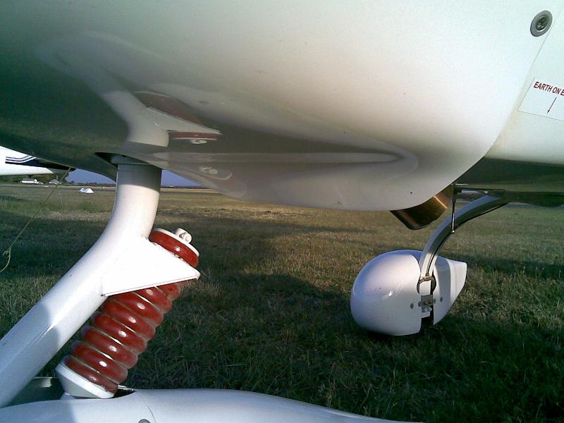

Guest brentc Posted December 21, 2007 Posted December 21, 2007 Don, do you have the newly updated cowls with the lip at the bottom? Refer back to previous posts in the Jabiru forum here where I posted pictures of cowl modifications we made to some Jabs down here experiencing the same problems as yours. I was at the factory 2 days ago and took a picture of the latest cowls - I shall post here tomorrow. There is an approximate 5-6cm lip at the bottom of the cowl that didn't use to be there. Can you post a pic or email pic of your cowl base, down where the exhaust passes it? PS - I aim for 90+ knots climbout minimum. 100 is better, but not always achievable easily if you're tight on room or have noise complainants nearby.

Guest brentc Posted December 21, 2007 Posted December 21, 2007 Here's pic of latest cowl. Do you have a duct around the oil cooler yet? A mod is about to come out to block the holes around the oil cooler where it attaches to the cowl. The mould was being finalised only a couple of days ago.

emaroo Posted December 31, 2007 Author Posted December 31, 2007 Update Some improvement oil TEMP J230 ****!!!!!!! This the second time I have have tried to write this and each time I have lost it - so third time lucky. I now have my wife typing this as it takes me all day with one finger typing. First, thank you for all the responses to our problem. We have checked all the wiring and the earths and all appears to be okay and no change to the oil temperature. We purchased our factory built Jabiru in Feb this year 07 and it was one of the first planes to have a lip attached to the bottom cowl. It was screwed to the bottom cowl unlike the later models such as Brent C which are part of the fibreglass mouldings. We have a new J230 in the hangar which has the larger moulded lip and bigger hole in the bottom cowl. We have now tried increasing the size of the hole of the bottom cowl to improve the airflow. The good news is this has slightly improved the oil temperature but is still too high for our liking in moderate to hot outside temperatures. Our real concern remains why weren't we having problems back in Feb when temperatures were hotter and the motor brand new. We checked the service records and earlier in the year we were having trouble with oil pressure as it was always running just in the yellow. After consulting Jabiru we tried several different things and finally by changing the sender this fixed the problem. However one of the fix's suggested by Jabiru was to increase the oil pressure by adding a washer to the relief valve. At our first attempt adding one washer this increased the pressure too high to the point where the motor would not start. I assume the high oil pressure meant that the hydraulic tappets would not totally close causing the motor not to run. We tried a thinner washer which slightly increased the pressure and we were able to start the motor but it wasn't until we replaced the sender the problem was totally solved. So now we are thinking like Don C that this higher oil pressure could be affecting the hydraulic tappets and causing the motor not to run at its optimum and maybe contributing to our problem of high oil temperatures. So we plan to try and remove the washer and reduce the oil pressure to see if this could help solve the high oil temp.
