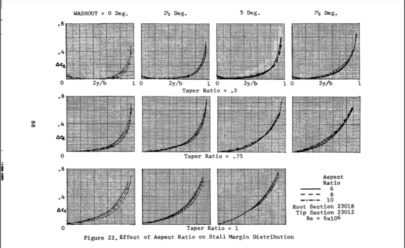

djpacro Posted January 1, 2018 Posted January 1, 2018 I didn't go to the trouble of finding out what aerofoil section etc is on the Beaver so just plucked this figure from https://ntrs.nasa.gov/archive/nasa/casi.ntrs.nasa.gov/19710021678.pdf A Design Summary of Stall Characteristics of Straight Wing Aircraft showing the typical effect of aspect ratio on stall margin distribution.
David Isaac Posted January 1, 2018 Posted January 1, 2018 I didn't go to the trouble of finding out what aerofoil section etc is on the Beaver so just plucked this figure from https://ntrs.nasa.gov/archive/nasa/casi.ntrs.nasa.gov/19710021678.pdf A Design Summary of Stall Characteristics of Straight Wing Aircraft showing the typical effect of aspect ratio on stall margin distribution.[ATTACH]53284[/ATTACH] DJP, If I read those graphs correctly, the lack of taper has a greater effect on stall than the aspect ratio alone. Is that a correct interpretation

djpacro Posted January 1, 2018 Posted January 1, 2018 DJP,If I read those graphs correctly, the lack of taper has a greater effect on stall than the aspect ratio alone. Is that a correct interpretation Yes, taper plus washout and aerofoil section (especially different aerofoils spanwise). Most data around is for a steady, straight stall (without power/slipstream effects) however the stall margin distribution gives an indication of behaviour in other situations - a skidded turn, for example.
