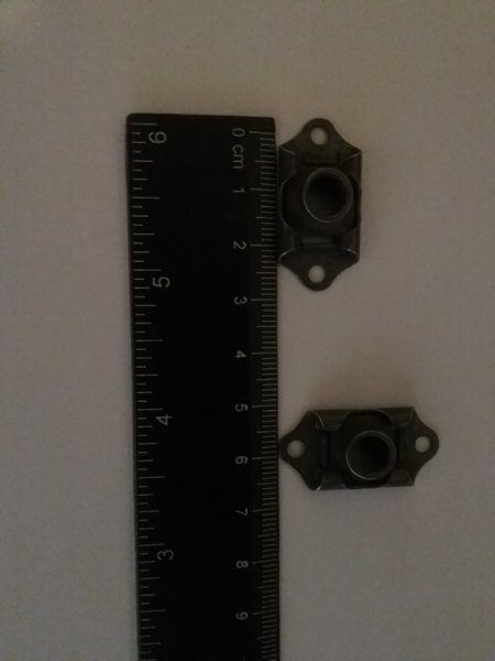

rtfm Posted January 4, 2018 Author Posted January 4, 2018 I love it... A nut plate is a small plate to which a threaded "nut" is attached. This is fixed (via two screws or small bolts) to the rear (or internal) side of a surface that allows a bolt to be inserted through the front face and screwed into the nut plate bolt. 1

M61A1 Posted January 4, 2018 Posted January 4, 2018 5/16 nutplates (anchor nuts) should be really easy to find at any aviation workshop MS21059L5 for floating, or K1000-5 , like the one you have pictured. . Rod ends from CBC or most bearing suppliers. 5/15 unf of for aviation suppliers 5/16-24. Toowoomba Bearings and Hydraulics keep a whole rack of them on the shelf. There are metric ones (anchor nuts) out there but pretty much only used by Airbus and are a pain to get.

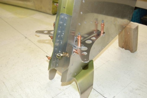

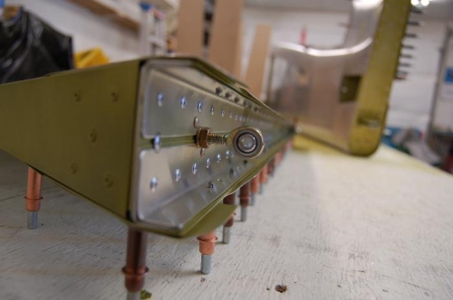

rtfm Posted January 4, 2018 Author Posted January 4, 2018 Hi guys, As usual, your replies have been very helpful. Thank you. I plan to use them as hinges for my rudder. David Melby posted details of his setup, and I'm wanting to copy his arrangement. This is the part fixed to the tailstock. The rod-end bearing attaches to the rudder (fastened with a nut plate) and fits between the two angles. I plan to use two of these. Here's what he says about it: "My new rudder hinge. The half of the hinge attached to the tail post is made from 1/8" alum angle, and the other half that is attached to the rudder spar is a rod end bearing. I am using one with a 5/16" dia. shaft, and a 1/4" dia hole. The rod end has a swivelling bearing, which makes a great hinge. The rudder moves without any friction at all. Since the nuts holding the hinges will be hidden, I used self-aligning nut plates. the top hinge has 2 3/16" bolts and the bottom hinge has four. I used #2 stainless screws to hold the nut plates in place." The sizes he mentions aren't set in stone, I think. So, as long as the rod end and nut plate threads match, and the thread is long enough to go through the 15mm thick spar of the rudder and screw completely into the thread of the nut plate, I'll be fine. My initial request for 8mm rod ends was based more on the length of the threaded section than anything else. Sorry for not providing the full details to begin with. Regards, Duncan 1

rotax618 Posted January 5, 2018 Posted January 5, 2018 That is possibly the heaviest hinge to use, and bad design to boot, there is no omniversal motion in the tail assembly. Have a look at what Mignet used. You only need brackets similar to what you have made for the tail post and a couple of AN3 bolts with bushes and castillated nuts. The 8 mm rod ends need 8 mm bolts, rather an overkill.
M61A1 Posted January 5, 2018 Posted January 5, 2018 The 8mm or 5/16 rod end I imagine may be for stiffness in bending, on the bright side it is self centring and could easily be sleeved down to 3/16 in the ball.
Kiwi Posted January 5, 2018 Posted January 5, 2018 That is possibly the heaviest hinge to use, and bad design to boot, there is no omniversal motion in the tail assembly. Have a look at what Mignet used. You only need brackets similar to what you have made for the tail post and a couple of AN3 bolts with bushes and castillated nuts.The 8 mm rod ends need 8 mm bolts, rather an overkill. I have seen rod ends used on control surfaces before on a Bushcaddy, seems to work fine but I do agree 5/16 been over kill. 1
rotax618 Posted January 5, 2018 Posted January 5, 2018 It is bad design to have bending and shear loads on the threaded section of a bolt or fastener. The Bush Caddy rudder looks like another example of lazy design. 1

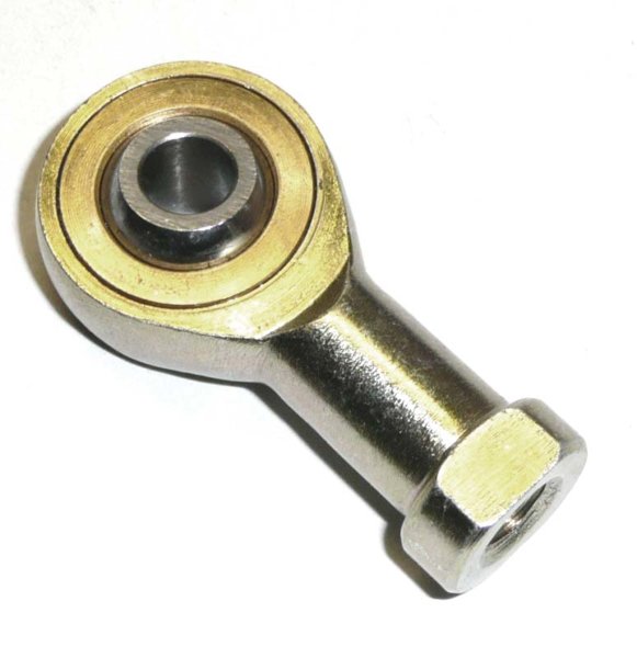

Downunder Posted January 5, 2018 Posted January 5, 2018 Something like this would probably be better.
