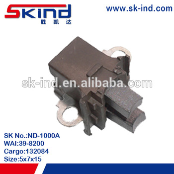

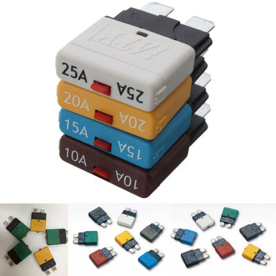

spacesailor Posted January 22, 2018 Posted January 22, 2018 PMC Wrong!, has a normal two brushes set, which puts 12v into the alternator . thats the reason why flat batteries wont charge by atternator. Have you seen any of these, Blade contact-breaker. spacesailor
skippydiesel Posted January 27, 2018 Posted January 27, 2018 PMCWrong!, has a normal two brushes set, which puts 12v into the alternator[ATTACH]53650[/ATTACH] . thats the reason why flat batteries wont charge by atternator. Have you seen any of these,[ATTACH]53651[/ATTACH] Blade contact-breaker. spacesailor Pretty sure JayCar has the blade contact breakers
