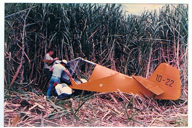

This could have been a Fatal!
The pilot was the owner and this was his first flight; I`d test flown it for him the day before, it flew well and was quite maneuverable; he was flying circuits off a local turf farm here at Deeral, was on final approach, reduced the power and the engine stopped; had he been 100` higher when he reduced the power, he would have easily been able to safely land, where he took off from.
What isn`t in the photo is the drain about 2 mts wide and 2.5 mts deep and about 1.5 mts behind the tail, he just cleared it, had he hit the bank of the drain, it would have ended completely different.
That`s Ron Biondi holding the prop and myself, the guy looking under the AC is the owner/pilot.
These days I mostly fly from home, but over the years I flew from many different places, one thing that has never changed though is my principal on final; I always keep more than enough height to make my landing point then slip it off if I need to.
I believe, what is needed on this thread, is more stories of real-life experiences, from those who have had engine failure, talking from theory is almost useless.
Frank.

In my post above, I should have added, there was no damage to the aircraft or pilot because he kept it flying all the way down and just settled it on top of the tall sugar cane.
If done correctly, landing on top of tall sugar cane can be a soft landing in all the types of Ultralights` that I`m aware of and have flown, I`ve had to! but I`m not so sure about the nose wheel LSA.
Frank.
