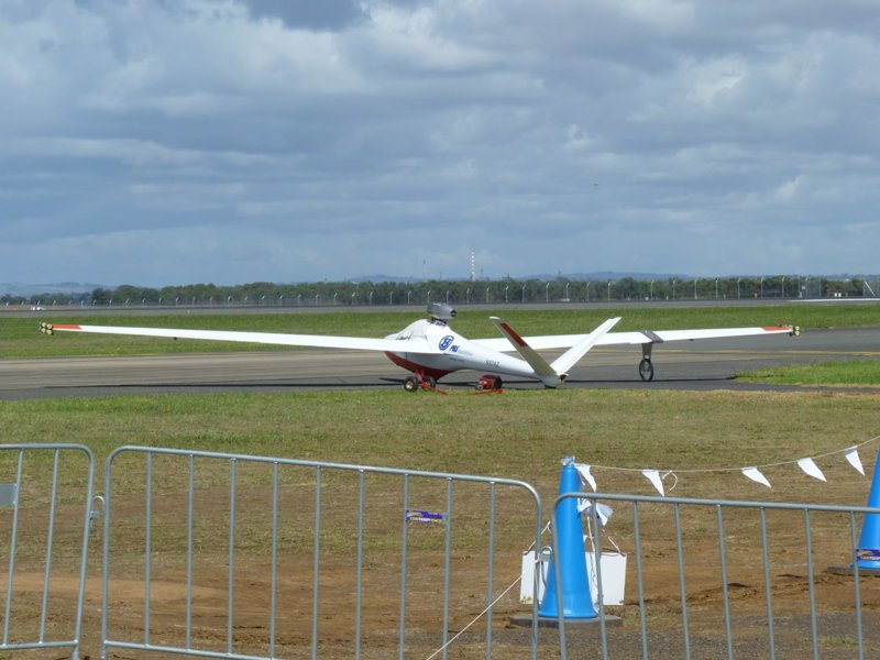

Here's a photo of a jet glider which performed at the Avalon Air Show in 2015. Smoke canisters on the wingtips.
That just sounds like a lot of noise for no real benefit. It would annoy the crap out of me
