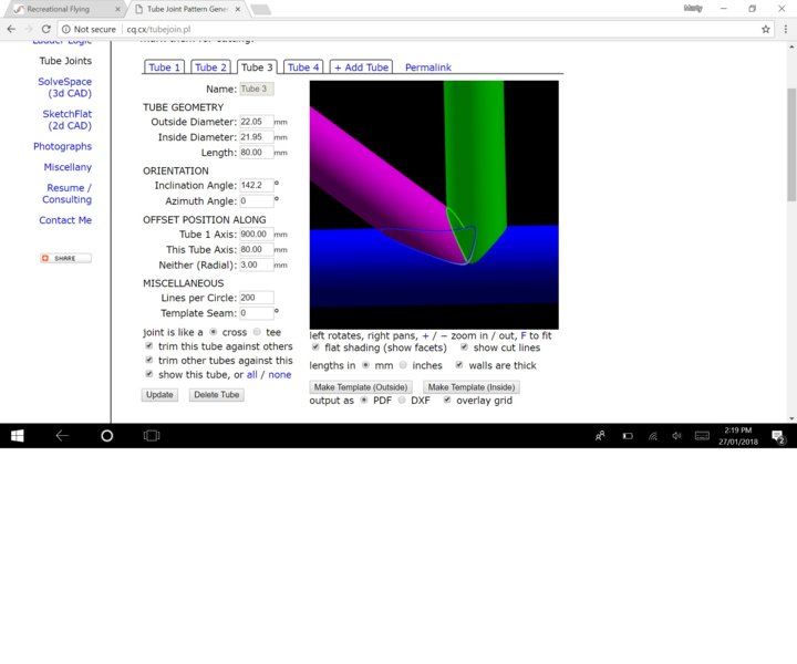

I was looking for a way to get the pattern to apply to tube before cutting, especially for a multi-joint - eg, on the 701, where the top tube and diagonal meet the cross tube between the wings.

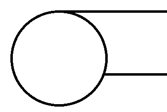

As well as allowing inclination angle, it also allows you to offset the axis so your smaller tube can meet at the top of the larger one (eg :
rather than always being in the middle (eg:
Here's a screenshot of the program:
