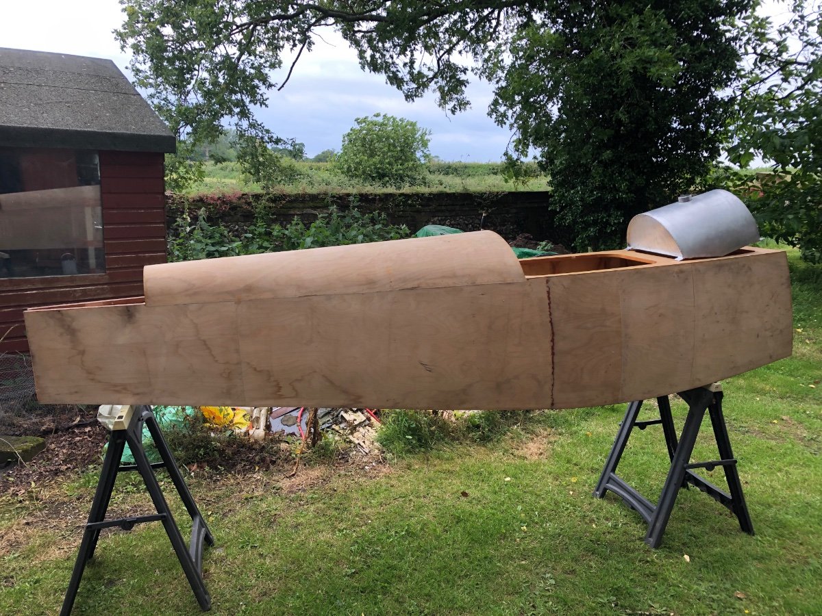

Teggles Posted June 9 Posted June 9 Hi Don, My Taylor Mono is a project started in 1978, so now it is part restoration and part build. Here is the fuselage with my new fuel tank. Yes the sides are on and no controls or anything fitted inside, which will be a challenge! There is some water staining but it is just a stain, no problem with the ply. I also have a rudder, which is OK, elevator - ok, tailplane which needs some work. Spars, 2 of which need some restoration, wing ribs which seem ok and a few odd bits and pieces. In the U.K. we are quite strict with materials and the design. Any changes needs to be submitted to our regulator for approval, so we don’t have the flexibility you have in the U.S. 1
Don J Posted June 25 Posted June 25 Teggles. No mention on wings and landing gear? When you open root spar holes, I would pilot drill from inside the fuselage outward because it makes for much less sanding and fitting. Cable routing will be a challenge due to ply already added on turtle deck but is doable. I guess you're getting ready to cut in inspection plate holes before covering with fabric ? What engine are you going to mount ? Post progress when you can I'd like to see how things are coming along. Don

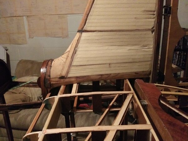

Don J Posted July 6 Posted July 6 I did not like the way the mounting for the Hoz. stab is per plans. Doing it the way did I can adjust AOA incidence if desired. A 1600cc or 1835 cc Vw will get you about 50-55 hp and to run that RPM prolonged can and does ruin the heads near the valves. You could ask around and see if someone has some WAF(wing attach fittings) from a KR-2 for sale. There was a time you could buy WAF's from NVaero. th (1).jfif
Teggles Posted July 7 Posted July 7 Do you have any drawings for your tailplane attachment fittings I could possibly look at? Being able to adjust the tailplane would be really good.
Don J Posted July 7 Posted July 7 (edited) Teggles go to page one of this thread, and you can see picture of mounts dated April 11th 2018 and a few further down. Edited July 7 by Don J 1

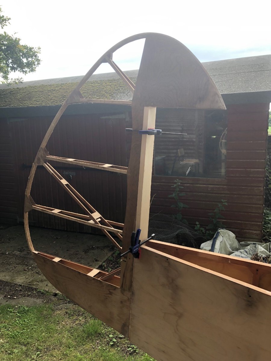

Teggles Posted July 20 Posted July 20 As this is a partially completed project, I have undo some of what has been damaged or built wrong. Today is the rudder post, cracked with 2 big wood screws holding it together! Just 4 mortice joints, no problem except they are coming together at several different angles, nothing square 😩 but it is done, not glued yet and it’s vertical! 1
Teggles Posted July 21 Posted July 21 I have seen smaller, not bigger. Do you think the mono does not have enough rudder?
facthunter Posted July 22 Posted July 22 It certainly doesn't have too much . I've seen one flying example and I wouldn't say it's for unskilled drivers. . IF speed is your aim leave it as it is. Now's the time to consider it, not after you've finished it. Nev

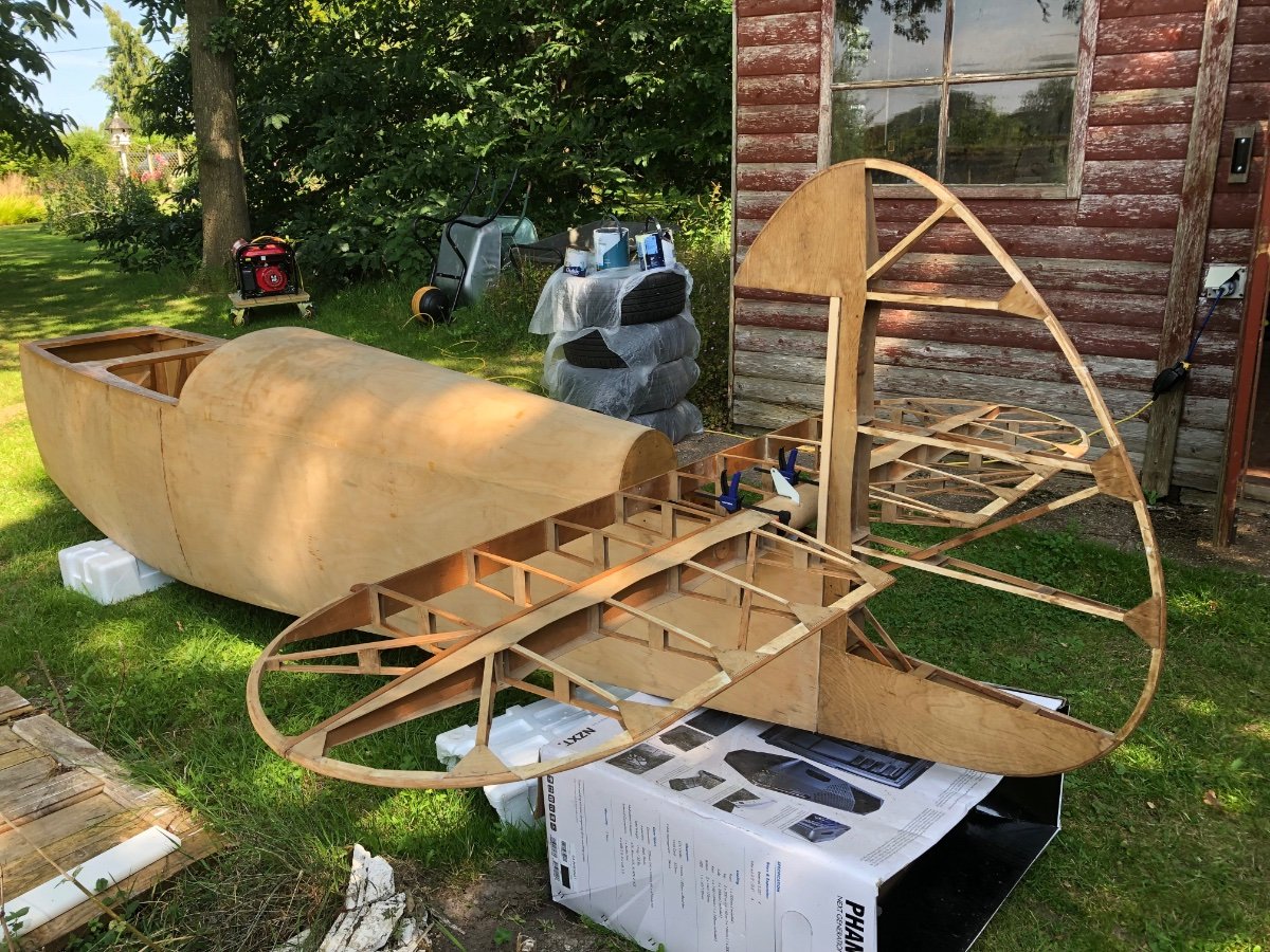

Teggles Posted July 31 Posted July 31 Nice working in the sunshine, becoming a rarity here in the UK! 4
Don J Posted July 31 Posted July 31 (edited) Tegg. Sun does help💡 and I hope you have your hinges worked out. It took some time to get mine aligned. It helped having a 5 ft. long 3/16" metal dowl. I guess you are going per plans on hinges. I found it helps a lot to build a rotisserie to hold each end of the fuselage where you can rotate it 360 degrees especially during covering with fabric. Looking good friend keep at it. Don Edited July 31 by Don J 2
Teggles Posted July 31 Posted July 31 Hi Don, I was going to use a laser for getting the hinges aligned. Just started cutting out the metal for the hinges. It’s the small jobs that take the time 😄
Don J Posted July 31 Posted July 31 Good luck on the laser method. I found the best result was to use feel of hand after I got the hinges as close as laser would allow, and it seems every time I had to remove the pins to work on the controls after reinstalled things always needed readjusted in hinge alignment. In other words, Tegg the hinges are a pain in the ass to say it politely.🫢 Do you have your vertical Stabilizer built yet? The reason I ask is the VS can be built to help in roll over protection as I did mine. Don

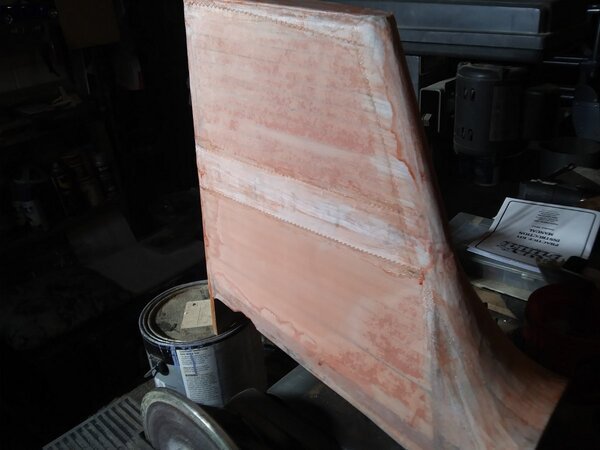

Teggles Posted July 31 Posted July 31 The vertical stab, which was with the project when I bought it is for the trash. Badly built and is a very poor git. Interesting you mention roll over protection. A couple of weeks ago I was at the UK’s Air Accident Investigation Branch (equivalent to your NTSB) and the question of roll over protection came up in a discussion about a couple of accidents. How did you incorporate protection into the fin?
Rhys1701 Posted July 31 Posted July 31 On 21/07/2024 at 2:17 AM, facthunter said: Has anyone ever put a bigger rudder on a Taylor Mono? Nev Absolutely! My (new to me) 1988 build has square wingtips, elevator and tail. Superb unique look - questionable improvement in handling YMMV.
Don J Posted July 31 Posted July 31 (edited) 2 hours ago, Teggles said: The vertical stab, which was with the project when I bought it is for the trash. Badly built and is a very poor git. Interesting you mention roll over protection. A couple of weeks ago I was at the UK’s Air Accident Investigation Branch (equivalent to your NTSB) and the question of roll over protection came up in a discussion about a couple of accidents. How did you incorporate protection into the fin? As you can see in the photo, I took high density foam and stacked glued it into the inside of fin with the hopes it will help keep the cockpit accessible if plane is on its back. I believe a roll bar just behind the head mounted in the hard point of seat belt will be incorporated in my build also. With these two added safety features in a nose over in dirt or mud your chances are 2-x better to get out of the plane. Plus, no need for ply covering the fin if made solid with foam and med fabric. Edited July 31 by Don J 1
