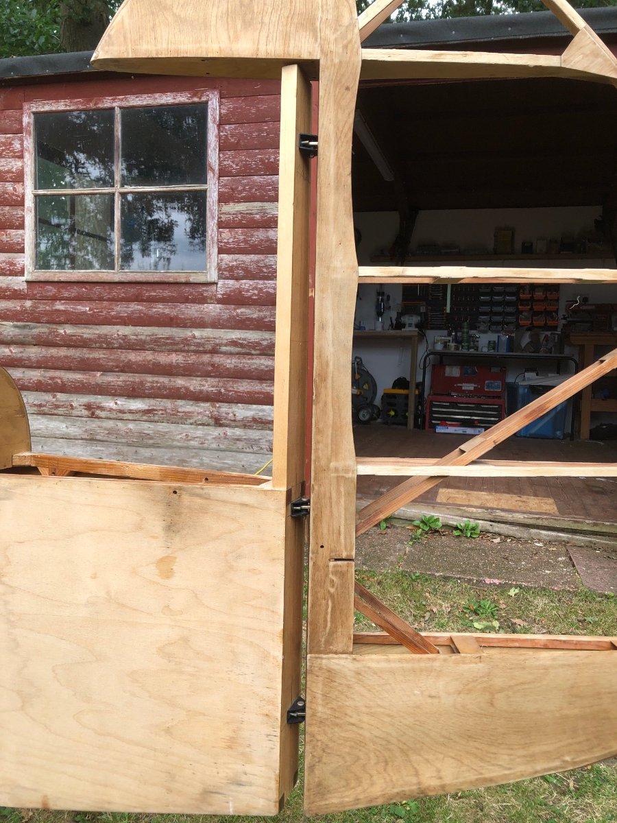

Teggles Posted September 7 Share Posted September 7 Just having a celebration cup of tea (I am British). Hinges made and rudder on with no binding or play - and it’s straight! Yes there is more to do, but you have to take the wins when they come 😁. 3 1 Link to comment Share on other sites More sharing options...
Don J Posted September 7 Share Posted September 7 What is the plan on mounting the vertical Stab to the tail post? Are you going to use the hinge bolts? Don't forget those balsa strips that go on the leading edge of the rudder spar and elevator before fabric. Just think my friend only a few hundred things to do.🤪 Keep at it and keep use posted. DJ 1 Link to comment Share on other sites More sharing options...
Teggles Posted September 7 Share Posted September 7 That’s a good thought, I was thinking of separate bolts for the vertical stab but combining them with the hinge is a good idea. I have the balsa for gap sealing, so that will go on in the next few days. 1 Link to comment Share on other sites More sharing options...
Don J Posted September 7 Share Posted September 7 The top rudder hinge would be an easy transfer of holes to the VS you do have two bolts holding the hinge half on? Are you going tail skid or wheel? I used self-locking tee-nuts on the inside of my VS and HS along with elevator spar to ease in mounting and un-mounting of controls. then left enough thread to pass t-nut to add a ny-locking nut for further safety. Access holes had to be incorporated to pass a wrench inside to hold nuts and fabric patches will cover them for future access. How is the cable routing going? Hope all is well and happy flying Teggles. 1 Link to comment Share on other sites More sharing options...
Teggles Posted September 7 Share Posted September 7 I have yet to start on the VS, but will look at using the hinge bolts to secure it. I will have a tail skid, lots of grass strips around here and will save a little weight. Cable routing….as you say the rudder should be straight forward but the elevator I am trying not to think about 😂😂 1 Link to comment Share on other sites More sharing options...

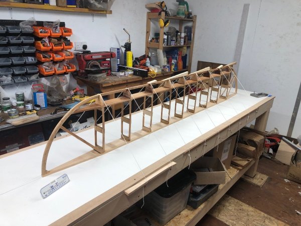

Teggles Posted Wednesday at 12:57 PM Share Posted Wednesday at 12:57 PM Warm day here in the UK, so that random it’s a glue day! Replacing the rear spar on the Mono’s tailplane. 1 1 Link to comment Share on other sites More sharing options...
Don J Posted Wednesday at 01:37 PM Share Posted Wednesday at 01:37 PM Looks great Teggles. It's a shame that all that gets hidden under plywood. Don't forget those hinge blocks on the inside of spar and I also mounted T-nuts before final ply was added. 1mm ply is tougher than I thought it would be to wrap around the leading edge but some soaking in hot water and a heavy 2" pipe worked wonders. Keep at it friend and keep us posted. 1 Link to comment Share on other sites More sharing options...
