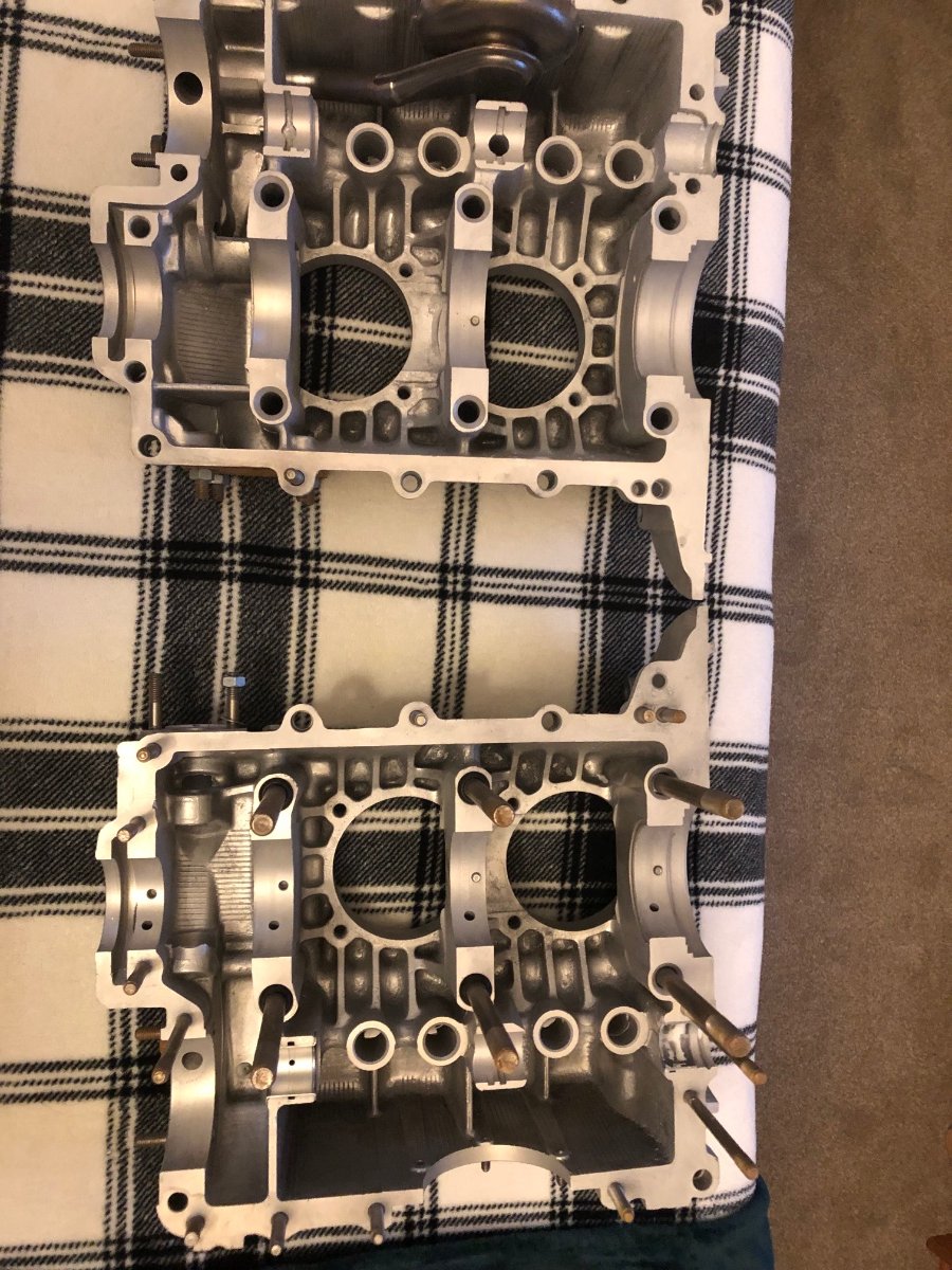

Teggles Posted December 19, 2024 Posted December 19, 2024 Hi Don, Its too cold in my workshop to glue at this time of year so I am getting on with the metalwork. I have got the wing fittings water jet cut. Much better than laser as the laser heat treats the metal as it cuts. Undercarriage and associated fittings are progressing. Engine? After much angst I am going for a VW 1776cc with a 110 or scat 25 cam. Single port heads with 1:1:1 rockers. This should give enough power but the torque will be lower in the rev range. The case has been vapour blasted, now to get a line bore. 1
facthunter Posted December 19, 2024 Posted December 19, 2024 You want to make sure that is done very accurately. Are you decking the block or using oversize OD bearings? Nev
Teggles Posted December 19, 2024 Posted December 19, 2024 It’s with a specialist VW company. I’m not that good! 2

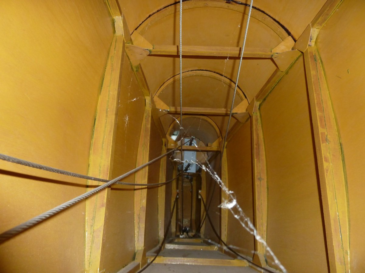

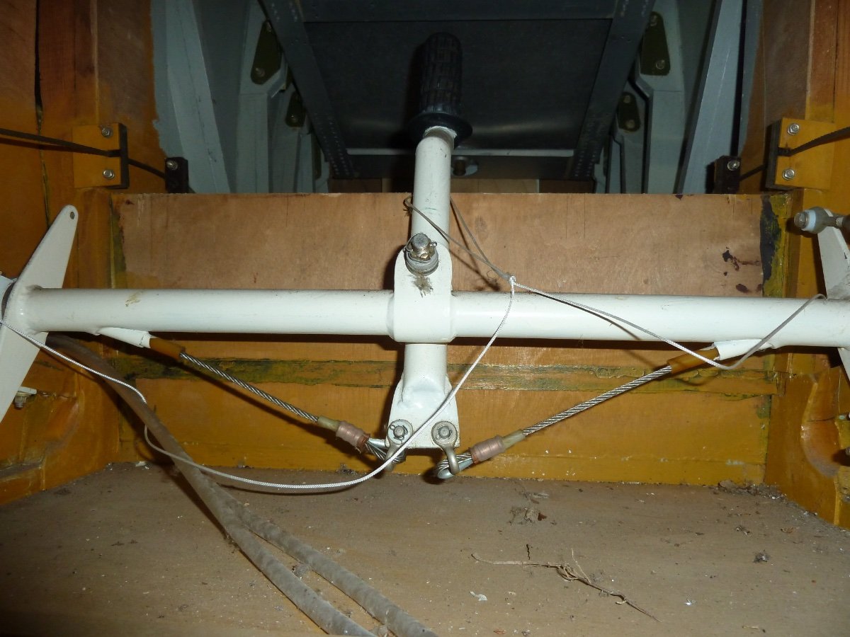

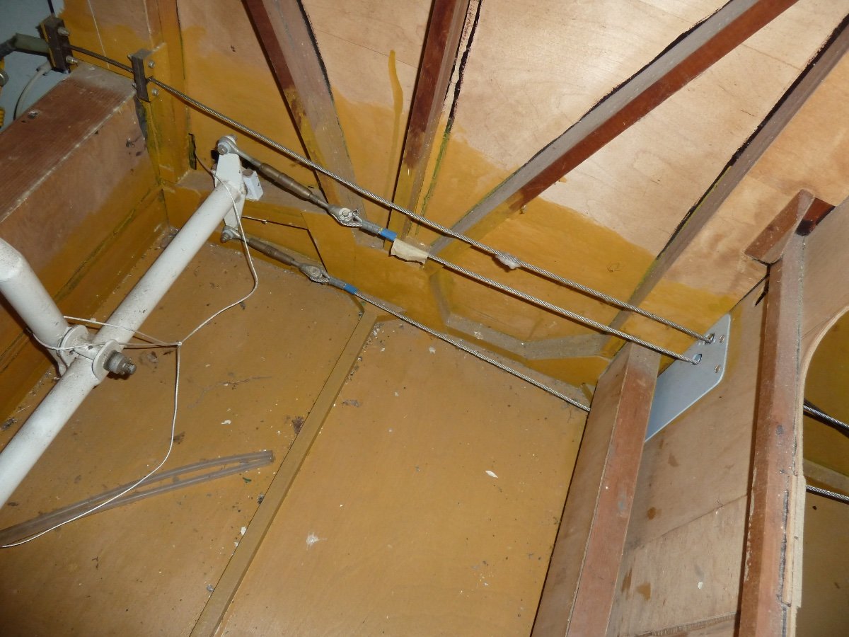

Teggles Posted December 20, 2024 Posted December 20, 2024 (edited) The rudder cables were - as you said straight forward. Elevator I am still working on, but I had a breakthrough when a friend sent me some pictures of the inside of his machine. Some angled pulleys has made for a neat system, so I will try to replicate that. He also had an issue with the aileron cables. As he moved the stick fore and aft the ailerons moved as the cable was tensioned. Both ailerons going up or down together. He has solved that by routing the cable from the bottom of the stick through the torque tube (picture attached). I am going for steam gauges, simple, reliable. Edited December 20, 2024 by Teggles 1 1
Don J Posted December 20, 2024 Posted December 20, 2024 (edited) Very interesting cable arrangement. Aileron cables arranged in torque tube look to be a problem solver. I would only study the over 90-degree return at pully of cable aft of rear spar ensuring no cable can touch under tension. Thumbs up Teggles Edited December 20, 2024 by Don J

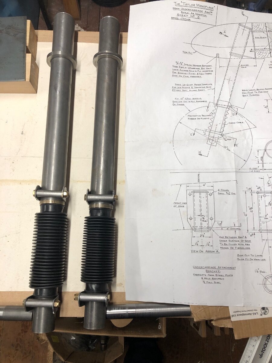

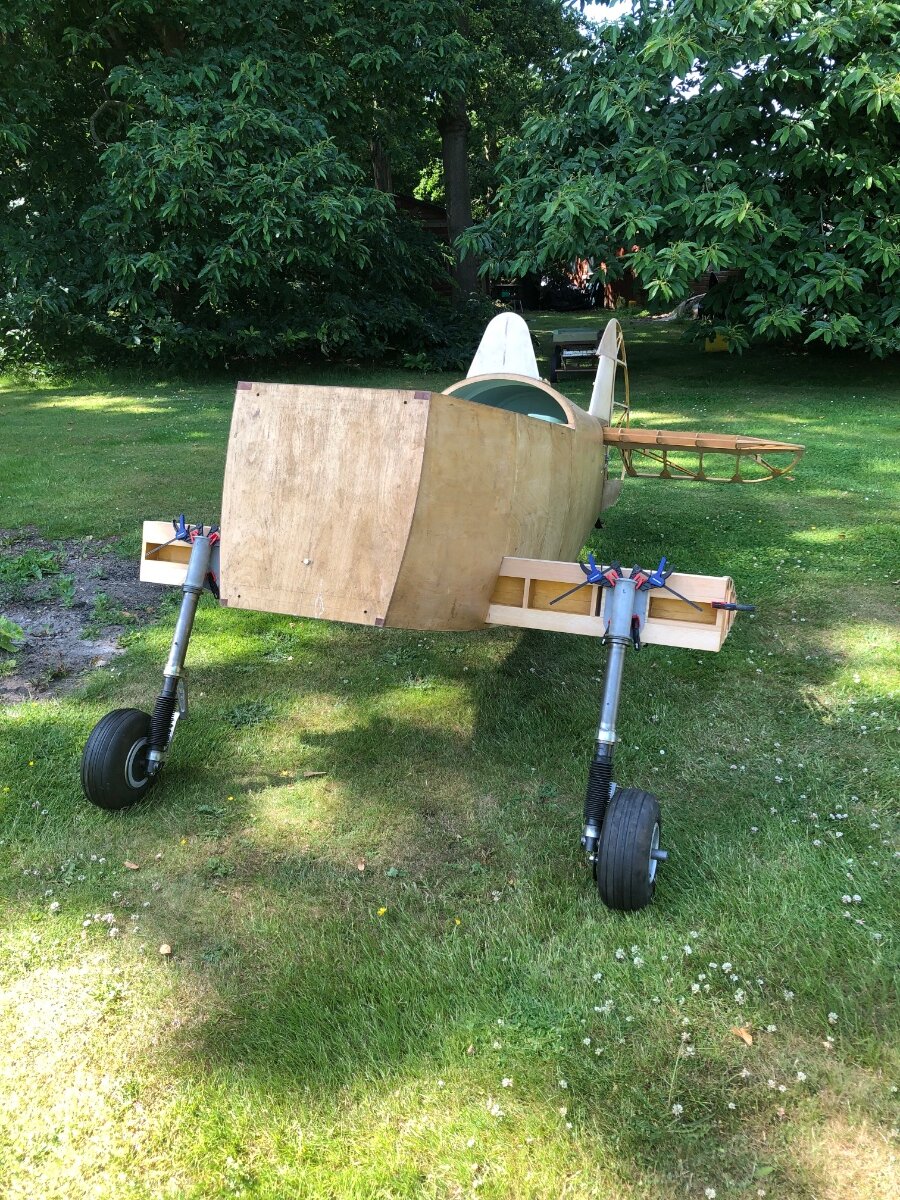

Teggles Posted January 14 Posted January 14 Just collected my legs from a local engineering firm. They have done a great job. Axles and torque links next and I will have a pair of undercarriage legs 😁 4 1
Don J Posted January 14 Posted January 14 Thats great Teggles. Keep at it and it won't be long, and you will be doing taxi runs.

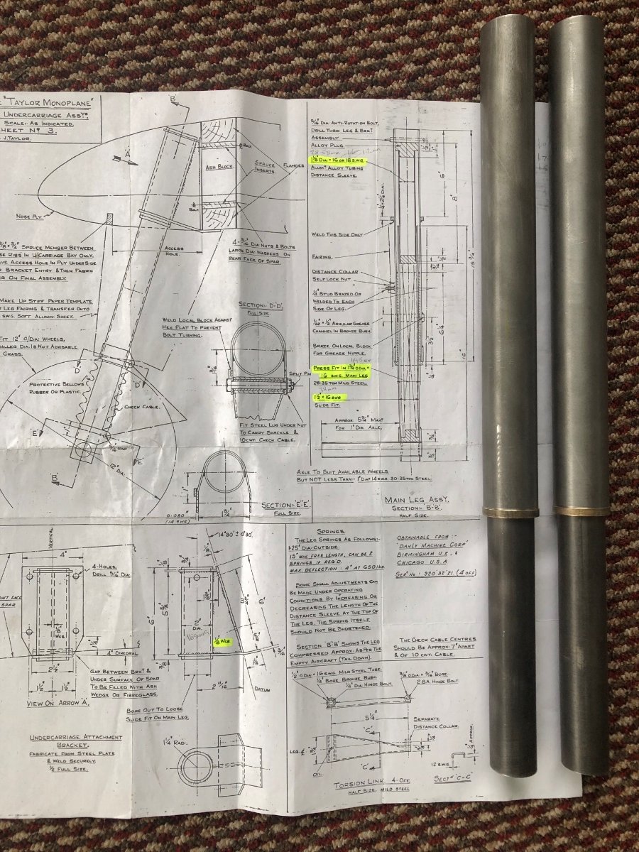

Teggles Posted March 22 Posted March 22 Productive couple of days in the workshop. Undercarriage stop rings, axles and torque link brackets all done. Soon it will be welding time. Just need to make the torque links. The brackets for the legs are with the welder now. After the torque links I need to assemble the centre spar and then I will have an aeroplane on its wheels 😁 7
facthunter Posted March 23 Posted March 23 I've got some good Motorcycle tele forks that would do that job wel, Damped and all. Are you using scissors Links? Nev
Teggles Posted April 6 Posted April 6 I may have sourced some links which have been CNC’d from an aluminium block, they look nice - but they haven’t come back to me with the cost 😬
Teggles Posted yesterday at 03:29 PM Posted yesterday at 03:29 PM Undercarriage mounting brackets. 14 deg +/- 30 mins! Just need to finish the centre spar. She will soon be on her legs. 5
Teggles Posted 13 hours ago Posted 13 hours ago Not by me! There is a company near me which makes replicas of historic cars, fantastic craftsmen and great welders. 1
