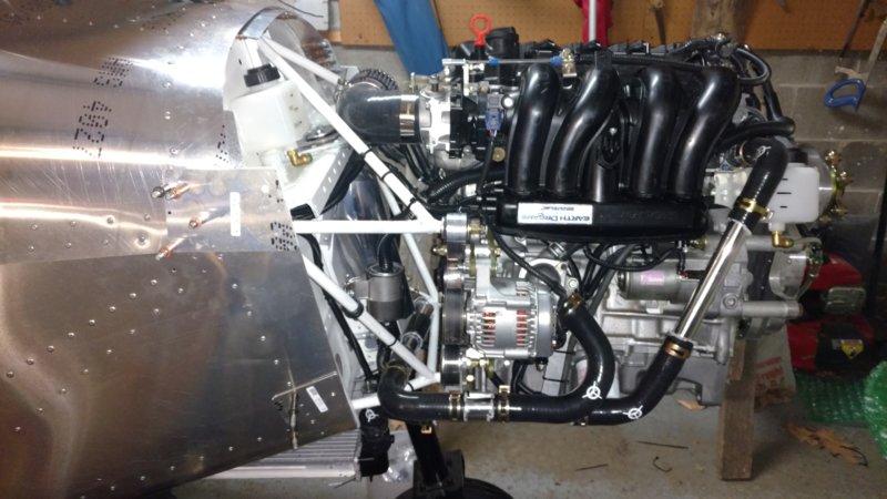

Savannah Karl Posted February 25, 2018 Author Posted February 25, 2018 Here is another view of that engine. 3
Kyle Communications Posted February 25, 2018 Posted February 25, 2018 Holy crap..80Kts (Hank) is going to love you. Have you run the viking yet...and do yo know the actual installed weight inc all coolers and liquids

Savannah Karl Posted February 25, 2018 Author Posted February 25, 2018 Holy crap..80Kts (Hank) is going to love you. Have you run the viking yet...and do yo know the actual installed weight inc all coolers and liquids Ha, not sure of the full wet weight but I weighed it when I got it and it was 224 pounds. That was with nothing installed. Although you can see its a pretty clean install.

Kyle Communications Posted February 25, 2018 Posted February 25, 2018 Do you have to have a new cowl?..I thought it may not fit in the original also did Jan make the engine mount for you
Savannah Karl Posted February 25, 2018 Author Posted February 25, 2018 We are all sitting back pondering on the Viking but the weight is the scarey thing...bare engine is 100kg !!!! add coolers and liquids maybe 120kg...thats a lot of weight out the front Yeah I'm pretty nervous about it also. I'm mounting as much equipment as I can as far aft as I can for that reason. I'll let you know how it turns out.

Savannah Karl Posted February 25, 2018 Author Posted February 25, 2018 Do you have to have a new cowl?..I thought it may not fit in the original also did Jan make the engine mount for you Jan did supply the engine mount. I'm using a 701 cowl. From my preliminary trials it looks like it will fit well. Maybe not as pretty as the new Savannah cowl though.
