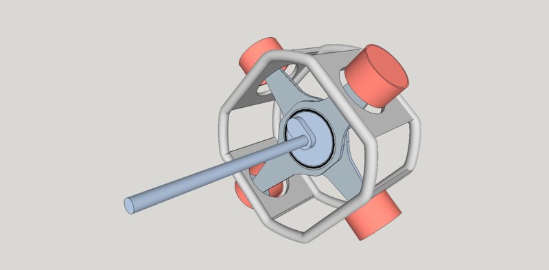

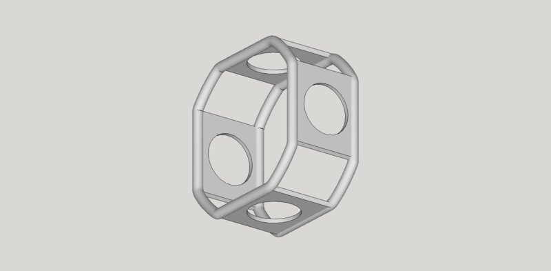

OK, back to the beginning. In my opening post I mentioned an engine I was theorizing about and I think I have enough modeled now to put my idea forward.

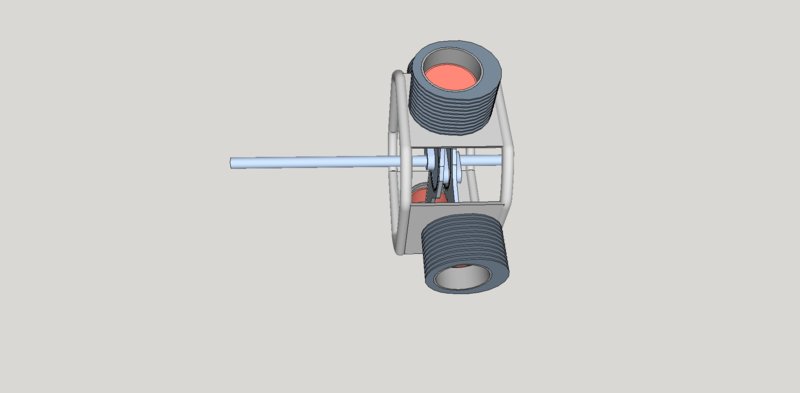

The basic idea is to minimize part count and weight. To this end, I've thrown out the crankcase, oil pump, filter and oil, plus valve push rods and rocker arms.. WHAT!
Let's start with a Balandin cross beam set-up and fit it with modern high speed, high temperature and sealed bearings.
There are several ways to make this work:
GrabCAD - CAD library

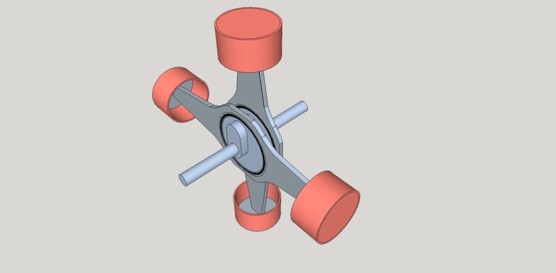

My version,
Mount it in a light ally space frame. I've left out center guides and end bearings for clarity.

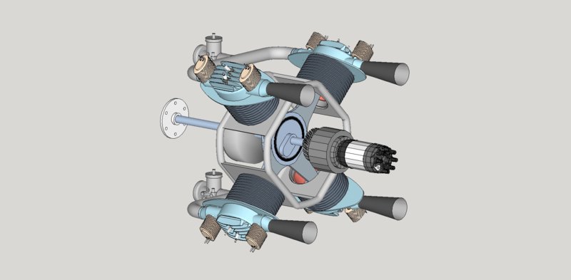

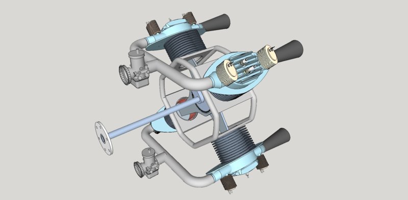

Add cylinders, note lengthened rear fin areas for better cooling.

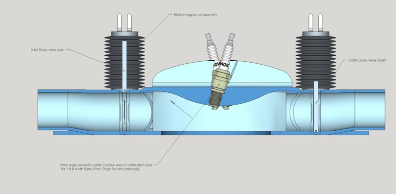

Now, this is where it gets interesting. Ever heard of the 'T' head design. Not used since way back when. It presents a pure cross-flow head and with the use of electronic 'sluice valves', presents no hindrance to gas flow what so ever.
1000493568_CompletTheadsystems.jpg.c5475c11704082064472dc6417a0486d.jpg So how does it work. Pretty clear really. An electronic timing system on the main shaft, controls the opening and shutting of the valves at the correct time. By manipulating the input pulses, the valves can be made to
operate extremely fast without over heating. I'll draw wave forms if you want it. As all components are open the the air-stream, cooling becomes a minor problem.
Cylinderhead-section.jpg.fbf53d52d347f584808caf2fd17746f9.jpg Of coarse, the valves have to have close tolerances and guides to ensure correct operation. As the engine fires, the valve plate would be pressed hard against it's outside face and help seal it.
Ignition could be a simple magneto or an alternator and distributor but in a different configuration.
54187-30f0f85955c19a94a3d024da3c7a8c15.jpg [ATTACH]54147[/ATTACH]
So there you have it. Ram air induction with A TWO STROKE MIX for upper cylinder lubrication.
Now, remember this is theoretical only, nothing is to scale and support plates have been omitted for clarity. The the question is, Fine in theory but will it work?

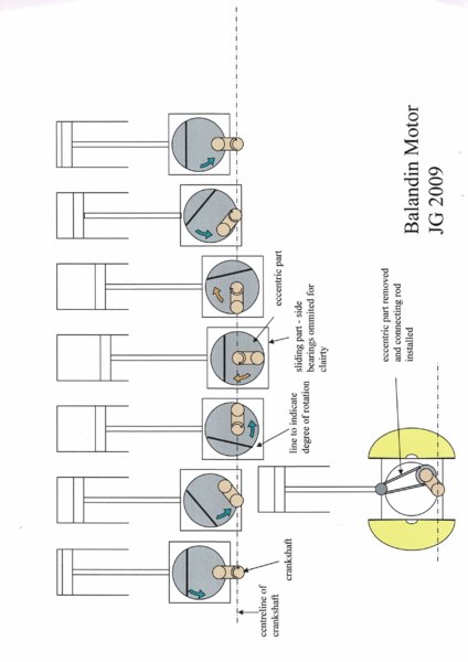

I'm sorry, Doug, I fail to see how the Balandin cross-beam system transfers its reciprocating motion to a rotary motion in the crankshaft. Does it use gear teeth on the crankshaft cranks?
The CAD drawing in the YouTube video is clumsily and badly drawn, and seriously lacking in fine engineering detail.
Is this the principle in the design?
Your cross-beam engine would benefit from dual combustion chambers top and bottom of the piston, resulting in a vast improvement in balance in operation, as well as power.
You are then only left with a sealing problem on the conrods for the lower combustion chamber.
I understand Balandin used this principle in an engine he designed in the early 1950's.
