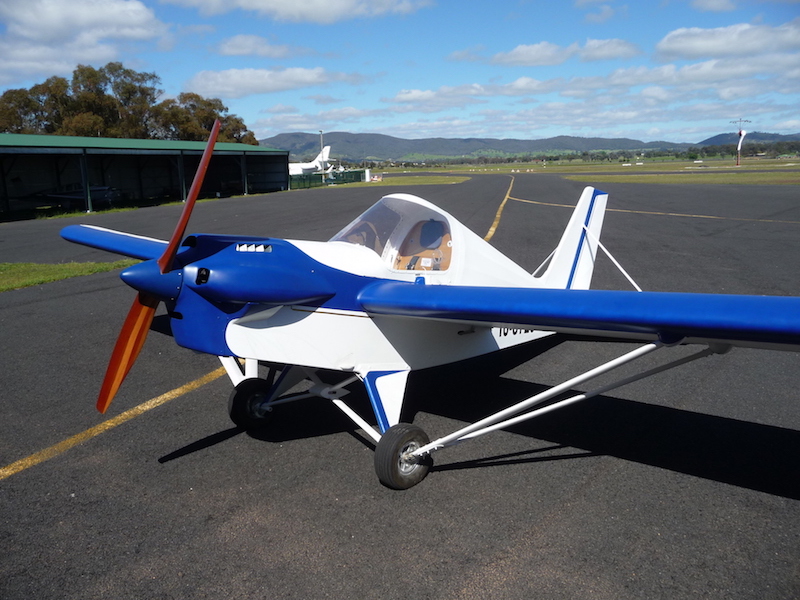

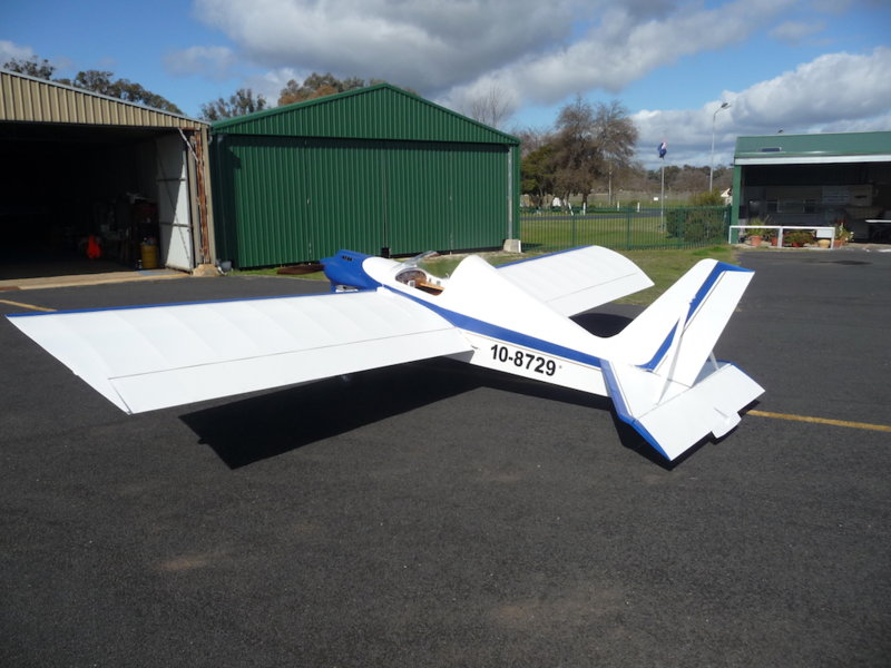

Soleair Posted April 3, 2018 Posted April 3, 2018 Good to hear from another Max builder/pilot, Markdun. I made both enclosed & open canopies, so I can choose whatever suits the season. My MZ engine puts out a conservative 60hp, while weighing 40kg, so I have good power loading (around 11lb/hp with 40 litres of fuel). My climb rate is around 1000 fpm. I have been careful to reduce drag with fairing whatever I can, & it has given me quite a good speed range. I cruise around 80mph, and stall about 35 mph - maybe a little less with flaps. As well as being a lot of fun to fly, these little planes can get into very short strips. You probably found you can do some very steep sideslips, which give an impressive rate of descent. Very handy for getting over trees bordering a short strip. Here's mine at Mudgee. Bruce
