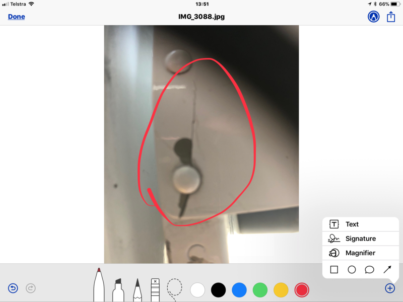

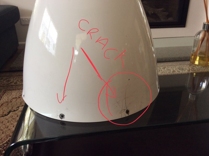

stevron Posted March 28, 2018 Posted March 28, 2018 As many will know I own a Brumby610 Lycoming powered model and I was wondering who loves their Brumby and who is not as happy and why? I have had a love hate relationship with mine to start with , it’s been a long haul and I have been frustrated by continual faults for which most have been rectified (eventually), that being said , I still find enjoyment to go for a fly . Last week I found a crack in my replacement prop spinner, both the nose cone and the mounting plate. Communication with the installer has not been effective to locate a new one as yet , I may have to go out side the current supplier to find replacement for the replacement, at this rate I would better buying 2 and keep one spare. So, Come on , let’s hear how the Brumby’s are standing to the rigours of time and use.

Mick Posted March 28, 2018 Posted March 28, 2018 That spinner cone looks like the bolt heads have worn into the fibreglass. Were there washers on those bolts?
bexrbetter Posted March 28, 2018 Posted March 28, 2018 Quote That spinner cone looks like the bolt heads have worn into the fibreglass. Were there washers on those bolts? Agree, use double washers, the largest diameter practical but thin, and a normal washer on that one to spread the load. Use crappy punched washers that have a predominate curved smooth side, and use that on the fiberglass surface.
Blueadventures Posted March 28, 2018 Posted March 28, 2018 Quote Agree, use double washers, the largest diameter practical but thin, and a normal washer on that one to spread the load. Use crappy punched washers that have a predominate curved smooth side, and use that on the fiberglass surface. I put thin nylon washers under most metal to fibreglass to reduce the chance of damage occurring.

stevron Posted March 28, 2018 Author Posted March 28, 2018 Good try on the bolt heads but that is/ was not the problem ,the problem was / is the front support did not fit properly and allowed the spinner to move through the torque of the engine and then the spinner was out of balance and that’s why it split the backing plate as well , yes the spinner was fitted with washers and it’s a spun metallic spinner

davidf Posted March 31, 2018 Posted March 31, 2018 You might try a dynamic prop balance also put nose con on a flat surface and see which way it rolls it will roll to heavy side, out of balance.

Raytol Posted April 1, 2018 Posted April 1, 2018 I always use the red fibre washers under the heads on a fibreglass spinner. Have not had a problem since doing it this way.

stevron Posted April 2, 2018 Author Posted April 2, 2018 Quote I always use the red fibre washers under the heads on a fibreglass spinner. Have not had a problem since doing it this way. Thanks , but I am having one made with better mounting system.
stevron Posted April 2, 2018 Author Posted April 2, 2018 Quote You might try a dynamic prop balance also put nose con on a flat surface and see which way it rolls it will roll to heavy side, out of balance. I will electronically balance the whole system when I refit the new unit ,I wish it had been from the start as it would have saved time and money
