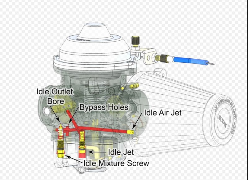

Downunder Posted April 9, 2018 Share Posted April 9, 2018 When idled too long it is common for the FRONT cylinder plugs to start to foul. The way the manifold is orientated tends to be the cause. However a higher rpm run generally clears them. And as above, just replace the problem one if needed. They are cheap. ULS is NGK DCPR8E. Make sure it is the (4339) version. This has removable terminals. You might want to check the idle mixture screw. I have heard of these "wandering" out occasionally. It is easy to do. The "idle mixture screw" should be 1 and 1/2 turns OUT from full in (Rotax spec). I have heard of some people running 2 turns out, saying idle and low rpm is smoother. You might also want to check your needle clip setting. The lower the clip position (4 positions), the richer the mix. This mainly affects mid rpm settings. If you are a "Rotax owner" member you can watch the full video. Link to comment Share on other sites More sharing options...

Jumbo jet Posted April 14, 2018 Share Posted April 14, 2018 B, please take my advice, I work on these 912 engines, plug fouling on Mogas is rare if u have a healthy engine so u have a problem, either u have a tired old engine and it’s burning oil or its over rich which can be caused by a too rich idle mixture setting, worn jet and jet needle or just tired old carbs, carbs should be overhauled at the 5 yearly rubber replacement or no later than 1000 hours, now when I say overhauled this is a complete strip down and all parts cleaned in an ultrasonic cleaner and needle jet, jet, circlip and o ring replaced and check that the mixture enriching device ( choke ) is returning to off and the tiny dot on the choke shaft is pointing towards the cable. Set idle mixture screw to 1.5 turns out and have main needle jet circlip on second from the bottom groove. If u believe you have a good engine, first buy a set of plugs from Bert Floods, DONT SKIMP HERE as they properly gapped and have the proper heat paste applied, set the idle mixture at 1.75 turns out, don’t excessively slow idle the engine on warm up and give that a try, if it still cacks up plugs the problem might be as mentioned above, this is a starting point for u.. Good Luck. Link to comment Share on other sites More sharing options...
