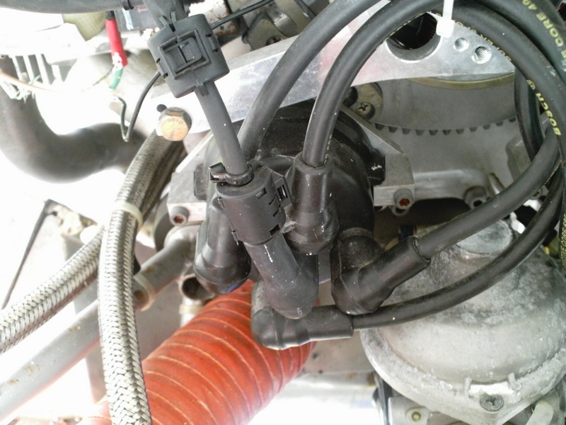

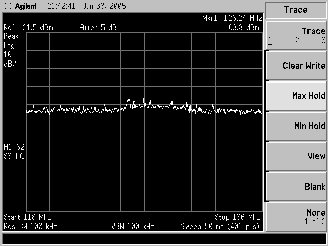

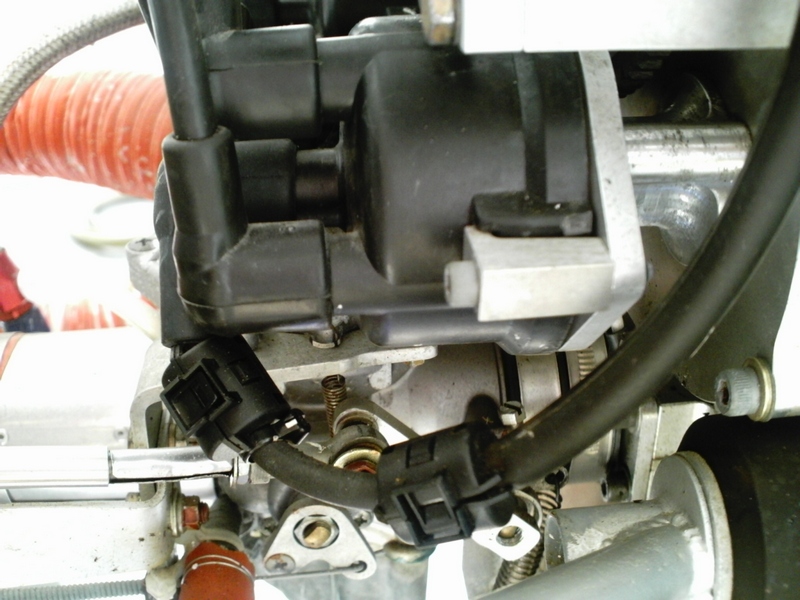

I did extensive tests on my 2200 and compaqred results from others at the time. Wrote the results up on the Yahoo group forums, attaching a copy here.
The main thing which has changed is Jabiru switched to inductive HT leads although they might not be the same type which I recommend. Owners in the UK are getting Magnecore leads made to their requirements. In NZ / Oz we can buy the bosh ones at Supercheapautos.
