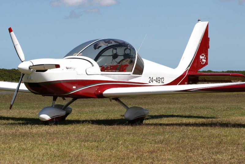

BirdDog Posted April 23, 2018 Posted April 23, 2018 I have no idea on that question! Mine came factory fitted. I cruise nicely in calm air at about 5300rpm, WOT at about 115kts
Paul davenport Posted April 23, 2018 Posted April 23, 2018 And what is a sporty ? What does it look like? I would like to know what difference it would make to my j230. Spending up to $13000 to find out it’s ,not as good as the sales puff would hurt
Paul davenport Posted April 23, 2018 Posted April 23, 2018 Very nice. Mates father had one and loved the full fine decent rate
BirdDog Posted April 23, 2018 Posted April 23, 2018 Thanks and Yeah - she is certainly a nice machine to fly.
Paul davenport Posted April 23, 2018 Posted April 23, 2018 You can park it in my hanger any time you like. Flew on in Shepparton once with Peter Harlow from memory it was well balanced
BirdDog Posted April 23, 2018 Posted April 23, 2018 They fly amazingly well. Very stable and very predictable. Comfy enough, although I would love some higher backed seats. But that would restrict access to the storage behind the pilots.
