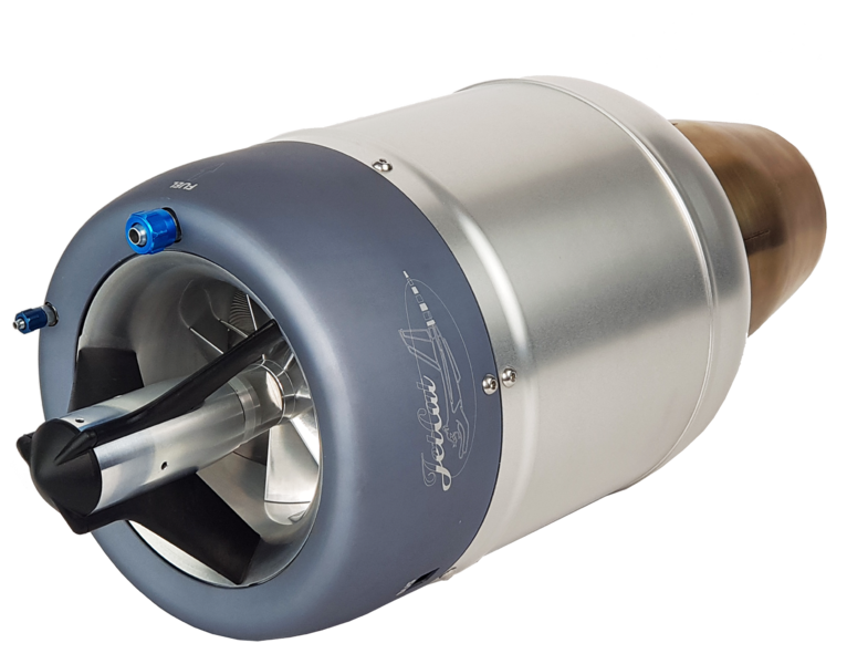

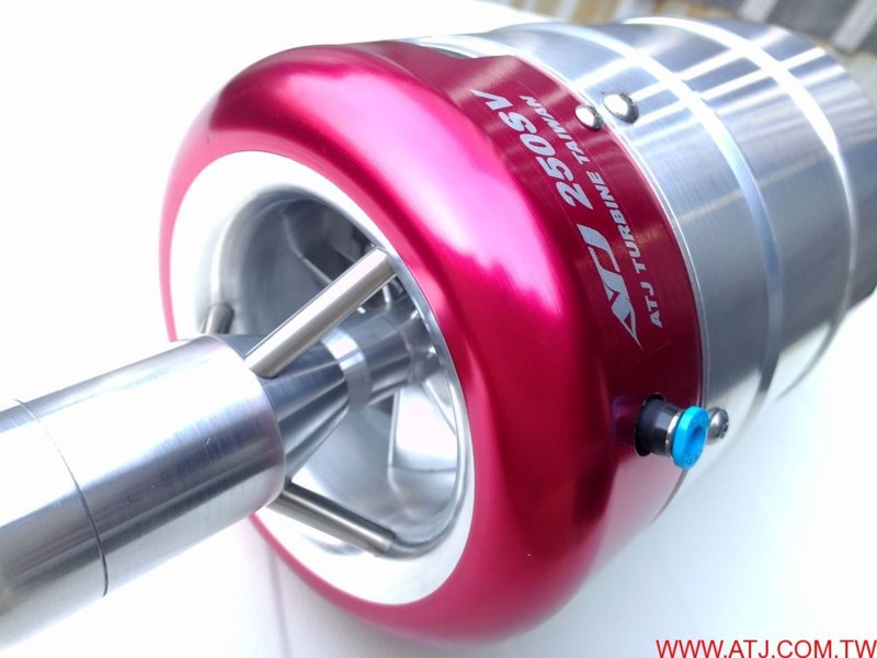

kasper Posted April 16, 2018 Posted April 16, 2018 No - if you used a sapphire not particularly fast - probably only around the 100kt mark. But if you went for a flying wing new build and went for something along the lines of a Jetcat 550N Single Or a couple of much cheaper engines in the 240-250N range like the ATJ 250SV In any event the cost of the jetcat pays for 3 of the ATJs but still cost less than a 912 80hp even before you buy the prop

kasper Posted April 16, 2018 Posted April 16, 2018 There is a twin jet cri cri that operates out of YSEN. And it sounds awesome! I think it uses engines similar to the ones above. I guess much smaller versions than even the 250N ones ... cri cri flies on twin 12-15hp ... 245N is similar in total thrust to around 30hp

Downunder Posted April 16, 2018 Posted April 16, 2018 So...I guess an Aerolite would fit nicely within our 95.10 regs? An Aerolite 103 is 88kg without engine..(my calcs, 106 kg less 18 kg for the Hirth). 24 kg/m2 at MTOW 272 kg. (Whether the owner wants to push it to 300 is up for debate but I'm guessing wing loading is still under 30) What would you be looking at in costs of turbines? A couple of these ATJ 250's are looking like 10 to 12 grand aussie fitted to me. Any "ball park" conversions of thrust Vs horsepower? I'm a bit confused about that. Would a single jet me more efficient overall fuel wise? Perhaps weight wise as well.
kasper Posted April 17, 2018 Posted April 17, 2018 So...I guess an Aerolite would fit nicely within our 95.10 regs?An Aerolite 103 is 88kg without engine..(my calcs, 106 kg less 18 kg for the Hirth). 24 kg/m2 at MTOW 272 kg. (Whether the owner wants to push it to 300 is up for debate but I'm guessing wing loading is still under 30)What would you be looking at in costs of turbines? A couple of these ATJ 250's are looking like 10 to 12 grand aussie fitted to me. Any "ball park" conversions of thrust Vs horsepower? I'm a bit confused about that. Would a single jet me more efficient overall fuel wise? Perhaps weight wise as well. Ok. The atj 250 are new and quite pricey. The ATJ220SV are under $4,300 each delivered with gst paid ready to install with all controllers.One thing to be very careful of - because RAAus and/or CASA will start patrolling it is that you cannot register a new 95.10 that came from a kit unless that kit is an approved kit ... and there are no approved kits. So if you’re looking to do a bit of getting around you are really limited to buying an existing 95.10 airframe and modifying it or designing and building from scratch. And 95.10 if fully enforced would even see minimaxes and other plans built refused rego because they are not approved plans. 95.10 is for self design and self build for all new registrations. Be very causious of trying to tap dance around it with anything that comes from a factory because If CASA audit the 95.10 register there are quite a few that would fall into cancelled registration and needing to move to 95.55 ... and you can’t take a jet or multi engines airframe into that register. .
