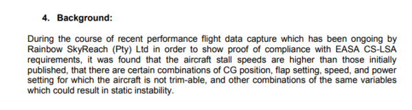

danny_galaga Posted June 2, 2021 Posted June 2, 2021 (edited) Just thought I'd update about the stall fix kit, for want of a better word. It is extremely comprehensive, not just a bag of vortex generators as was the speculation. The tailplane surfaces are all larger, and come pre covered. The trim tab is much more aerodynamic now, being a build up aluminium affair with appropriate thickness as opposed to just a flat metal plate. Trim Lever is also more substantial to allow for more movement. The rudder has an anti balance tab now as well. Vertical stab is a bit taller, and there is a small dorsal fin. There is also a very nice pitot tube to allow for more accurate airspeed readings. It also has a static tube as well, there wasn't one before. There are some aluminium fences for the ailerons. There are also some fuselage brackets that need updating, I assume because of the different loadings caused by the new empennage. Also all stickers that may need to be updated due to the changes. And a fuel filler kit so you can fill up from outside the aircraft. Every single thing that needs to be replaced is in the kit, down to the last nut, lace and cable tie. Edited June 2, 2021 by danny_galaga 1 2
