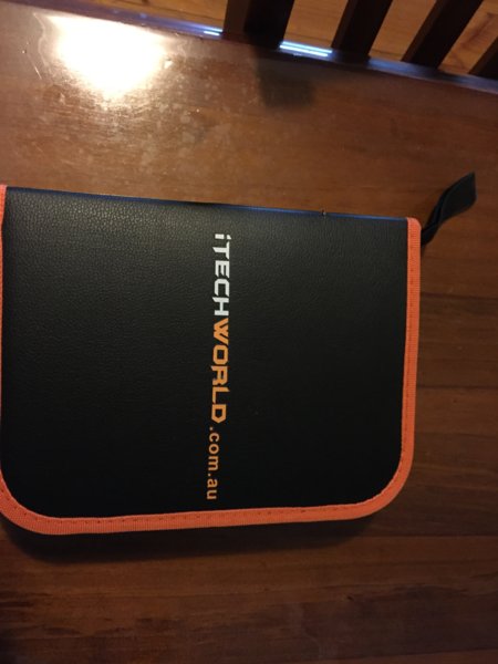

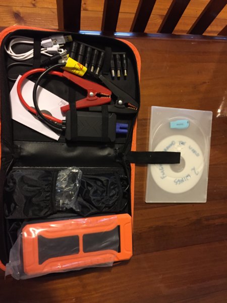

alf jessup Posted May 1, 2018 Posted May 1, 2018 I left the master switch on for a fortnight. (Yes, I know, kick me!) Will my Odyssey battery recover or should I just get a new (expensive!) one?I don't want to have it suddenly die away from my home field. I have recharged it and it seems alright.Battery is marked 2011 manufacture, but it has been going fine. PMMcI think your battery will be fine with a recharge, Oddesys are a good battery. Buy yourself a ITech 900cca jumper pack Not much bigger than a IPhone 8 and can start a 5lt Diesel over 30 times before a recharge is required. Comes with USB ports for iPad & phone charging, 12v & 240v chargers in a nice carry case. Will run a Engle fridge for up to 10 hrs on one charge All up weighs about 800 grams $249 off the net delivered WA company I got one works well and takes up no room in the plane

jetjr Posted May 2, 2018 Posted May 2, 2018 "ITech 900cca jumper pack" These are most likely a Lithium ION POLYMER battery type, prone to catching fire even when being stored and I don't think suited to being carried in aircraft. Look up LIPO battery fire on youtube. Previous discussion on here about the difference between these LIPO and Lithium IRON batteries (LiFE) which are much safer After saying all that they are a great bit of kit and despite the warnings the technology is no doubt improving. Problem was something to do with cell isolating materials which could be damaged, starting fire, It cannot be extinguished.

spacesailor Posted May 6, 2018 Posted May 6, 2018 I bought a 900 cca jumper pack The 1st time practice use On a diesel, the wires over-heated & dropped off, Quick replacement when returned tho. Still have the replacement but have reservations about using it. spacesailor
jetjr Posted May 6, 2018 Posted May 6, 2018 The CCA rating is pretty misleading, no way the supplied leads can provide power, 900 cca, to a really flat battery and start the engine instructions often say to leave connected for a while then start. Luckily most situations where engine wont start arent a dead flat battery Jabiru need a high crank speed - near full voltage- to start. In this case jumper pack would work well. trouble is if theres a battery problem like short or collapsed cell this will waste jumper pack power too
spacesailor Posted May 6, 2018 Posted May 6, 2018 MY DIESEL needs pre-heating, which drains any residue from a suspect battery, making cranking slow. When I connected the "jump-start" I switched on the pre-heater, then cranked. But it didn't crank as the leads fell-off. I would like to try a small "LIFE" battery to see if it could work any better than a Lithium ION POLYMER battery. The vehicle battery is 140 cca, ( two 70zz battery's), Lots smaller than a 900 cca Lipo battery. spacesailor
