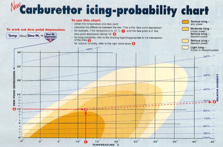

drifter_driver Posted December 30, 2007 Posted December 30, 2007 do you have oil injection on your 503 or use pre-mixing chris ? if using oil injection more chances of having carby icing even at 80% power settings under certain temp. and humidity conditions
bushpilot Posted December 30, 2007 Author Posted December 30, 2007 I pre-mix. No injection. As for conditions: 20oC at 8:15am; clear skies; Easterly breeze at say 5kts; felt fairly humid.. Air a bit lumpy and felt about 2 - 3oC cooler than ground level temp, at 2,000AGL.

bushpilot Posted December 30, 2007 Author Posted December 30, 2007 do you have oil injection on your 503 or use pre-mixing chris ? if using oil injection more chances of having carby icing even at 80% power settings under certain temp. and humidity conditions Just studied this chart more closely; it's a gem. Thanks. What's the easiest way to measure dew point? Although it seems that it does not change the 'intersection' point all that much; and in practice I cant see pilots checking the dew point b4 each flight.... So I guess a more simple assessment of temp and humidity is going to provide a clue to chance of icing..
drifter_driver Posted December 31, 2007 Posted December 31, 2007 Hi Chris, its easier to use humidity scale vs temperature on the chart as opposed to dew point depression. Relative humidity is shown on right hand side (blue tangent lines) on chart. however if u r keen on dew point measurement u can use the following crude method. scrap off the paint of a can of coke using sandpaper, cut the top section and put some water and ice in it. stir it with a thermometer(u can add salt to melt the ice quicker), when u see the condensation start to build on the outside of can, note the temp in thermometer. this is your dew point temp. cheers
