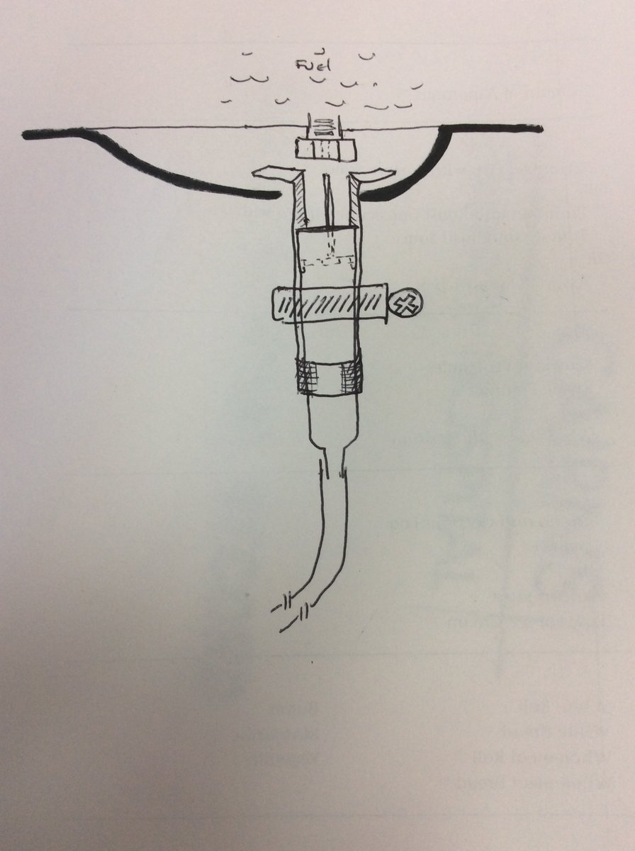

Jaba-who Posted May 18, 2018 Posted May 18, 2018 If that’s the type you are after you can get them from aircraft spruce. I got one ages ago to put in the oil drain so I didn’t have to cut the lock wire etc every time. Works very well. But as for a fuel drain. Not sure if you are building and primarily inserting or if you are trying to retrofit one to the drain. Sounds like the aircraft is already built so may not be able to fit them now. The drains were already in the tanks ( when I built mine) already installed at the factory. I don’t know if they can easily be removed and replaced with new drains. The drains I have in mine came with the kit and to take a fuel drain sample require a spike to go into the spring loaded closure part of the valve and then to make everything more complicated all of these are hidden under the drag reducing fairing. What i I have done is made a modified fuel drain - the type you buy from pilot supply shops to check fuel for water and I made an aluminium collar with two lugs at the top which can slot in through the hole in the fairing and hook in the fairing. The spike is pushed into the valve and then a hose clamp around the outside of the lot is screwed up and holds the collar and lugs in place while the spike is pushed against the valve. The body of the drain is then epoxied onto a spout which has a flexible bit of clear hose attached. Scale not quite right but I’m sure you get my point. The spike length and the outer tube of the drain are such that in the the tube is almost fully surrounding the hole where fuel comes out. But doesn’t seal it. Fuel runs freely down drain hose but have to be careful not to kink hose because the drain will still run and overflow at the top if hose outflow is blocked. You get used to the nuances and it worked well. I can use it drain indivual tanks or the header tank under seat ( or all tanks simultaneously if you open all the taps - my model is one of the earlier ones where each tank has its own in line tap as well a single one near fuel pump that cuts off all together.
