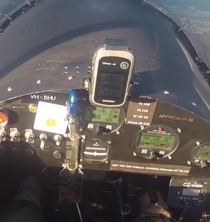

peter Posted May 25, 2018 Posted May 25, 2018 Actually a magnetic compass is not that simple, you need to accurately swing the compass , which needs to be done with the engine running at various speeds and on a range of headings. Where you position it can be critical. Hence the development of gyroscopic heading devices. An accurate magnetic compass is expensive. A compass provides heading but not track. A 100 dollar Garmin etrex will give accurate track, can be mounted easily, (just needs to “see” the sky). It needs no ongoing adjustment. Cheers Peter
danny_galaga Posted May 25, 2018 Author Posted May 25, 2018 Just checked out the etrex. That’s a pretty cheap ‘piece of mind’ device will probably keep one of those stashed away since it can go 25 hours on two AA batteries But I will still mount a compass

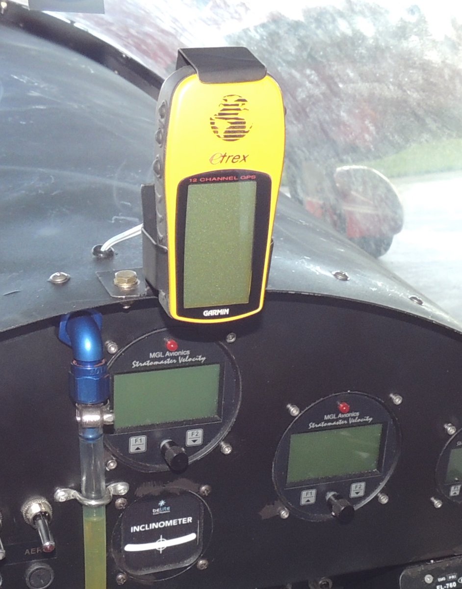

peter Posted May 25, 2018 Posted May 25, 2018 Go for it! At least with the etrex around you can monitor the lack of accuracy of your magnetic compass! My etrex is 16 years old and has guided me safely through white outs in Antarctica and heavy fog in the Arctic, places where magnetic variation can be as much as 80degrees, as well as all my flying here in Oz so I'm pretty biased. Have you swung a compass before? Cheers Peter PS congrats on the build and keep us updated PPS don't believe the 25 hours, depends on screen settings and ambient temp, spare batteries are pretty cheap PPPs having a GPS continuously tracking where you came from is also pretty comforting when dodging showers which is why I like to have the phone GPS as well!
spacesailor Posted May 25, 2018 Posted May 25, 2018 Hi Peter. Which model of etrex is yours. A quick check of ebay shows different models. spacesailor
peter Posted May 25, 2018 Posted May 25, 2018 The yellow one is the original and still works perfectly but I wanted to go hi tech with a colour screen hence the new one. The new one also has built in magnetic compass, cheers Peter
