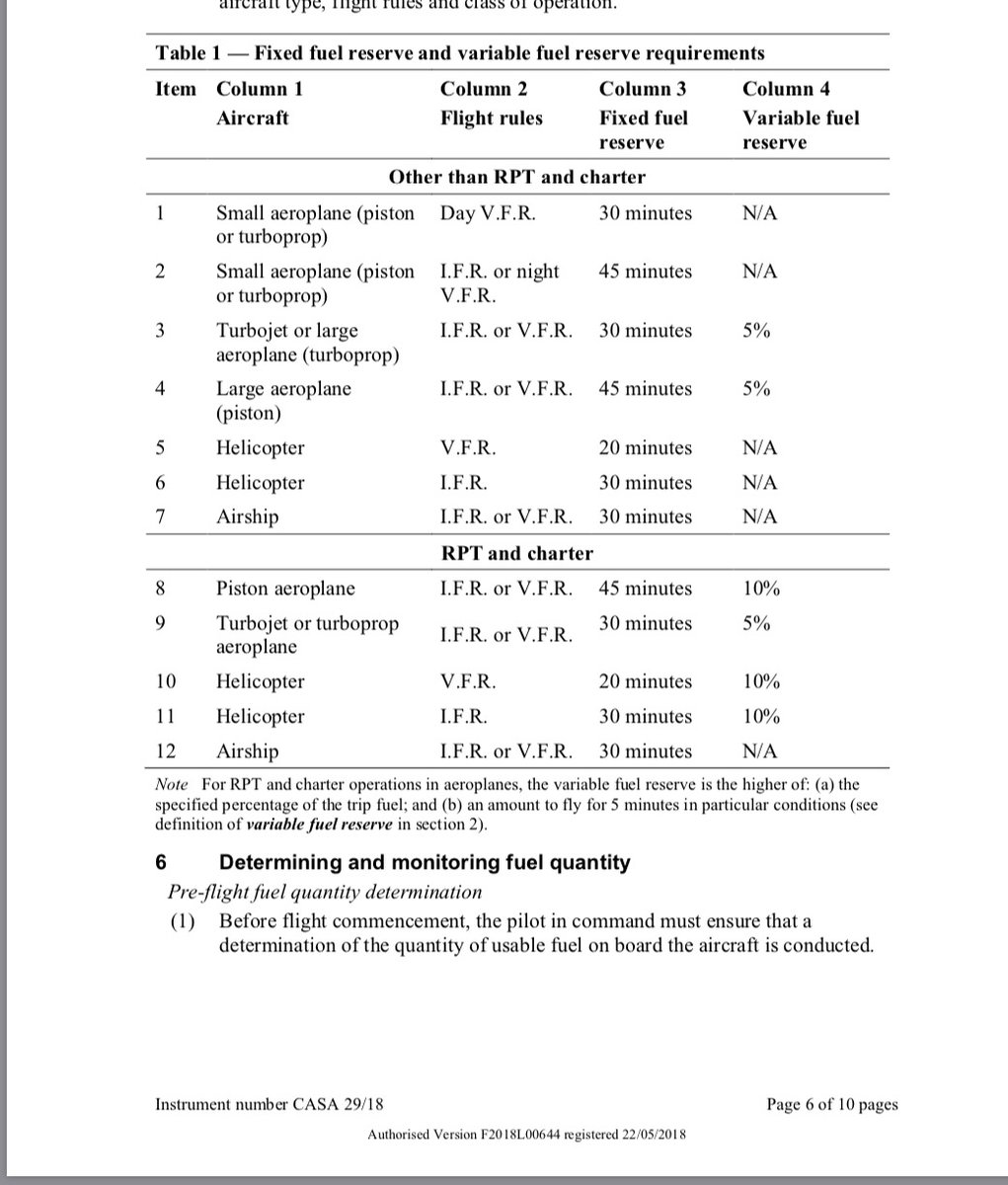

poteroo Posted May 27, 2018 Posted May 27, 2018 variable reserve ( I don’t recall exactly what the variable requirement is as I’m not commercial) 15% of the 'flight fuel' in your plan. We took this to include allowances for taxying, run-ups, and circuits at departure and arrival. i work on 60 minutes notional reserve because I have an antiquated float gauge on the top tank and none in the belly, and I don’t have a fuel flow instrument. That's a very sensible practice Kaz. Gauges are not to be trusted. The only time I'm inclined to 'believe' them is when they appear motionless against the E mark! I did finally fly my old C170 to complete fuel exhaustion one day - there was 20 mins flying left in the tanks after the gauges ceased a flicker of movement! That was somewhat comforting. I increase my reserves the longer the actual flight too. So, if doing a private flight over 3 hrs - I use 60 mins fixed reserve. The further one flys - the greater the likelihood of a weather change, especially along the southern Australian coast in winter and spring. happy days,

facthunter Posted May 28, 2018 Posted May 28, 2018 The question of using the reserve has often been a subject for consideration and debate, by pilots and legislators. Obviously you carry it in case you need it. as part of your planning responsibilities, BY LAW. in response to a "known" or forecast. possibility.. Sometimes you will land with reserves intact. Sometimes you will get more tailwind than forecast and your unused reserves plus some will still be on board. 10% of flight fuel and 30 minutes on other occasions may not be enough. It's easy to use the extra 10% of flight fuel with adverse winds or ice etc IF you use your reserves en route and CAN divert to somewhere suitable and don't do it to preserve/regain a legal reserve you are negligent. At the end of the trip, If a plane becomes disabled on the ONLY strip there, the 30 minutes to DRY won't give you a lot of options. This is for bigger planes with more stringent requirements on runways. Length width and pavement strength. Different aircraft have different considerations with low fuel operations. (Pitch and acceleration limitations). The pilot is required to know all this and operate the aircraft safely. The over riding consideration is that you operate in the safest manner open to you. That will be the issue if you end up in court. You are not required to operate to the minimum fuel requirements. You are the PIC of your U/L. If you are out of fuel the best of engines won't be any good to you, and the aerodrome you can't quite reach may as well be on the moon. This one sat for a while. I got called away. Hope it's still relevant. Nev
Yenn Posted May 28, 2018 Posted May 28, 2018 As far as it affects us I think the 30 min reserve is OK, like others I have always kept to a 45 min reserve. The silly side of CASA is the use of mayday and I predict that it will be amended when someone in CASA with some common sense wakes up. If you don't like what CASA does there is nothing stopping you from telling them so. I have done it in the past and there have been no repercussions. It may even wake them up.

dsam Posted May 28, 2018 Posted May 28, 2018 I plan my recreational outback flights with 45 minutes reserve, and a 10% variable reserve (due to the winds aloft “forecast” issue mentioned by Jabba-who). My Dynon Skyview gives me real-time data on wind & direction right from my initial climb all the way to my planned cruising altitude. I write this “measured wind” data down for each valid cruise altitude for my intended track. I find that 10% wind variation applies quite often, and I regularly choose a different, more favourable altitude to the one from the forecast. Throughout my flight the Dynon reports calculated range in real-time (ie allowing for actual wind & measured fuel flow). I’ve never found myself caught out with fuel range & reserve issues thanks to all this technology (and yes I fly with considerable redundancy in this technology). I also have a visable tube showing the fuel level of each wing tank for absolute certainty, so the Dynon could fail and I still know what is going on with fuel levels. Yes the old fashioned tried-and true ways can work as well, but I prefer the accuracy and labour saving of all my modern devices.

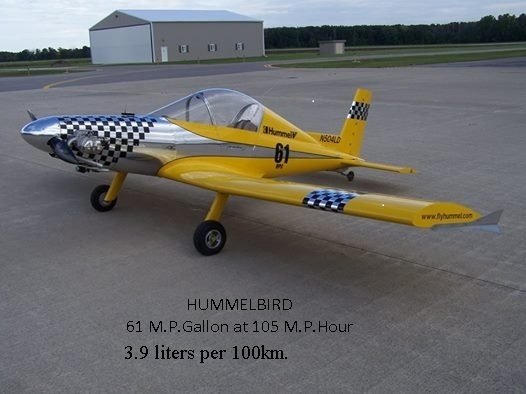

spacesailor Posted May 28, 2018 Posted May 28, 2018 " How much of that 30 mins do you actually have left? How imminent is "imminent" At four litres p hour leaves about two litres. LoL. spacesailor

turboplanner Posted May 29, 2018 Posted May 29, 2018 It was a regulation for GA. I don’t know about RAAus. Private ops had to have 45 mind reserve and commercial ops had to have 45 mins plus a variable reserve ( I don’t recall exactly what the variable requirement is as I’m not commercial) then on top of that if the destination airport has an INTER weather forecast then need 30 mins extra and if a TEMPO then you need and extra 60 minutes reserve. The diffrence now is that once you reach your reserve you have to tell the world about it by calling Mayday! Before this you could just quietly use your reserve knowing that you had it for a reason. Perhaps too many people who quietly used the reserve had too many discovered incidents perhaps even stuffed up the forced landings and produced some real statistics. I think the Mayday call has been introduced for Airservices, so they can trigger a full priority for the aircraft. You only have to read through this thread to see the reluctance to call a Mayday or even a Pan. In that case, how would a CTA tower controller know to give you preference to other aircraft. I've mentioned a classic case before where a pilot was unable to get into his home field not far from Moorabbin few years ago, o he came on down only to be told by the tower that the airfield was closed due to weather, so he turned away and went looking for other alternatives, so he returned to Moorabbin, now very short of fuel. The Tower controller told him the airport was closed, they got into an argument which ended with him saying he was coming in whether it was closed or not! He knew he was out of fuel and stressed beyond recognition, but he hadn't told the tower controller. The ATSB after investigating the incident pointed out that the pilot could have landed at Moorabbin the first time, rather than risk his life running out of fuel, if only he'd called a Mayday On receiving that call the tower controller and services would have immediately done their best to assist him down. This change trips that switch, making things safer for the pilot. As someone said, the Pilot then has to go through the paperworkmill. However, anyone getting into a situation with less than 30 minutes fuel left deserves to have to explain himself. I can understand to thinking of guys here who mainly fly local, but even if a person flight planned a three hour flight leg, and logged fuel burn every ten minutes, flights often encounter issues like wind strength/direction, engine tuning problems, redirection for some reason, and GA aircraft have big tanks that allow you enough safety margin to virtually never put yourself into this 30 minute situation. Some people just can't help themselves and wing it, and I guess this regulation provides more of an incentive not to make a fool of yourself.
