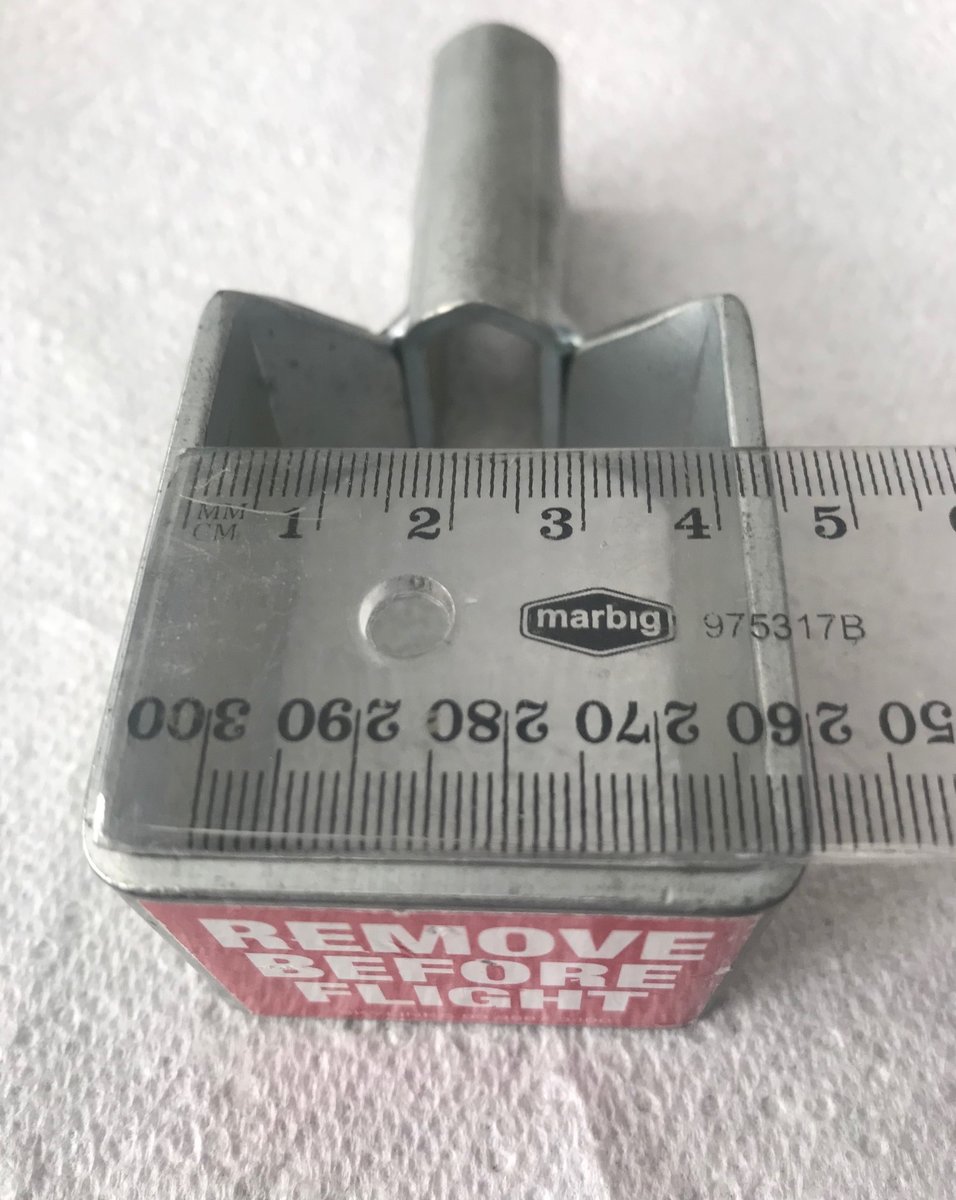

BirdDog Posted June 4, 2018 Posted June 4, 2018 Hey All, I am trying to find a Throttle Lock that will fit my Evektor Sportstar. The ones I have found don't fit my vernier type throttle. The Sportstars have a rather big end on them, and the locks I have experience simply don't fit around the throttle. It misses out by about 5mm or so. Not much, but enough! Looking for anything available commercially, or ideas to make my own. Cheers J

BirdDog Posted June 4, 2018 Author Posted June 4, 2018 I have one very similar that I bought, but it does not fit. What aircraft did you fit it to?
djpacro Posted June 4, 2018 Posted June 4, 2018 I had the smaller one previously for my Decathlon - this wider one fits the vernier mixture on my Super Decathlon.
BirdDog Posted June 4, 2018 Author Posted June 4, 2018 Yep! That's the same size as the one I have - about a 42mm internal. My throttle knob needs about 5mm more. I might have to Fab something up me thinks.

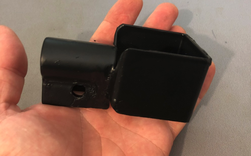

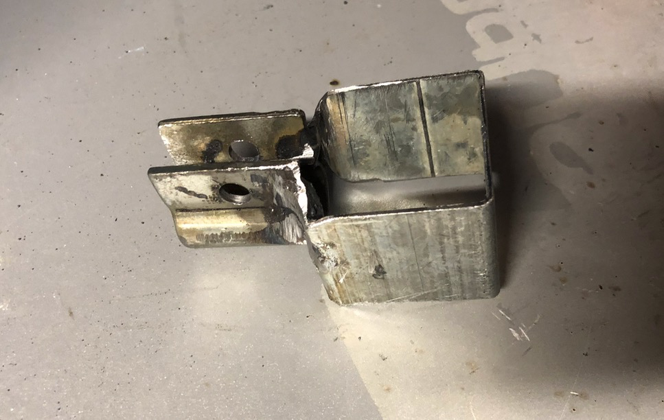

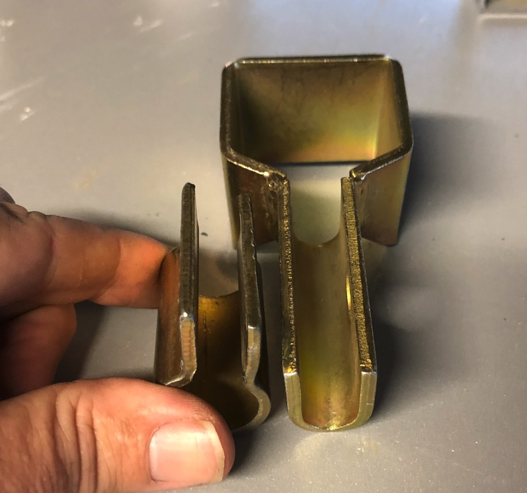

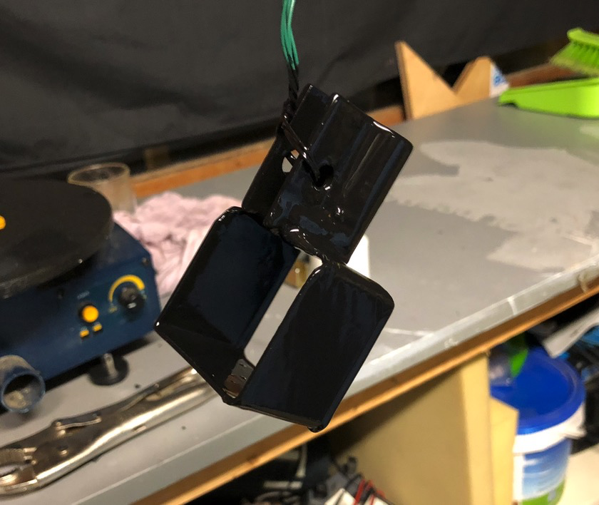

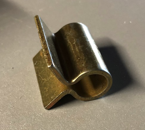

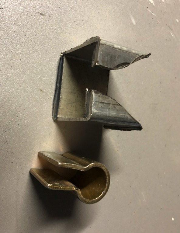

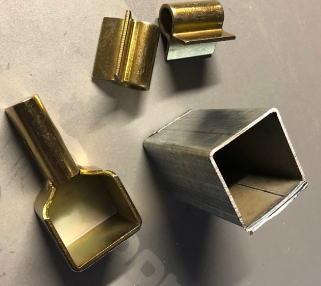

BirdDog Posted June 5, 2018 Author Posted June 5, 2018 Yeah thanks, but I am not wanting to carry any more unnecessary weight in the bird, so I made my own. Total cost $4.00 Local steel bloke gave me an off cut of 50mm square section. The bottom left is the throttle lock that I bought and does not fit and I bought 2 x Hinge Pin Locaters that look like they can be easily manipulated. Re-shapped and I think it will do the job! Square section cut, and ready to be welded. Welded and now to be cleaned up for paint! - Yeah - my welding is OOOGLY! LOL! Dipped in enamel and Bob is your Uncle! Total time - 2 hours. Happy!

Yenn Posted June 5, 2018 Posted June 5, 2018 I made mine out of a length of about 18mm square hollow section, cut to length to hold the throttle fully closed, cut a longitudinal section out to let it slip over the throttle rod, welded a tab on the side for the padlock and there you have a lightweight lock. Except for the padlock which complies with the requirements and is possibly the heaviest single piece except for the engine.

Camel Posted June 6, 2018 Posted June 6, 2018 On my Sportstar I had a u piece over shaft of throttle with a padlock though bottom half, very simple and effective.
BirdDog Posted June 6, 2018 Author Posted June 6, 2018 On my Sportstar I had a u piece over shaft of throttle with a padlock though bottom half, very simple and effective. Hmm.. But the knob on the end just unscrews right? Then you slip that piece off and go fly!
