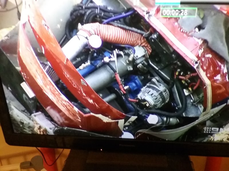

If thats the plane I think it is it had a Suzuki engine in it
The photos from channel 9 show the ‘suzuki’ to have 912 tappet covers...
I was speaking with him, as he was working on it, the other day in the hanger, The slats were on, and I thought he said it was a Subaru engine, but I may have mis-heard Suzuki. He's a top bloke, and a friendly face around the Coominya airfield.
