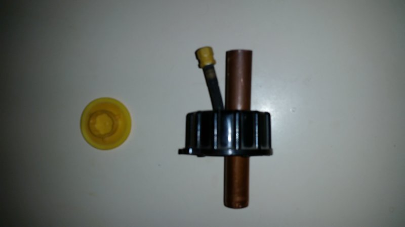

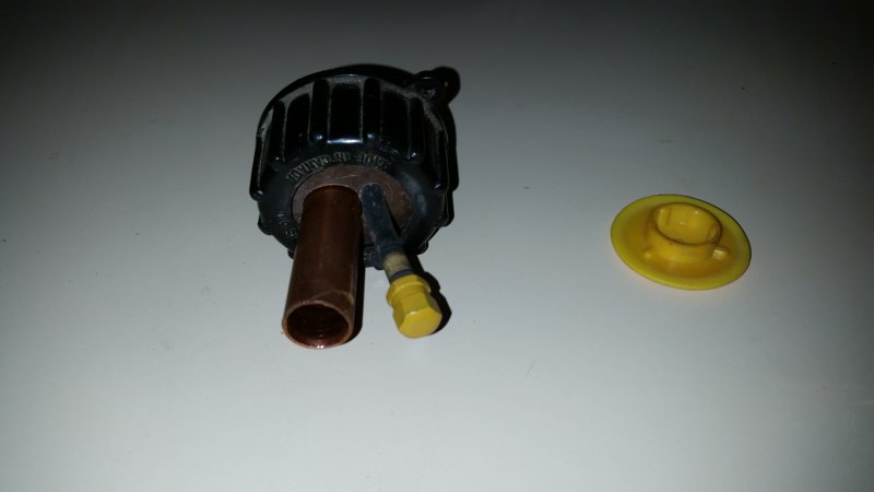

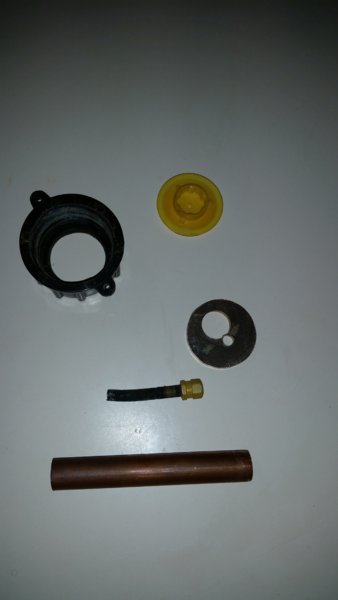

Blueadventures Posted August 19, 2018 Posted August 19, 2018 Keep me posted BlueA - my cap does not feature the yellow plastic removable disc (see above) but still may do something along the lines of what you are proposing - will require considerable cap engineering and at least two brass or ss disks (to act as clamps).. Hi Skippy Update. Tonight I finished fabing up the bits to make the cap insert piece (Length of 5/8" copper pipe, cut off bent valve from an old aircraft tube and the brass disc). Just need to clean up and braze or silver solder it the next few days. Then get some hose and give it a try. Cheers 2
skippydiesel Posted August 19, 2018 Author Posted August 19, 2018 Looking good BlueA - I await your test results with great interest.

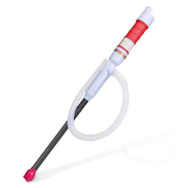

skippydiesel Posted October 1, 2018 Author Posted October 1, 2018 I use battery-powered (2 size D) pump to fill fire pumps, generators and my van with diesel fuel. About 3 minutes to pump 20l, fits in standard jerry can, rated for petrol/diesel/kerosene, $50 on ebay - search there "battery powered fuel transfer siphon pump", jrocproducts. Hi Antonts - Please correct me if I am wrong - I believe you are referring to a "powered " siphon. This wont pump fuel from the ground to a fill point significantly above the supply container (jerrycan). These gadgets are a questionable improvement on a simple tube in the hand of someone who knows how to use a siphon.
antonts Posted October 3, 2018 Posted October 3, 2018 no, it pumps upwards well. From ground to full length of hose (about 1m) at least, as I said I use them to fill fire pumps in our building - usual diesel with tank on top. This is small centrifugal pump sitting in the very bottom of can, all good, not a high pressure system but strong enough.
