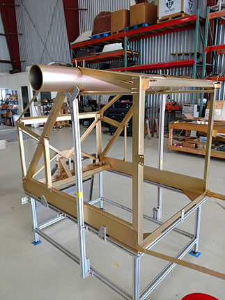

BD-4B
Thanks Mike,
I have spend an odd hour looking at the BD5 with a combination of admiration and fear. It amazed me the same designer produced pretty standard boxy looking high wing aircraft! I guess I passed them by as they appeared to me home built versions of commercial aircraft and to me home-building is about doing something you can't get. They are well priced (I checked) and have better performance that I would expect from the fuselage. Is that because it has a 160 hp motor hanging off the front?
You have convinced me to add one to my consideration given their safety record. Given many have been built for so long safety statistics are meaningful. Although unique special builds excite me, the first few 'test pilot' flights have extreme crash statics and you are the test dummy for every failure there-after. Many aircraft of type shares that risk around.
source: The famous BD-4 Kit Plane | Bedecorp
The fuselage looks solid around the pilot (with a big pipe to hit your head on 020_yes.gif.58d361886eb042a872e78a875908e414.gif). I will check it in detail, if I decide to go that way and one is available.
