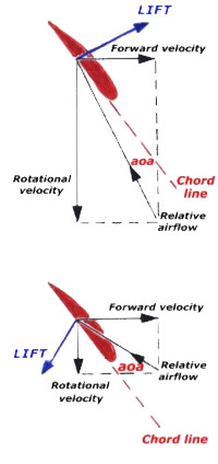

Jethro Belle Posted July 30, 2018 Author Posted July 30, 2018 Quote Regarding props windmilling or stationary, a wind milling prop if it spun freely would not cause much drag until the RPM's got right up and the tips went supersonic. Good morning Nev, I have been pondering and researching what actually happens in various engine out scenarios, and conclude your statement that at first seemed correct to me is in fact incorrect. I don't want to cause any flame wars like appear on other forums. Please correct my humble input if it is wrong. The following diagram indicates why a freewheeling (zero or very little resisting torque on the prop) would not reach sonic tip velocity. Note: In the drag creating condition shown at the bottom the propeller foil is generating lift inefficiently 'inverted', and would stall early. source:Drag from a windmilling vs stationary prop - Page 3 - FLYER Forums post The bottom diagram shows the negative lift (drag, hereafter denoted 'lift') condition of an auto-rotating propeller I referred to in my post #99. A supersonic tip velocity would be the top diagram and that would require power input. Thus a freewheeling propeller will actually auto-rotate slower than with power applied in excess to that required to overcome all mechanical friction (an idling engine may not provide excess power for a given airspeed, and posts indicating an idling engine on approach may actually contribute drag confirm this). As suggested in # 99 a freewheeling propeller will auto-rotate itself up to the optimal 'lift' speed (worst drag) and stay at that speed. To auto-rotate with 'lift' generating consequences requires the blade set at a small beta as the RecreationalFlying diagram shows. Feathered propellers or coarse pitch like boat propellers will not generate significant 'lift'. Quote If the prop is spinning and it is driving something that absorbs a lot of power (like a failed turbine) It has the ability to absorb multiples of the normal thrust figure because of the gearing and the torque of fast turning the dead engine and compressor as well as the ancillaries driven from the engine. For this reason turbo props pretty much universally have auto feather which acts almost instantly if the torque on the drive reduces. There is a sensor that triggers the auto-feather. but it's not active at low power settings. If what I state above is correct it is the lack of drag that a turbine creates (based on posts I read and not what I thought which inline with what Nev stated) that allows the propeller to spin up to its "barn door" drag rotational speed. It is the drag that is directly consuming most energy, not mechanical friction in the propulsion system. This friction only consumes the component of 'lift' at right angles to the the aerodynamic drag it generates, and if it is excessive it will actually reduce the propeller drag down towards locked propeller drag magnitude as the rotational speed is reduced. I think it is the belief that a freewheeling propeller spins up to ridiculously high speeds that muddies understanding. Also a Windmilling propeller is not the same as a freewheeling propeller. I found the Canadians to be well informed and less argumentative in their forum (than others, not this forum) Windmilling or non-feathered propellers in flight. - AVCANADA. The papers I have read tend to confuse the basic idea with complexity, but do not contradict it. I had read about turbo-prop pilots 'zeroing' their props to generate high drag. At zero beta the vector diagrams above don't hold (actually it would be the bottom one with the foil cord aligned with rotational direction and a high AoA). My understanding is that the turbines are still rotating the propellers. A zeroed prop would be fully stalled creating its stopped area drag, however the influence (the pressure field around a foil extends many cord lengths) is extended to the complete propeller disk area by rotating it at sufficiently high velocity. Since a auto-rotating foil operating inverted would have a coefficient of 'lift' little greater than one, the drag would be similar to that of an auto-rotating freewheeling propeller.
