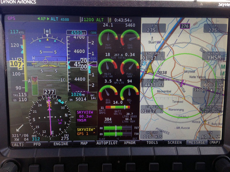

Your cruise speed intrigues me because Eurofox - Aeropro (and other sites) quotes 185 km/hr Maximum Speed (100 knots)! How are you achieving this speed? What altitude do you fly?! I am looking for 120 knot cruise (eg: even Jabiru J230-D. Cruise Speed: 120 kts can do this) which would require about 170 hp in your aircraft ignoring Vnc.
Jethro, my Eurofox is the Rotax 912ULS 100 hp. 3k model (trike) with smaller wheels & pants. It is available with variable pitch propeller, so that is how one gets that sort of TAS in the cruise - note photo where I am nudging it along a bit :-o
I find that the "sweet spot" cruise altitude is around 5500 ft. with the Rotax carbys. My POH states a Vne of 116 KTAS and with full flaperons deployed it slows down to a Vso of 39 KTAS for nice short-field ops (MTOW 560 kg.)
This 100 hp. version is used to tow gliders up to 750 Kg. At Tocumwal they use the Eurofox glider tugs with a taildragger configuration, with exposed balloon tyres for paddock recoveries. Naturally, that leads to a slower cruise TAS when not towing.
As for "local touring" from Melbourne, I've flown mine across to Tassie, up to Birdsville & over to William Creek, Lake Eyre etc. and I've been happy with all of this. The 2 axis Dynon Skyview autopilot helps with the longer legs. Even better, on return I stow my Eurofox with the wings folded back in a car trailer, so no home hangar fees!
